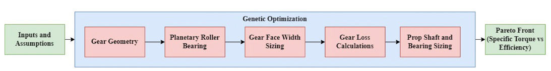

A flow diagram for the design tool is given in Figure 1. The following sections discuss each of the boxes in the flow diagram in order. The tool is presented in the context of a single or two-stage planetary gearbox.
Flow diagram for gearbox genetic optimization tool
Figure 1—Flow diagram for gearbox genetic optimization tool.

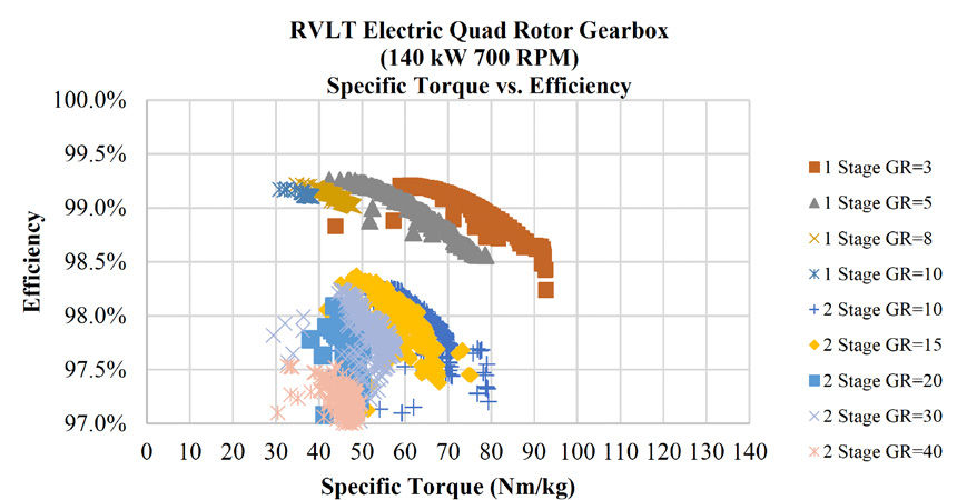

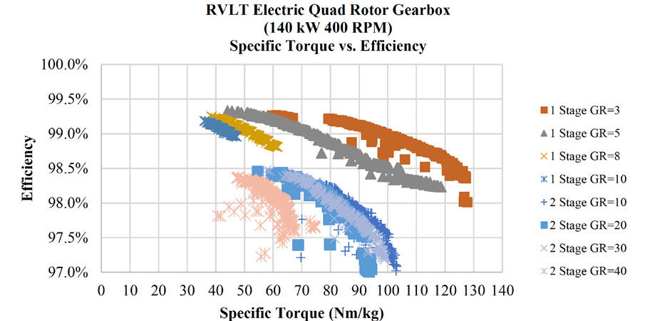

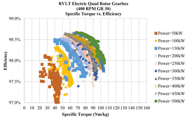

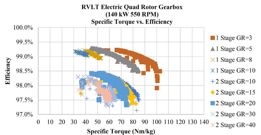

The code uses 3 genetic optimization variables for single-stage planetaries and 7 variables for two-stage planetaries. For each stage, sun gear tooth count, ring gear diameter, and number of planets are used as optimization variables. The seventh variable for the two-stage planetary is the gear ratio of the first stage. Other parameters like gear tooth pressure angle, listed as an assumption in Table 1, can also be used as genetic optimization variables if desired.

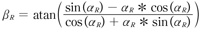

where αR is roll angle at radius R. The angular position of a gear tooth at a given radius is defined as
(23)
where βR is the angular position of the face of the gear tooth at radius R. The span angle of the gear tooth at the pitch radius Rp is calculated as

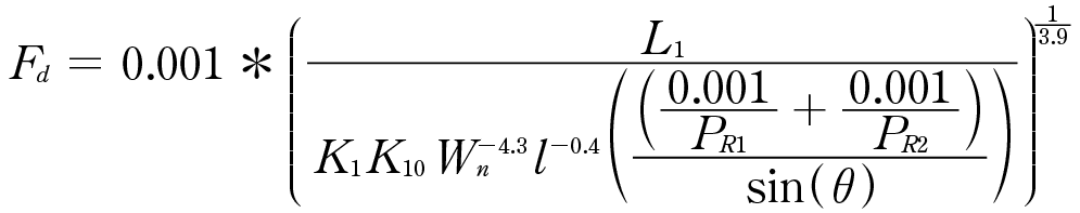

A third required face width calculation is also used based on the method described in Section 5.2 of Ref. 1.
(48)
where

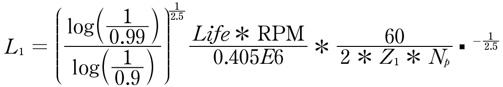

  • L1 is a constant defined
(49)
  • K1 is set to 1.6, assuming the gears are shot peened AISI 9310 per Table 7 of Ref. 1
  • K10 is a constant equal to 6.44E9 per Ref. 1

Gear face width, F, is defined as the max of Fb, Fc, and Fd. If the largest of these face width values is less than 5 mm, face width is set to 5 mm. 5 mm is selected as the minimum allowable face width so that the gear maintains out-of-plane stiffness and has reasonable face area to account for misalignment and 3D gear tooth features like tooth crowning.

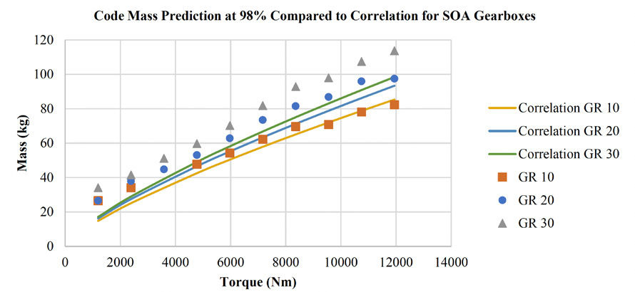

The mass of an external gear is estimated as
(54)
where Rimt is an input estimate of the required gear rim thickness to avoid distortion of the gears and Dsteel is the density of the steel used to make the drivetrain. 5 mm is used in this paper so that the gear rims have reasonable stiffness and can support centripetal loads. Integrating a more detailed and physics-based gear rim design is the target of future work.
The mass of an internal gear is defined as
(55)
For a planetary gear member, the mass of the roller bearings and an estimate of the carrier mass are included. Roller bearing mass is taken to be 66 percent of the mass listed in Ref. 9, assuming some portion of the inner and outer races of the bearings is integrated into the rim of the gear and the gear’s shaft. An estimate of planet carrier mass is also included
(56)
This planet carrier mass estimate only serves as a rough mass estimate that scales with the size of the gear set and number of planets. Adding a higher fidelity methodology for carrier mass estimate is a potential area of improvement for the code.

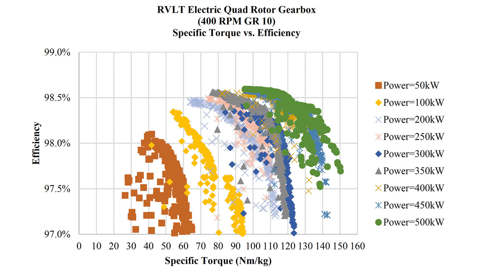

Gear Efficiency Calculations
With the gearset face width defined, windage, sliding, and rolling loss for each gear mesh are calculated using the method described in Ref. 12.

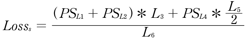

Sliding loss is defined as
(59)

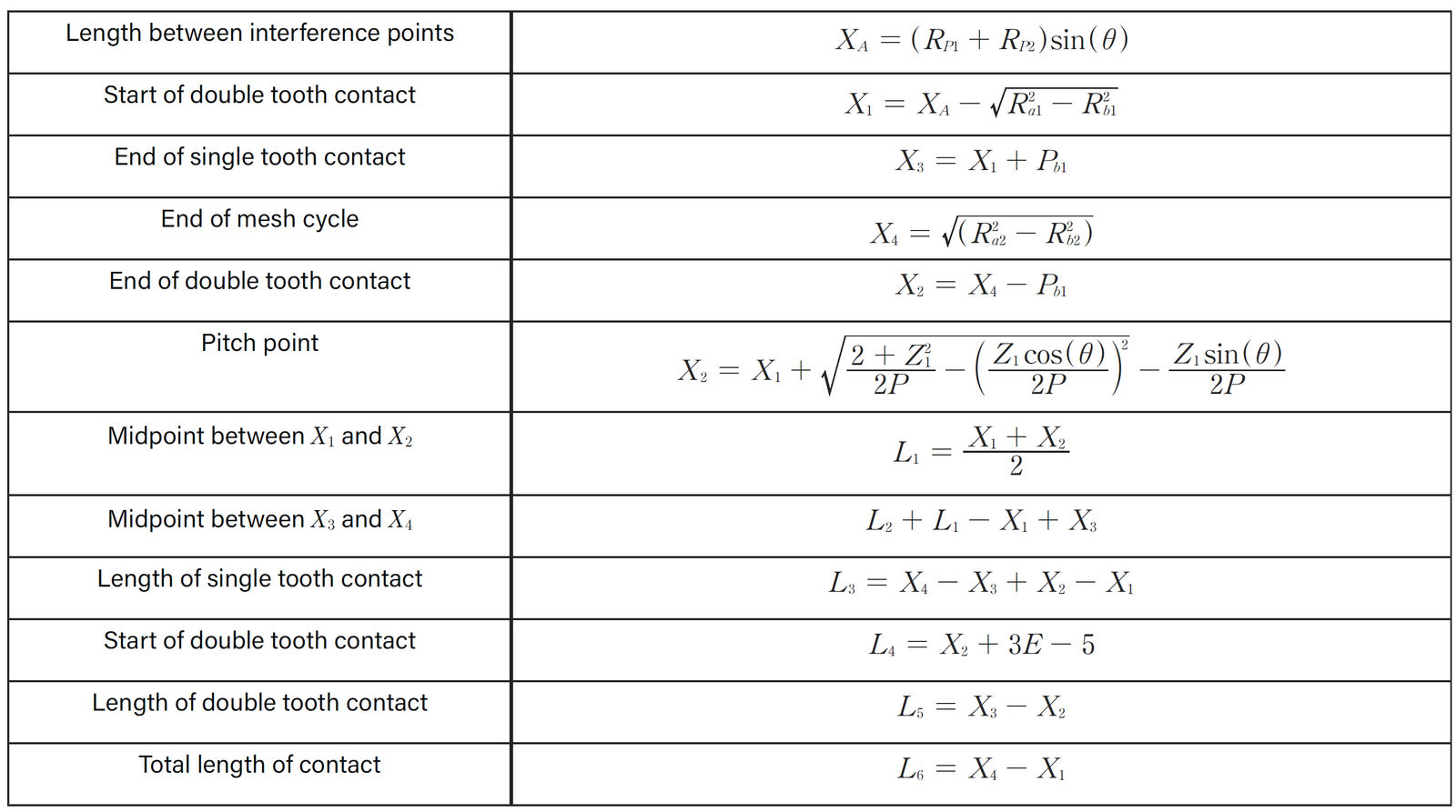

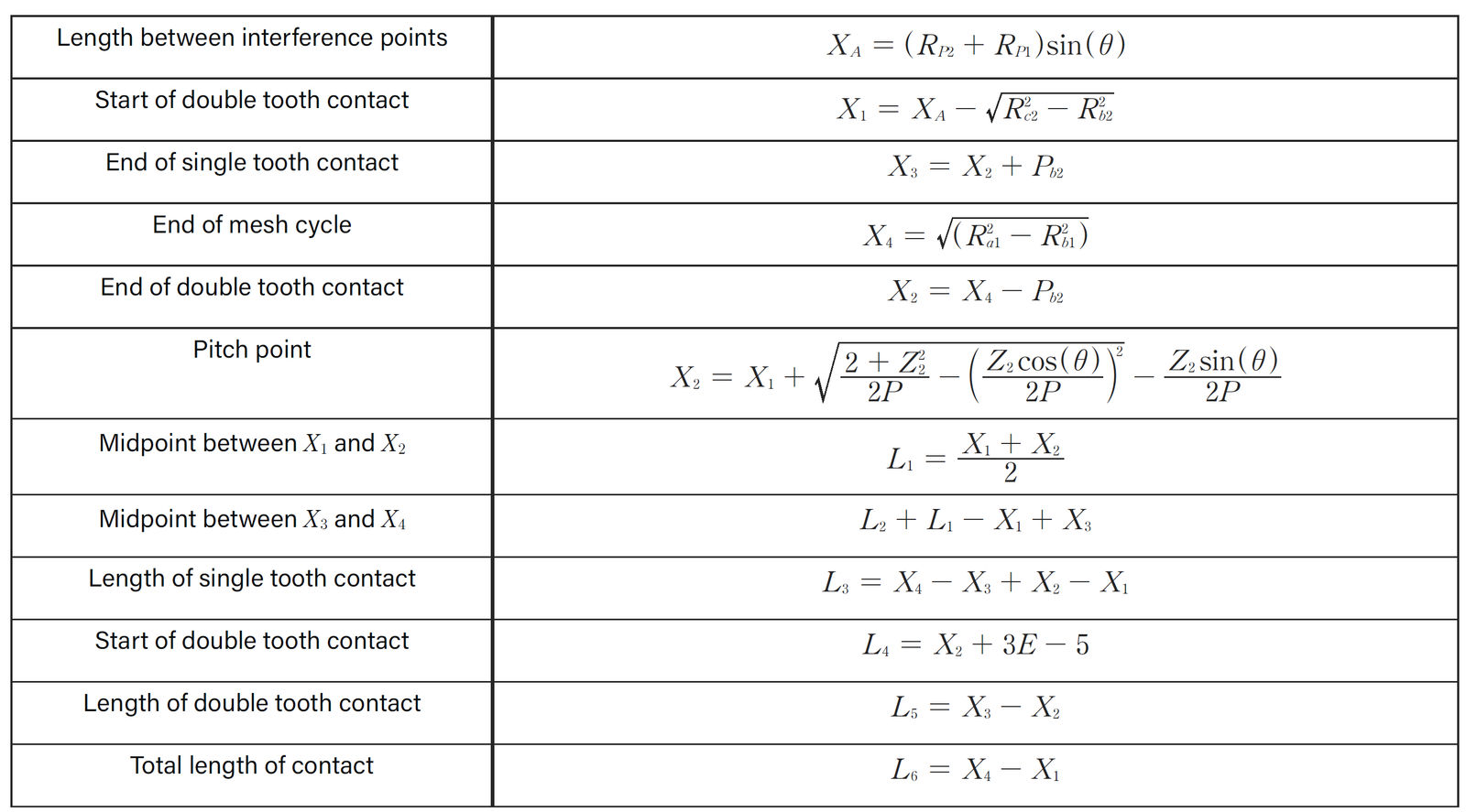

where PSL is the instantaneous sliding loss along the length L of the gear tooth contact. The lengths L are defined below in Table 2 for a pair of external gears and Table 3 for an external gear mating with an internal gear.
Table 2—Mesh lengths and positions for two external gears meshing.
Table 3—Mesh lengths and positions for an external and an internal gear meshing.
(60)

For a planetary gear set, total loss is calculated as the sum of the windage losses as well as the rolling and sliding losses from each gear tooth mesh.

Results for the first three studies (rotor and motor rotational speed sweeps) are given in Figure 3 to Figure 5.
Figure 3—Results of Study 1—Gear ratio sweep at 140 kW and 400 RPM propeller speed. Specific torque vs. efficiency.
Figure 4—Results of Study 2—Gear ratio sweep at 140 kW and 550 RPM propeller speed. Specific torque vs. efficiency.
Figure 5—Results of Study 3—Gear ratio sweep at 140 kW and 700 RPM propeller speed. Specific torque vs. efficiency.
In Figures 3–5, a clear trend of specific torque decreasing with increased gear ratio (increased motor speed) can be seen. Efficiency does not exhibit a significant trend with gear ratio, except for the difference between single and two-stage gearboxes. A drop off in efficiency occurs at gear ratio values around 40 for the 700 RPM case due to the very high RPM of the sun gear (28,000 RPM) in this case, as well as the relatively high overall ratio. Between the three plots at a given gear ratio, a reduction in gear-specific torque with increased propeller speed can be seen. This reduction corresponds to gearbox-specific torque decreasing with decreased torque, because despite the reduction in gear mass, the weight of the housing, shafts, and bearings does not reduce as significantly with reduced torque. This trend is illustrated more clearly for the results below from studies 4 to 6 with constant rotor speed and increasing power.
Figures 6–8 show the results of Studies 4–6 per Table 5. All of the results in these three studies were for two-stage planetary gearboxes. Gear ratios of 10, 20 and 30 were used, targeting a range of motor rotation speed from 4,000 to 12,000 RPM.
Figure 6—Results of Study 4—Power sweep at GR 10 and 400 RPM propeller speed. Specific torque vs. efficiency.
Figure 7—Results of Study 5—Power sweep at GR 20 and 400 RPM propeller speed. Specific torque vs. efficiency.
Figure 8—Results of Study 6—Power sweep at GR 30 and 400 RPM propeller speed. Specific torque vs. efficiency.
Figures 6–8 show clear trends for increasing gearbox-specific torque and efficiency with increased power/torque. As with Studies 1–3, comparing across plots, specific torque and efficiency are shown to drop with increased gear ratio.
Figure 9—Comparison of code results for Studies 4–6 at 98 percent efficiency to the curve fit to real gearbox data from Reference 14.
Figure 9 shows the trend of torque versus mass at a constant 98 percent efficiency from studies 4 to 6. Along with the data from the studies, the trendlines from Reference 14 for state-of-the-art gearbox mass versus torque, gear ratio, and output speed are shown. The trendlines are based on curve fits to actual aerospace gearboxes. The curve fit defines mass in pounds as
(73)
where HP is the power of the gearbox in horsepower.
In Figure 9, the masses predicted by the code presented in this report and the trendline from Reference 14 have reasonable agreement, suggesting that the code provides good estimates of gearbox mass. The greater mass predicted by the code is likely driven by the relatively low fidelity design of the housing in the code. The discrepancy growing with higher gear ratio likely results from using constant efficiency data from the code. It is unlikely that one would not trade some efficiency for lower mass in the design of an actual aerospace gearbox.
