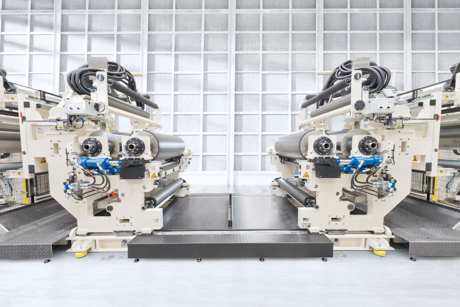

One such customized system, no less than six meters long and around four meters wide, coats a steel strip on both sides with a thin protective PET film. Harald Bartsch, head of design/expert advisor at Saueressig Engineering, described the machine's design concept:
“The complete laminating unit consists of two nearly identical, symmetrically arranged side frames, each with a rubberized laminating roller and a contact cooling roller. For laminating, the steel strip moves vertically between the two laminating rollers through the laminating unit at a conveying speed of up to 250 m/min. The laminating rollers press the film onto the hot steel strip from both sides.”
This article appeared in the March 2026 issue.
The steel strip's high temperatures of up to 260°C heat up the rubber coating on the laminating rollers. Water-cooled contact rollers dissipate this heat and limit the rubber coating’s temperature to a maximum of 90°C. Despite the cooling, the rubber linings of the laminating rollers are subject to wear and must be replaced regularly. “As the laminating process should ideally be running continuously all year round and 24/7 without interruption,” explained Bartsch, “the time required to replace the laminating rollers must be kept as short as possible. Therefore, the laminating unit is designed in such a way that the automated roller replacement only takes half an hour.”

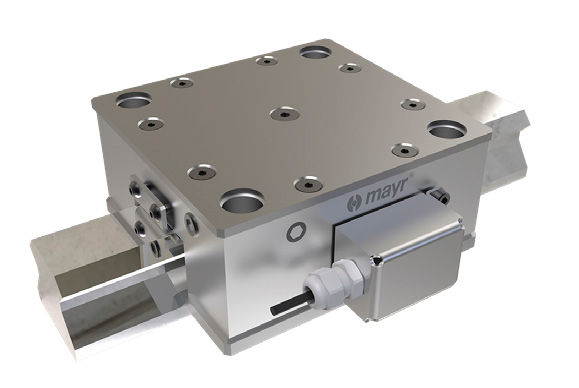

The laminating unit consists of two symmetrically arranged side frames. Both side frames are mounted onto profiled rail guides and can be separated axially to replace the worn laminating rollers. While the coating process is in progress, profiled rail brake of the ROBA Guidestop series by Mayr Power Transmission hold the two system parts in position backlash-free and with high rigidity. To replace the rollers, these safety brakes are released hydraulically, the two machine halves can be moved apart via rack and pinion gears, and the laminating rollers can be replaced.
Profiled rail brake of the ROBA Guidestop series by Mayr Power Transmission hold the two system parts of a large laminating unit in position backlash-free and with high rigidity.
The ROBA Guidestop profiled rail brake serves as a reliable safety brake and backlash-free clamping unit. It can brake movements safely and quickly and clamps the axes rigidly and backlash-free. Just like all safety brakes by Mayr Power Transmission, the profiled rail brakes also work according to the fail-safe principle. This means they are closed in de-energized conditions. The ROBA guidestop brakes use pre-tensioned cup springs to press the brake shoes against the 'waist' of the profiled rail, thus clamping it in place.
The hydraulic brake design used in the Saueressig laminating unit is released using a nominal pressure of 70 bar. This is comparatively low in relation to the very high holding forces. The brake mechanism is dimensioned for relatively large strokes. As a result, the brake can compensate for production tolerances on the profiled rails without losing braking force. The ROBA Guidestop safety brakes are equipped with two independent brake circuits: This allows for either double holding forces or a redundant design.
The profiled rail brakes are therefore directly mounted onto the masses which are to be braked or held. This minimizes the risk of hazards, particularly with gravity-loaded axles, as drive elements between the motor and the moving mass, such as spindles, spindle nuts, shaft couplings and gears, do not affect safety. This is different for concepts with motor brakes, as all drive elements must transmit the braking torque to the carriage. Furthermore, every element between the brake and the carriage has a negative effect on rigidity.
ROBA Guidestop safety brakes are therefore considerably more rigid than motor brakes, rod brakes or band brakes, which are often subject to backlash. ROBA Guidestop safety brakes by Mayr Power Transmission are available in pneumatic or electromagnetic versions in addition to the hydraulically opening design. The hydraulically releasing ROBA Guidestop series covers nominal holding forces from 5,000 to 34,000 N with four sizes. The pneumatically releasing version offers the greatest variety of options: Six sizes with nominal holding forces from 700 to 15,000 N are available in the standard product range. Both versions (i.e., pneumatically and hydraulically releasing) are available for all common linear guides. Electromagnetically opening rail brakes do not require any pneumatic or hydraulic equipment. Mayr Power Transmission develops this variant on request, customizing it for the respective application.
