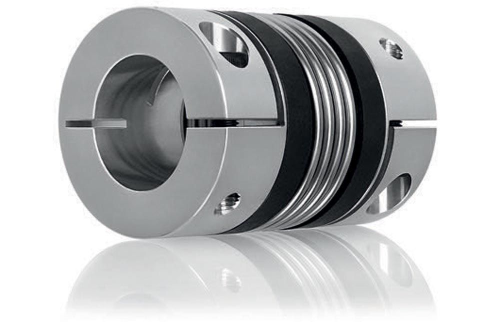

Option A: Bellows coupling
Torque capacity: 15 Nm
Torsional stiffness: 23,000 Nm/rad

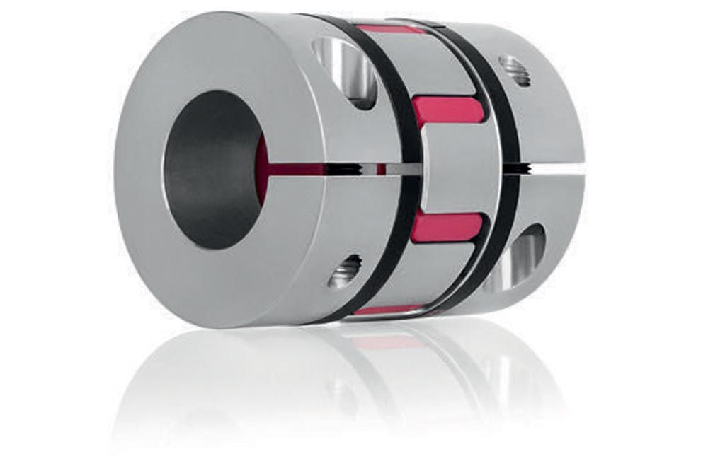

Option B: Elastomer coupling
Torque capacity: 21 Nm
Torsional stiffness: 2,300 Nm/rad
Going through a simple calculation for linear positioning error which is attributable to coupling wind up we see that both couplings hold up quite well.
Bellows coupling: 0.001 mm
Elastomer coupling: 0.010 mm
Naturally, the bellows coupling outperforms the elastomer coupling in the same 10:1 proportion as the difference in torsional stiffness. While there are many applications for ball screws that would require that the coupling contribute something as small as one micron (0.00004 in.) to linear position error, most everyday applications run very well with coupling wind up contributing the 0.010 mm caused by the elastomer coupling under full load, which is still less than half a thousandth of an inch. This is especially true when linear encoders are being used to control the final positioning of the load and prompt motors to adjust accordingly. As the ball screw lead increases, so too does the linear position error attributable to the coupling, but the rough order of magnitude stays the same. The elastomer coupling is most often the right choice except in cases of the most extreme of positional accuracy requirements.

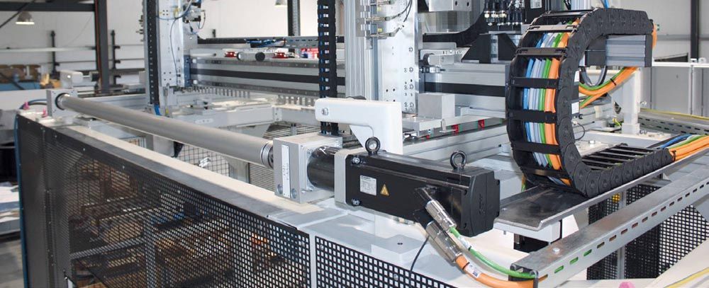

Belt-Driven Linear Modules
Used more for speed of material handling than for the high thrust and precision positioning of ball screw drives, belt-driven linear actuators might initially be considered to require relatively low torsional stiffness in the couplings that connect them to their driving components. The opposite is true in many cases. For the same reason that they are used for higher rates of travel and with less emphasis on thrust beyond acceleration, there is no mechanical advantage between the input shaft of the actuator and the resulting linear motion. This is also why precision gearboxes are almost always needed to assist the motor in producing sufficient acceleration torque and overcoming load inertia, whereas ball screw systems rarely need them. In these situations, the coupling sits at the business end of the drive line, rotating in a one-to-one ratio with the pulleys that create the linear motion. This also makes torsional wind-up much more conspicuous.
Vibration-damping couplings are normally the practical choice when driving the inputs of precision gearboxes.
In many cases, the base level X axis of a positioning system built on belt-driven linear actuators is also running in tandem with a second actuation module, which helps to support the moment loading created by the additional componentry and payload moving overhead. Instead of powering the second actuator with a separate motor, drive, and gearbox, it is usually much more economical to synchronize these X and X' axes mechanically with line shaft couplings. To keep the carriages of the two modules inline and prevent binding against their linear guides, it is important that they be synchronized throughout the motion profile.
One possible configuration involves center driving the two actuators with a motor and dual output gearbox mounted between them, and a line shaft coupling connecting each of the two gearbox output shafts to its respective actuator shaft. This minimizes the impact of torsional wind-up by, in theory, having equal wind-up between the two line shaft couplings, provided that they have the same overall length, and that the torque loading is approximately even between the two actuator carriages. But this method is not without its own challenges. Center driving the two modules requires that an additional framework be available for mounting the gearbox, which is often not there. It is also more costly than using a simpler gearbox on one end, where it can be supported by the frame of the actuator itself, and with a single line shaft coupling linking the two modules. Determining whether this easier method is feasible is often a matter of weighing the torque load on the line shaft coupling against its torsional stiffness and the resulting positioning error. Going slightly oversized with the line shaft coupling often helps to make this possible. It is also important to note that the X and X' actuators are linked at the carriages by their shared load, and together with their respective linear guides, assist in keeping everything moving together. But when coupling wind-up causes excessive drag in the driven actuator, the ability of the linear bearings to carry along smoothly is lessened. A good rule of thumb is typically to keep this would be position error under 0.2 mm.
Considering another common set of parameters for a gantry style system with 1.5 m between modules and a drive pulley radius of 50 mm, wind-up and positioning error between bellows and elastomer couplings might look like something like this:
