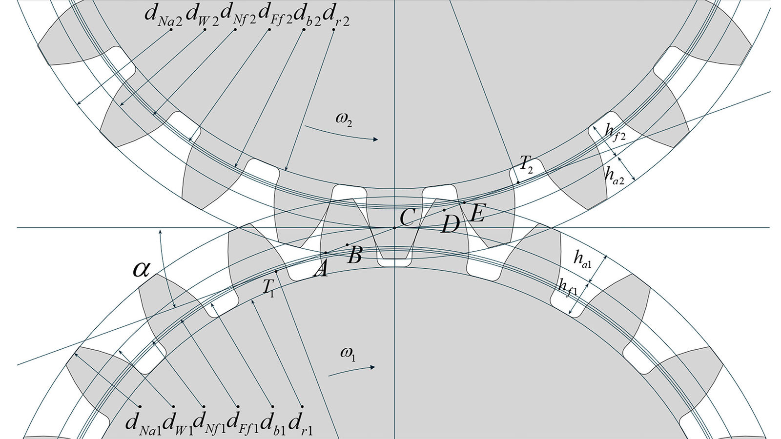

According to ISO 21771 (Ref. 18), each involute spur gear is defined by its module, which represents one of the most essential parameters in gears. The tip and root diameters determine the shape of the involute tooth profile, hence the addendum and dedendum factors. Furthermore, the design pressure angle and the value of the manufacturing shift coefficient also influence the tooth profile.
With the rise of electric vehicles, gearbox compactness has become increasingly important. Consequently, in the discussed algorithm implementation, the pitch diameters were selected as design variables to address spatial constraints explicitly and to facilitate the definition of domain boundaries. Thus, to uniquely determine the module for each gear stage, whether composed of two gears or including idlers, the number of teeth and the pitch diameter are specified for at least one gear per stage, especially where specific dimensional requirements are present.
Moreover, to better accommodate dimensional constraints, instead of directly specifying internal gear ratios or the number of teeth for each gear, a variable is introduced representing the sum of the nominal center distances of the gearbox stages. By specifying the total gear ratio as part of the design input, this approach enables the algorithm to derive the key geometric and kinematic parameters for the remaining gears in the assembly, ensuring consistency with overall layout requirements.
Finally, for each gear, the pressure angles, profile factors, shift coefficients, and face widths are defined as design variables. Each of these design variables is subject to specific boundaries, which are established by design constraints or informed by the designer's expertise. A comprehensive list of all design variables considered is provided in the accompanying Table 1.

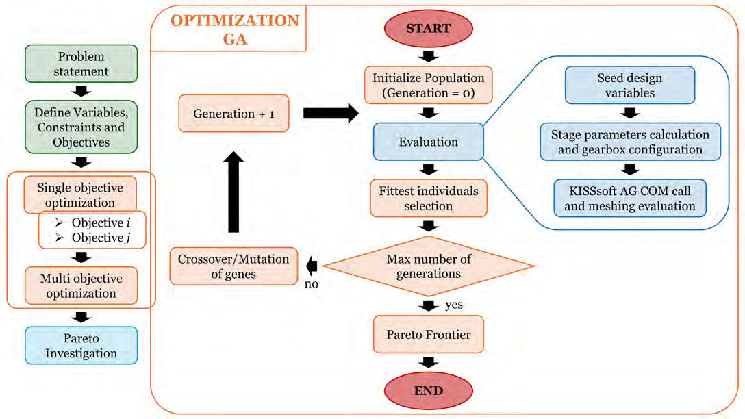

Optimization Process
After defining the problem, i.e., the design variables and their boundaries, the constraints, and the objective functions to be maximized or minimized, the optimization phase is carried out. The NSGA-II (Ref. 10) genetic algorithm was selected due to its efficient non-dominated sorting capabilities and its ability to populate the Pareto front uniformly. The Pareto front represents the set of optimal trade-off solutions in which no objective can be improved without degrading at least one other; in this context, it allows a direct comparison of different design alternatives balancing efficiency and weight. For each of the selected objective functions, it is good practice to perform separate single-objective optimizations in order to understand the evolution of the design solutions and assess the algorithm's performance with respect to the chosen design space and constraints. Subsequently, multi-objective optimization is performed to determine the Pareto front of non-dominated designs. In all cases, the optimization process follows the algorithm illustrated in Figure 2.
Figure 2—Optimized design procedure.
The process begins with an initial population generated using the Uniform Latin Hypercube (ULH) sampling method, which ensures a well-distributed set of design seeds. This method promotes uniform coverage of the design space, minimizes induced correlation among design variables, and maximizes the distance between sampled points. In the evaluation phase, each individual design is assessed by computing the values of the objective functions and constraint-related parameters. Once the entire population has been evaluated, the algorithm ranks the solutions based on objective values and constraint satisfaction. Specifically, feasible solutions are ranked according to Pareto dominance; feasible designs are always prioritized over unfeasible ones, and unfeasible solutions are ordered based on the number of violated constraints, with those violating fewer constraints ranked higher. Suppose the current generation count is less than the predefined maximum. In that case, parent designs are selected and used to create the remaining individuals of the new population by applying crossover and mutation of parents’ genes according to predefined probabilities. At the end of this heuristic process, a total of N populations times M individuals will have been evaluated. Considering only feasible designs, the process yields either the Pareto front (in the multi-objective case) or the single optimal individual (in the single-objective case). For the geartrain design process considered in this work, the evaluation process consists of several steps implemented in Python, utilizing the KISSsoft COM interface. Starting from the design variables described in the section “Multi-Stage Gearbox Transmission System and Design Variables” and listed in the corresponding Table 3, the total transmission ratio, the pitch diameter, and the number of teeth of one gear per stage level, and the sum of nominal center distances are used to determine the gear modules and the number of teeth on the intermediate gears. By including the profile shift coefficients, the actual operating center distances for each stage are computed, allowing the whole layout of the transmission to be determined, given the fixed positions of the input and output shafts. In the case of the idler gear, its module and pressure angle are inherited from the mating gears, while its number of teeth is determined by the selected module and the center distances imposed by the layout. The feasible design range is thus defined by the spatial constraints set for the gearbox and the meshing conditions with both adjacent gears, while the remaining design parameters (e.g., profile factors) and constraints are selected within the same boundaries defined for all gears in the geartrain. To reduce computational cost, the layout calculation employs Erone’s formula, which enables the determination of a triangle’s area based solely on the lengths of its three sides. This allows for positioning all gears in the geartrain and, if requested, verifying that their centers fall within the specified spatial constraints. The operating center distances and all geometric parameters are then passed through the COM interface to KISSsoft, where root radii are computed, tolerances are applied, and all gear meshes in the transmission are analyzed under the specified input power and rotational speed. In particular, sliding power losses (evaluated as described in the “Design Objective Functions” section), safety factors, and meshing consistency are computed to assess the feasibility of the design. Finally, considering the established bore radius of each gear body, the volume and resulting mass of all gears in the transmission are calculated. Windage losses are estimated using the model proposed by Anderson and Lowenthal, and the total transmission efficiency is then obtained.

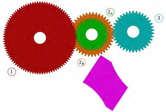

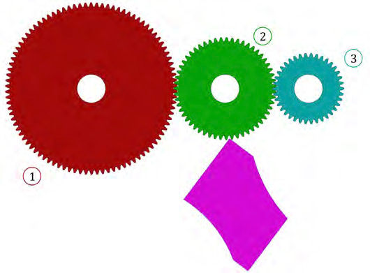

The methodology discussed in the previous chapters was applied to a case study based on a two-stage transmission layout previously presented in the literature (Refs. 20, 21), configured with an idler gear and gears’ tooth numbers of 94-55-38, as well as operating pressure angles of 21.22 degrees and 21.02 degrees. The corresponding baseline compound configuration was defined by maintaining the same overall transmission ratio and keeping the positions of the input and output shafts unchanged. Figure 3 illustrates both baseline configurations, distinguishing the idler geartrain case from the equivalent compound layout. In fuchsia, the required domain for the intermediate gear center is shown. Starting from the initial layouts, the total gear ratio of the two-stage transmission was computed, along with the positions of the input and output gears. As previously described, these three quantities are treated as fixed parameters in the optimization process to identify the gear set's optimal layout and macro-geometry. The optimization process considers an operating condition characterized by a power input, Pin, and a rotational speed at the input shaft, n1.
Figure 3—Baseline geartrain designs. On the top, the architecture with idler gears; on the bottom, the architecture with the compound shaft.

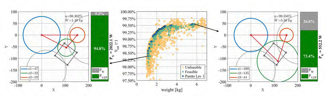

The results of the multi-objective optimizations for the two configurations are presented in Figure 4 and Figure 5, for the idler gear configuration and the compound gear configuration, respectively. The central scatter plots in each figure display the evaluated designs in the total transmission efficiency versus weight space. In these plots, feasible solutions, thus those that do not violate any constraints, are highlighted in green, while unfeasible ones are shown in orange. Additionally, non-dominated solutions forming the first Pareto fronts are highlighted in blue and red, respectively. Across the entire optimization process, approximately 64 percent of the evaluated candidates were discarded because they had violated at least one manufacturing/design constraint. Considering individual constraints, tooth interference reserve was violated in 29 percent of the designs, insufficient clearance in 27 percent, minimum tooth tip thickness in 39 percent, and minimum contact ratio in 25 percent. These violation rates, being of relevant magnitude, highlight the importance of considering these constraints, as each has a significant impact on shaping and characterizing the feasible design space throughout the optimization process. In both figures, the designs with the highest efficiency are depicted on the right side of the scatter plots, while those with the lowest weight are presented on the left. These correspond to, or closely approximate, the results obtained from the single-objective optimizations aimed at individually maximizing or minimizing the two objectives. In addition to the three or four gears constituting the transmission, the figures depict, in red, the center distances between meshing gears and, in gray, the feasible region where the trace of the intermediate shaft axis must be located. The solid gray line defines the boundary within which this axis must reside. In contrast, the dashed gray lines represent the regions from which the axis must be excluded, in this case, two limiting circles. Considering both the designs of Figures 4 and 5 while also taking into account the trends of Figures 6 and 7, it is evident in both cases that, in order to reduce power losses due to sliding and thereby improve efficiency, the optimization algorithm tends to evolve toward solutions featuring a high number of teeth (see legends) and low modules. However, such evolution requires higher pressure angles and wider face widths to ensure adequate strength. These solutions, which are shown on the right side of each figure, are generally less compact and significantly heavier due to larger pitch diameters and gear widths. Conversely, the low-weight configurations are characterized by taller teeth, i.e., a higher module. This allows for stronger teeth, enabling narrower face widths and hence reduced diameters and overall transmission weight.
Figure 4—Results of the simple geartrain (idler).

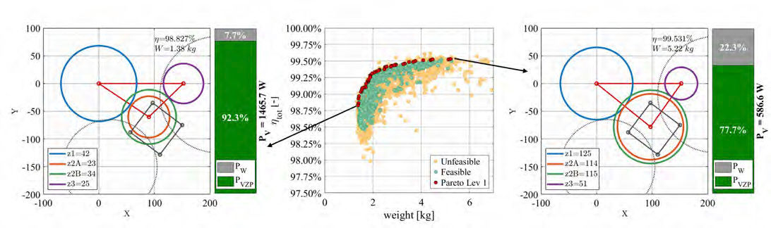

Figure 5—Results of the compound geartrain.

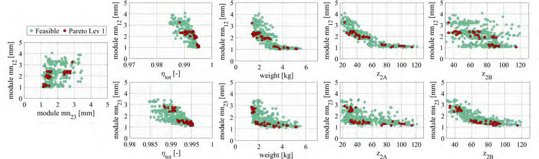

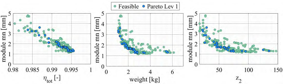

Comparing the results in Figure 4 and Figure 5, it can be observed that, under identical boundary conditions, the algorithm applied to the four-gear compound configuration can more uniformly and effectively populate the Pareto front. In contrast, the optimization applied to the idler gear configuration struggles to develop a well-defined front. This effect is partly due to the higher constraint violation rate in the idler case (77.62 percent of generated designs), primarily caused by simultaneous meshing conditions that increase interference reserve and clearance conflicts. Consequently, under the same number of evaluations, the algorithm finds it more challenging to generate feasible solutions. Finally, comparing the solutions presented on the Pareto front, both configurations exhibit similar efficiency levels. The constraints established in the case study enable idler gear solutions to achieve sliding power losses that are comparable to those of the compound configuration, despite requiring more in-plane space. Conversely, the compound configuration requires out-of-plane space and incorporates gear 2B, which results in an increase in windage power loss, aligning it with the idler configuration. Both figures reveal that windage loss along the Pareto front increases its ratio between approximately 5 percent and nearly 30 percent for both configurations. On the other hand, considering the weight objective, the idler configuration benefits from the absence of additional gears, rendering it lighter. However, the difference is not significant because the design flexibility of the compound configuration allows for the use of smaller gear diameters.
Figure 6—Simple geartrain (idler): correlation between module, idler number of teeth, efficiency, and weight for the feasible designs.
Figure 7—Simple geartrain (idler): correlation between stage modules, compound gears number of teeth, efficiency, and weight for the feasible designs.
