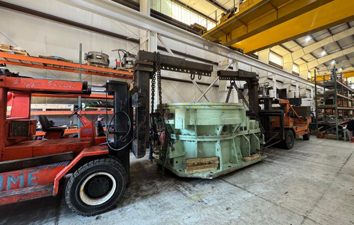

Atlanta Gear Works brought in a rigger with two 100,000-pound capacity forklifts to remove the gearbox from the trailer (all photos courtesy of Atlanta Gear Works).

At the outset, the biggest challenge was the weight of the gearbox. It was the heaviest one Atlanta Gear had ever worked on and required flexibility in the shop.
“We have a 50-ton overhead crane on rails in our main assembly building, but we could only lift individual components for this job,” Sims said. “Getting the gearbox to the shop, off the trailer and into the building was a pretty big undertaking.”
This article appeared in the March 2026 issue.
Atlanta Gear Works needed special permitting and custom trucks and trailers just to get the gearbox to the shop. Even with the company’s high-capacity cranes and forklifts, they could not lift the entire 145,000-pound gearbox off the trailer.
“We brought in a rigger with two 100,000-pound capacity forklifts to remove it from the trailer and into the building. Once the gearbox was inside the building, our equipment was able to move it piece by piece,” Sims said.
