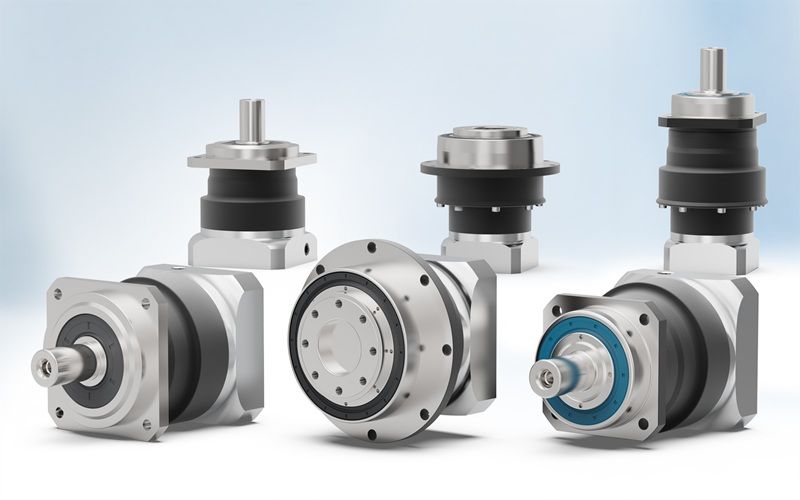

Neugart is introducing a new performance class above its existing precision gearboxes with the new PSNpro, PSFNpro and PSBNpro series. These are based on new, innovative gear technologies and the use of new materials in production. The optimized tooth flank quality reduces point load peaks and enables higher torques to be transmitted with the same service life.
The PSNpro, PSFNpro, and PSBNpro series set new standards in dynamic applications. In particular, cycle torque has increased significantly, enabling the pro series to rival and even surpass spur gearboxes. This series is suitable for applications involving frequent changes in load and direction.
Pro gearboxes utilize the advantages of helical teeth to achieve excellent synchronization. Transmission fluctuations between the input and output remain extremely low throughout the rotation of the output shaft. This visibly improves process quality and minimizes chatter marks in woodworking machines, for example. At the same time, the gearboxes operate at a particularly low noise level, even under high loads. This improves the system's acoustic properties and stabilizes the machine's overall performance.
Another area of development focused on reducing mass inertia, particularly in small frame sizes. Thanks to the consistent implementation of the modular principle, the input stage is now from frame size 064 smaller than the output stage. This reduces the rotating mass, enabling faster acceleration and braking processes, as well as improving control quality in highly dynamic axes.
Neugart offers the usual gear ratios, sizes, and options for the pro series – even a factory-mounted pinion on the output shaft, ideal for pinion-rack drives, is included as standard.
