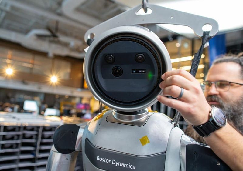

Boston Dynamics recently announced a new partnership with LG Innotek, the South Korean materials and electronic components manufacturing company. This strategic alignment will enable Boston Dynamics to install LG Innotek’s new vision sensing components into Atlas, Boston Dynamics’ humanoid robot (pictured top).
The collaboration brings together Boston Dynamics’ and LG Innotek’s research teams to develop new vision sensing systems to address some of robotics hardest to solve problems. The new vision sensing solution will integrate various sensing components and allow robots to detect and perceive their surroundings, including during times of low visibility or poor weather conditions, and in dark environments.
“We’re excited to partner with LG Innotek to drive innovation and redefine the development of robot eyes,” said Robert Playter, CEO of Boston Dynamics. “Robots should be able to see, process and perceive the world as well as humans. It is my hope that by working together, we will develop groundbreaking vision systems that are as advanced as the cameras in our mobile phones.”
CEO Moon Hyuksoo of LG Innotek said, “By collaborating with Boston Dynamics, a world leader in robotics, LG Innotek will gain an advantage in the robotics components market.” He added, “We will continue to introduce core components for robots that will set the standard in the era of robotics and secure a leading position for us in the market.”
The new partnership with LG Innotek comes on the heels of other research collaborations with organizations including Toyota Research Institute, Google Deepmind, NVIDIA and Boston Dynamics’ sister organization, RAI, all to move the robotics industry forward and to develop the world’s most advanced robots.

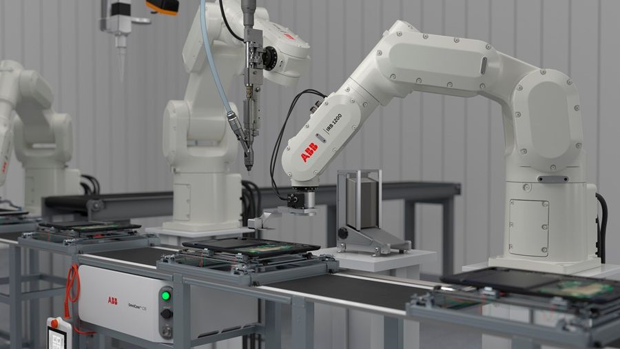

ABB Robotics’ IRB 1200 high performance small robot family is evolving into a new generation that is faster and more precise, improving productivity and efficiency for a wide range of applications.
“With rising demand from SMEs, the need for adaptable and efficient small automation solutions has never been greater,” said Marc Segura, president ABB Robotics. “The new IRB 1200 takes efficiency and productivity even further in the most precise automation tasks.”
The new generation IRB 1200 family comes in four variants — 5, 7, 8, and 9 kg — the latter offering best-in-class payload, making it ideal for handling larger or heavier parts.
Powered by ABB’s OmniCore controller, the new robots achieve class-leading motion control, with path accuracy to just 0.6 mm and pose repeatability down to 0.011 mm, even for multiple robots at high speeds of up to 1,600 mm/s.
A five percent faster cycle time ensures that the new IRB 1200 family delivers this precision with even greater productivity, making it ideal for high throughput, complex applications such as surface finishing, assembly, and dispensing, designed for electronics, general industries, automotive electronics, and consumer industries.
Through its leaner design, the new IRB 1200 enables more compact and efficient installation, boosting throughput and efficiency without increasing production footprint. At the same time, it is 20 percent lighter than the previous generation, reducing pedestal mounting and energy consumption.
Thanks to OmniCore, the new generation IRB 1200 family also offers ease of use, through full access to ABB’s expanding suite of AI-powered software, such as RobotStudio, RobotStudio AI Assistant, and AppStudio.
