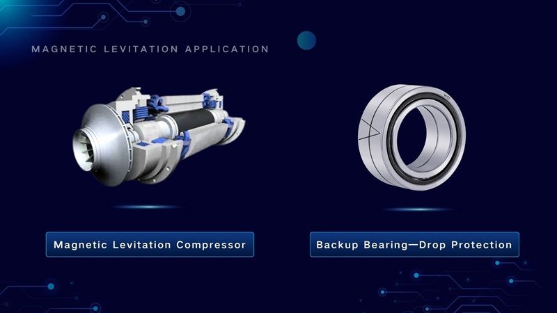

When the backup bearing in a magnetic levitation compressor system can withstand fewer than 50 drop events — the real risk is only beginning.
Under normal operation, a backup bearing is almost invisible. But when rotor instability occurs, it must absorb sudden high-speed impact instantly. Otherwise, the consequence is not just bearing damage, but potential system failure, factory return, and significant operating cost.
One of WD's compressor OEM partners initially used deep groove ball bearings (DGBB) for this application. Performance was stable under standard conditions. However, under extreme rotational speeds combined with impact loads, limitations became clear including insufficient stiffness, cage strength concerns and high-speed stability.
Drop protection capability was limited to fewer than 50 events. Once that threshold was exceeded, failure risk increased, along with downtime and maintenance costs.
Together with the customer, WD reassessed the true reliability boundary of the application. The objective was not simply functionality — but sustained stability under extreme conditions.
Through in-depth analysis of high-speed dynamics and impact loading, WD developed a high-precision Angular Contact Ball Bearing solution: internal structure, cage reinforcement, and high-speed performance were systematically optimized. The result was an increase in drop protection capability from fewer than 50 events to over 500.
This not only reduced maintenance frequency and service costs but also established a significantly higher safety margin for the entire compressor system. More importantly, the customer transformed “high-reliability drop protection” into a core product differentiator — accelerating market adoption and driving order growth.
