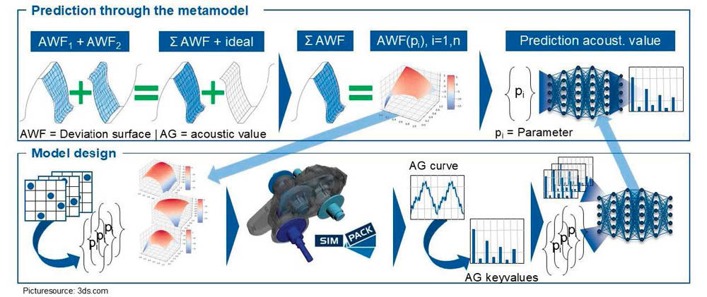

In the context of measures such as the increase of resource efficiency as well as due to increasing demands of the end customers, the pressure on gearbox manufacturers to produce fewer rejects and at the same time to meet higher demands on the quality of the gearboxes is growing. To ensure that an assembled gearbox meets the acoustic requirements, tests are therefore carried out on the fully assembled units in end-of-line (EoL) tests (Ref. 2). If an anomaly is detected, the unit must be disassembled and overhauled as far as necessary or otherwise scrapped. It would be a significant advantage if assemblies, that are relevant for the acoustic behavior, such as the tooth meshes, could already be examined for their excitation behavior before assembling them.
Theoretically, this would be possible by simulating the acoustic behavior of the gearbox in a dynamics model, as it is currently used in the gear design process, using the real topographies of the gears to be installed. However, the main problem here is the calculation time of these dynamics models, which prevents a calculation parallel to the manufacturing process time.
To solve this challenge, a way must be found to predict the excitation behavior of the system much faster. One approach that is to be investigated for this purpose is the usage of metamodels, which allow a considerably faster calculation of the target variables. It is relevant here that a description of the tooth flanks is used, that is as exact as possible to be able to determine a realistic assessment of the excitation behavior that arises from the two wheels in the tooth mesh.
Willecke et al. (Ref. 3) have already shown that it is possible to use a substitute model for the quasistatic description of the problem. The approach developed there offers the potential to be used for dynamic calculations as well.

Objective and Approach
The objective is to determine the characteristic values of the differential acceleration of a deviation-affected gear pair orders of magnitude faster than is possible with a conventional elastic multibody simulation model (EMBS) under load. Therefore, a DNN is developed that approximates the EMKS and achieves this time advantage. The method to be developed for calculating the characteristic values of the transmission error (TE) with this model is shown in Figure 2. It is assumed that each of the two gears is provided with a deviation. In the first step, these two deviation surfaces (AWF) of gear 1 and gear 2 are combined to a sum deviation surface (∑ AWF). Thus, an equivalent tooth contact is created in which only one gear has deviations, and the other gear has an ideal involute. In the second step, the parameter pi is derived from the ∑ AWF. These parameters should be able to describe the ∑ AWF as accurately as possible with as small of a number of control points as possible. In the third step, the parameter pi is given as input to the model, which then returns the TE characteristics.
Corresponding to the individual steps of the method for calculating the TE characteristic values for two gears with deviations, the procedure for achieving this goal can also be divided into several sub-steps. In the first substep, the ∑ AWF must be set up. For this purpose, the already developed procedure according to Willecke et al. based on the approach of Brimmers can be used (Refs. 3, 7).
In a third substep, the actual DNN for calculation is developed. For this purpose, a training data set with n = 3,000 data points is created. First, a pool of variants is generated. These are not combined fully factorially but distributed with the help of a Latin hypercube experimental design so that fewer variants are needed to cover the complete variation space. An EMBS calculation under load is performed with each variant of this variant pool. The acoustic parameters are then calculated for the differential accelerations calculated in this way. For each calculated variant of the pool, not only the parameters pi as input of the model are known, but also the acoustic parameters as output of the model. With the help of the data set created in this way, the DNN can be trained. A dataset created in analog with n = 480 data points, which are explicitly not part of the training dataset, is used to validate the created network.
Subsequently, it will be investigated how well the trained DNN is suited to predict data outside the trained range and how sensitive the network reacts to a reduction in the size of the training dataset. The GAN represents one way in which the dataset could be extended and refined for this purpose. The extent to which GANs can be used to selectively increase the size of the dataset for training is being investigated. The goal is to generate additional realistic training data.

Development of the Surrogate Model to Predict the Acoustic Characteristic Values
This chapter explains how the neural network is built. For this purpose, it is first described how the necessary data sets, which are later used for the generation and validation of the network, are generated. Furthermore, it is explained how the hyperparameters for the design of the network are selected. Subsequently, the validation of the prediction of the neural network is performed. For this purpose, the ability of the neural network to make predictions about previously unknown data is evaluated.
Variant Calculation with the Dynamic Model to Generate the Training and Test Dataset
The creation of the neural network, which is used as a surrogate model for the prediction of the acoustic parameters, requires a training data set. In addition, a test dataset is needed later for the validation of the prediction quality. Both data sets consist of different variants of topographic deviations. It should be noted that the variants of the test dataset are not part of the training dataset. The topographies are generated by free spline surfaces with Nz x Ns = 3 x 8 grid points out of analytical surfaces (Ref. 3). The procedure, see Figure 7 middle frame, is described by Willecke et al. (Ref. 3). To obtain freeform topographies as realistic as possible, they are generated from a superposition of standardized modifications (Ref. 3). According to Willecke et al. (Ref. 3), the range of these modifications is shown in Figure 7 on the left side.
