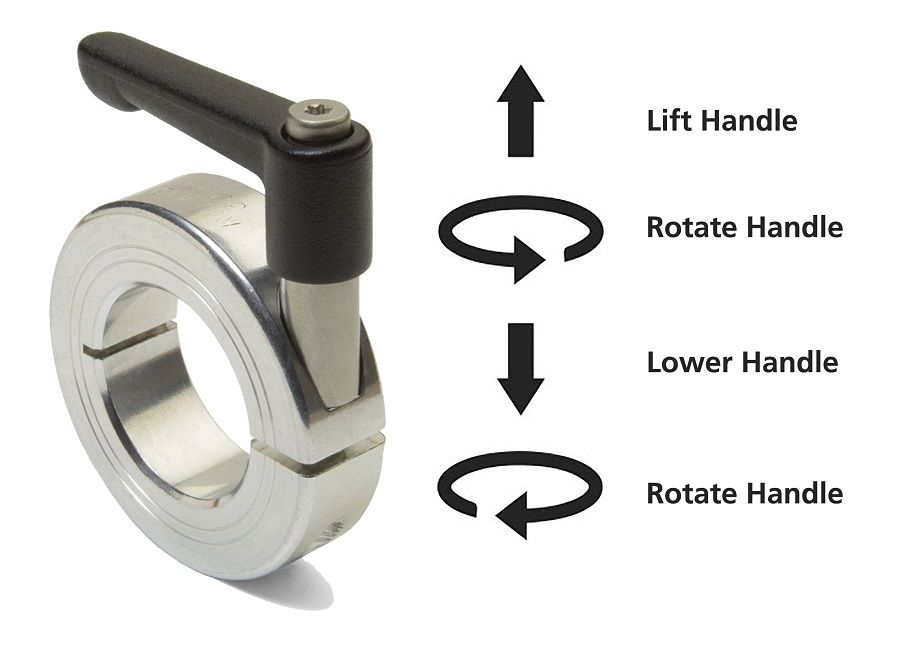

Quick clamping shaft collars with clamping lever combine a standard Ruland shaft collar with a custom designed lever designed to replace collar hardware. This creates a toolless shaft collar that can be rapidly adjusted, making them an ideal fit for packaging, printing, and other applications where frequent setup changes and adjustments are needed. The handle is steel with a textured zinc plated finish, allowing the user to easily grip the handle regardless of lubricants or other contaminants that may be on their hands. The stud is made from stainless steel to allow for increased corrosion resistance when combined with the zinc handle.
