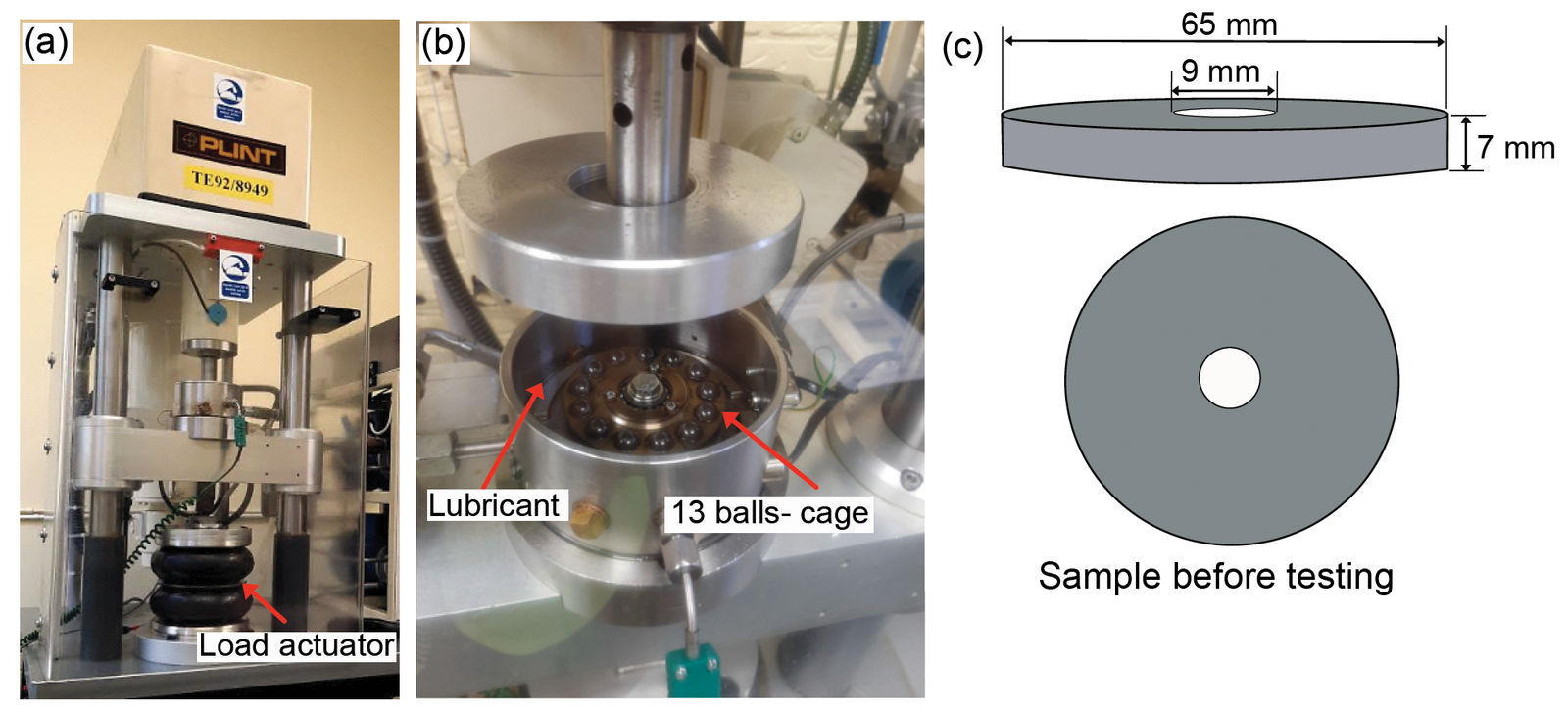

The disc-shaped samples had outer and inner diameters of 65 and 9 mm, respectively, and a thickness of 7 mm, the sample geometry is shown in Figure 1(c). Final preparation before RCF testing included grinding and polishing of the surface to ensure a smooth and consistent surface finish.
Figure 1—RCF test setup.
The RCF tests were carried out in a flat washer test rig, which is a microprocessor-controlled rotatory tribometer. This has 13 silicon nitride balls in a cup that is the outer race of a bearing. SAE 5W-40 oil was used as the lubricant, with the temperature set at 100°C. A summary of the test conditions is given in Table 2.

The test conditions and surface finish of the specimen and balls resulted in an elastohydrodynamic film thickness ratio of hmin = 0.053 and λ = 2.6, as calculated through the Hamrock & Dowson method. A single circular contact track was formed on the sample’s surface during testing over 1.0 × 108 stress cycles.

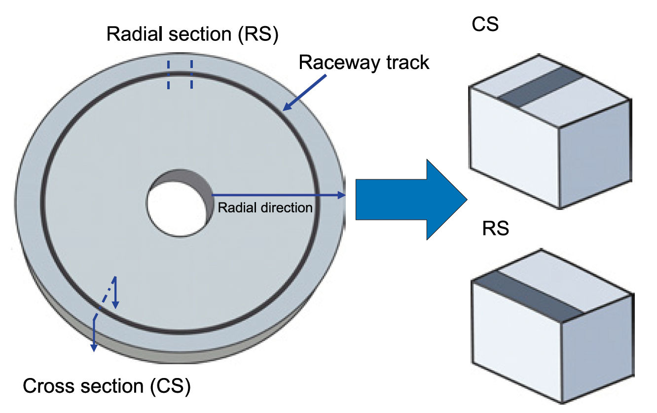

Following the RCF test, samples were extracted from areas both parallel (circumferential-section) and transverse (radial-section) to the rolling direction (see Figure 2). The samples were ground and polished in preparation for microscopic inspection. For the circumferential-section care was taken to polish until the center of the microstructural decay region was reached. For both materials, the virgin microstructure and the microstructural decay were examined using scanning electron microscopy (SEM) and electron backscatter diffraction (EBSD).
Figure 2—The circular contact track formed after the RCF test is shown as a dark grey line. The red line and arrow indicate the circumferential and radial sections before cutting. The extracted circumferential and radial section samples with the contact track are also shown.

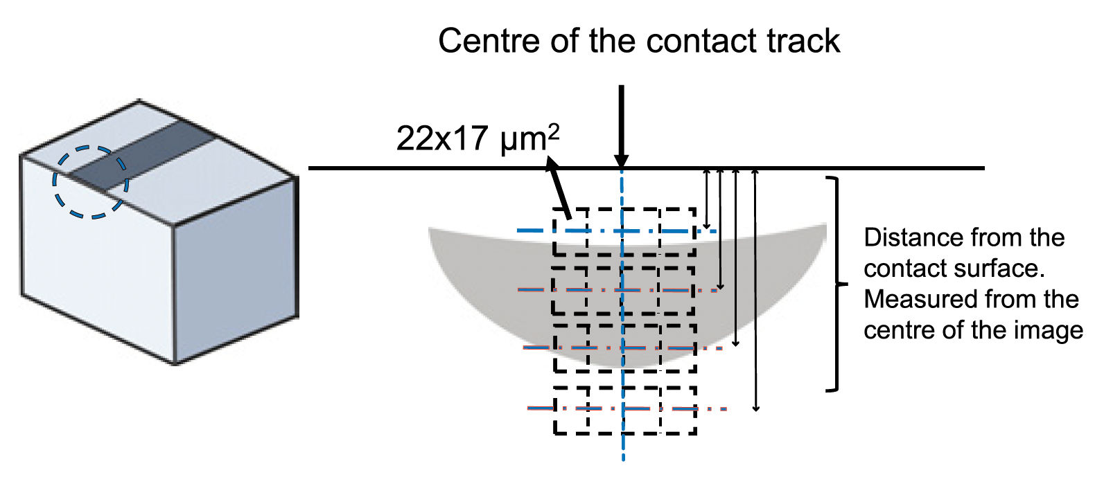

Four high-resolution images were obtained at four different depths (50, 75, 100, and 125 µm.) for each material, with each image size being 22 × 17 µm2 (see Figure 3).
Figure 3—The sample orientation for determining the area fraction of microstructural decay in the radial section sample. The schematic indicates the size, number and position of the SEM images.
For the analysis, 374 grid points were used in each image to calculate the area fraction of material decay on the radial section of the raceway track. Figure 3 illustrates the configuration and the position of the images.

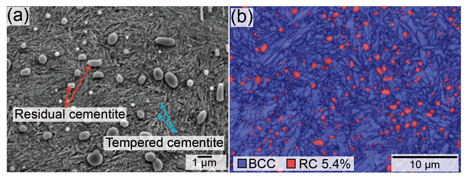

Figure 4(a) shows the SEM image of the as-heat-treated virgin sample of 52100 steel. The steel has a martensitic structure with the average diameter of RC determined to be 0.72 ± 0.22 µm with an aspect ratio of 1.58 ± 0.39. The volume percentage of RC determined from the EBSD phase map is 5.40 ± 0.42, see Figure 4(b). The image analysis using the SEM micrographs indicates that the volume percentage of tempered cementite is about 15 percent.

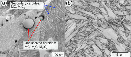

Figure 5—Hybrid Steel 60 virgin material. (a) SEM/SE image showing secondary carbides and undissolved carbides within the martensitic microstructure. (b) EBSD image quality map showing martensite laths.
The as-heat-treated microstructure of Hybrid Steel 60 is shown in Figure 5(a)(b), it comprises lath martensite, Figure 5(a)(b), secondary carbides such as MC and M7C3 (plate-like carbides), NiAl intermetallic precipitates, and a small number of undissolved precipitates MC, M2C, and M6C.

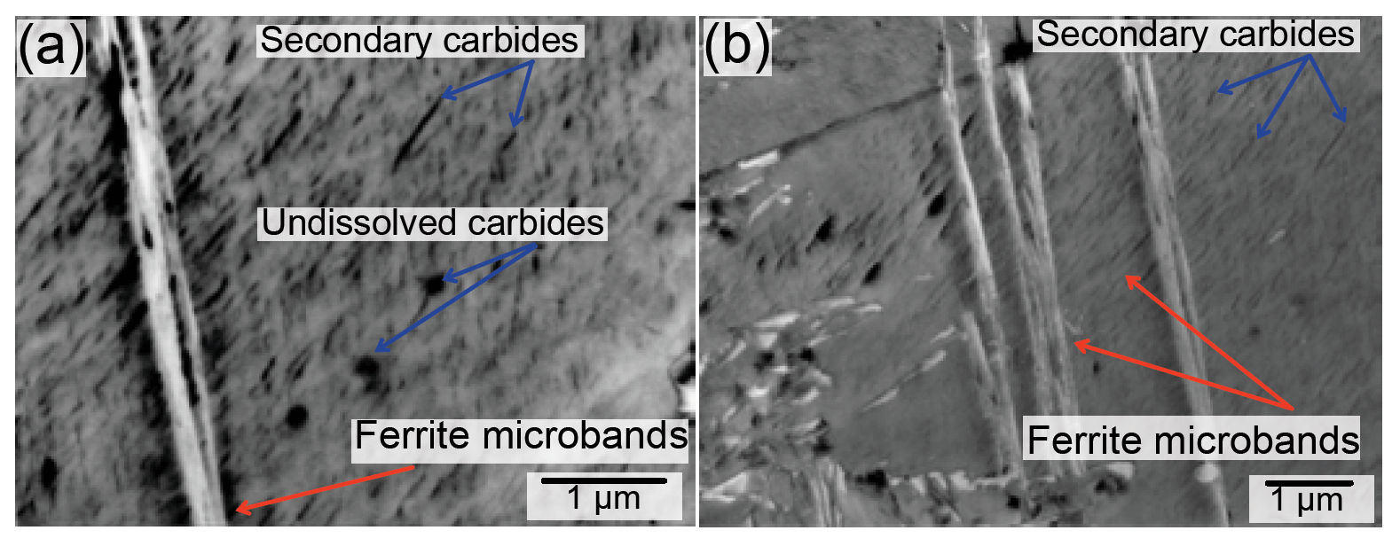

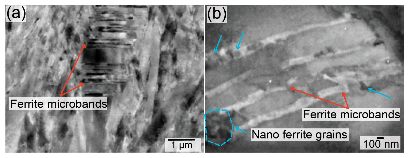

Figure 9(a)(b) shows the formation of parallel bands within martensite laths known as ferrite microbands. Some nano-sized ferrite grains are also formed adjacent to the ferrite microbands. The ferrite microbands have a size of 150 ± 28 nm and appear to form within the martensite laths that are favorably oriented for slip.
Figure 9(b) shows that the tempered martensite is replaced by the formation of ferrite microbands and nano ferrite grains (encircled with the yellow dashed line). The microstructure decay observed here is similar to that found during RCF in the 52100 steel, which the rearrangement of dislocations can explain due to cyclic microdeformation.
Figure 10—Microstructural decay n the Hybrid 60 steel in the CS at a depth of 60 μm beneath the raceway surface. (a)SEM/BSE image of ferrite microbands, surrounded by secondary carbides. (b) SEM/SE image of secondary carbides.
Figure 10(a)(b) illustrates the presence of secondary carbides within the martensite laths, as well as ferrite microband formation in Hybrid Steel 60 after RCF. The results show that the secondary carbides remain undissolved within the martensite lath region close to the ferrite microband, indicating their high mechanical stability. This is the critical factor for the material’s high decay resistance. Alloy carbides exhibit high thermodynamic stability, making them less susceptible to dissolution due to dislocation movement and variations in dislocation density.

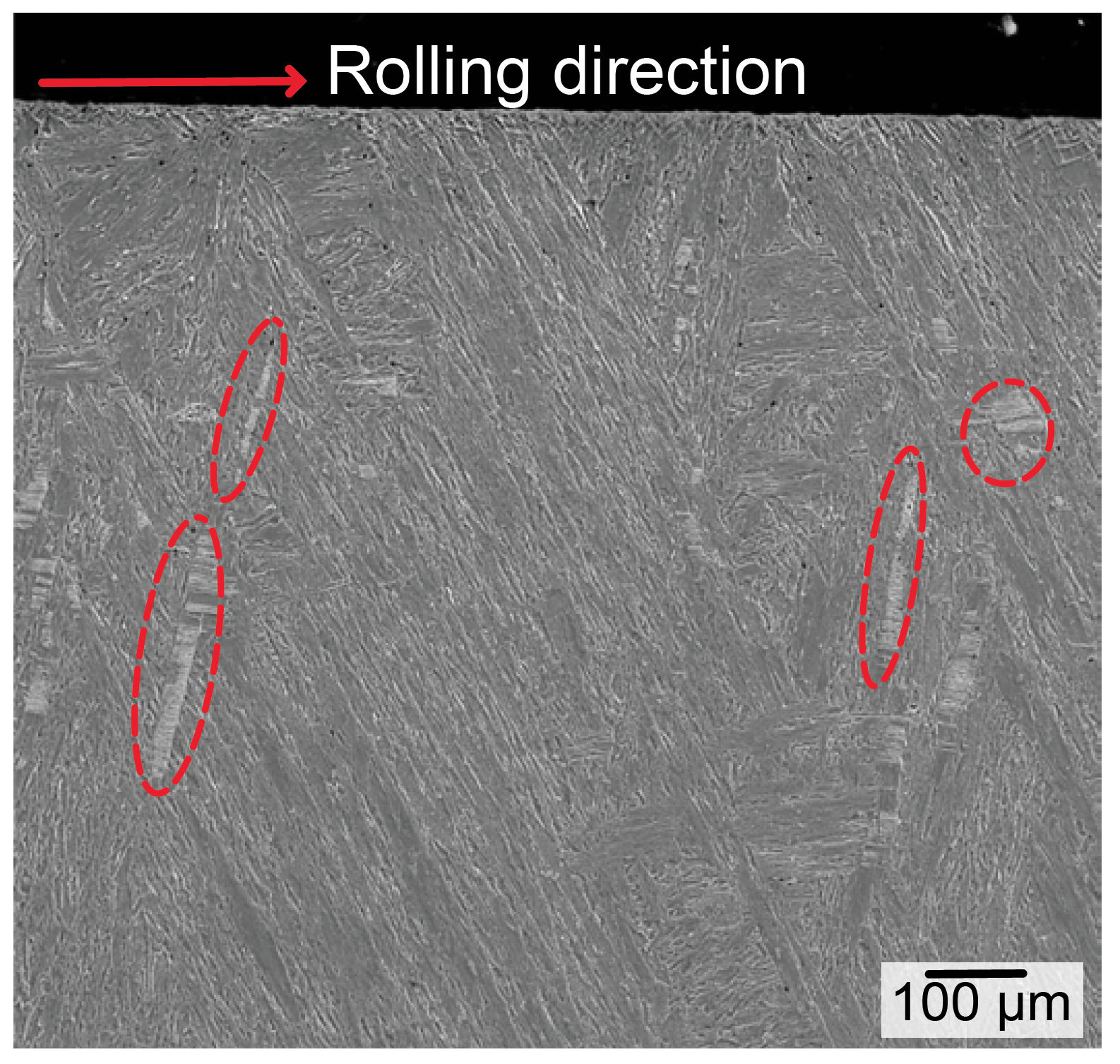

A comparison of the different microstructural decay is shown in Figure 11a-b and Figure 12a.
In Figure 11, the area encircled by the dashed white lines shows examples of decayed microstructure. In these areas, elongated ferrite, ferrite microband, and nano-sized equiaxed ferrite can be observed.

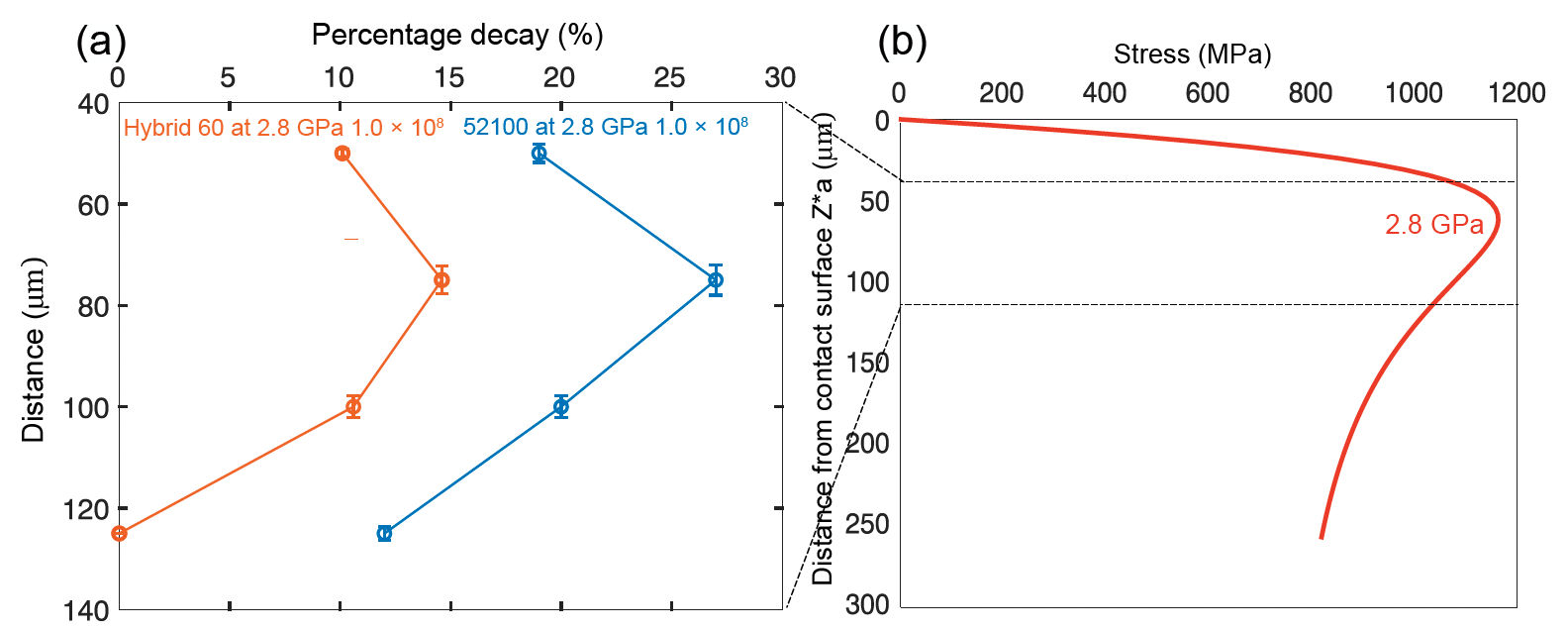

Figure 12(a) shows the change in the area percentage of microstructural decay from the contact surface toward the interior of the sample. The shear stress distribution across the depth calculated using Hertz theory is also shown in Figure 12(b).

The microstructural decay increases with the depth from the surface, having a maximum value between the depths of 75 and 100 µm, where the Hertzian stress is the highest during RCF. The percentage of microstructural decay is also higher for 52100 steel than for Hybrid Steel 60.
