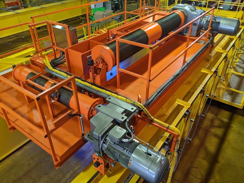

One of the standard and most requested options on an OMi crane is the company’s “built-up hoist and trolley” system. As Rue explains, these assemblies are often the most customized and technically demanding parts of the crane. “The hoist does all the work, which is why we’ll often use one of the bigger Nord units, such as the SK 10 with a hundred horsepower motor.”
This broad horsepower range—from half-horsepower travel motors to the 100-horsepower hoist drive just mentioned—gives OMi the ability to spec out each crane's lifting capacity exactly to the application. Yet speed is also crucial. In high-throughput environments like coil warehousing, even minor differences can significantly impact production, which is why it’s not uncommon for customers to request lifting speeds tailored to the flow of their assembly lines or staging areas, where even seconds shaved off a cycle can add up to meaningful gains over time.
“We cater the hoist to our customers’ needs, "Rue says. " For instance, a couple of feet a minute on a hoist, when spread out over several days or a week, makes a big difference in the number of picks they can make. So, if they want the hoist to go 21 feet per minute instead of 19 feet per minute, we make it go 21.”
