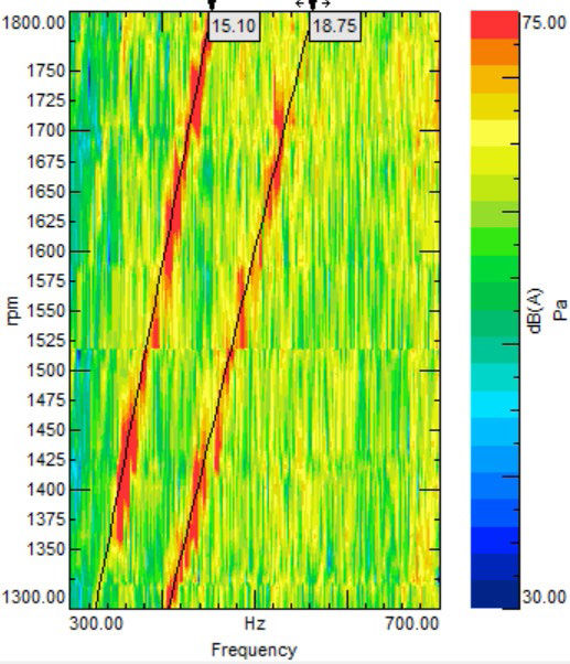

Noise data is recorded using a binaural headset along with engine RPM. Different sets of data acquisition were executed corresponding to constant RPMs, engine RPM sweep (from low idle to high idle engine RPM). A sampling rate of 44 kHz is considered. For test data analysis, a frequency resolution of 1 Hz with A-weighting is applied.
Based on the order analysis, high amplitude orders were identified as shown in Fig. 2. By suppressing those orders in sequence/combination and listening to the sound, dominant orders 15.1 and 18.75 are confirmed for further investigation.
Figure 2—Baseline response.
The noise was specific to the combination of the speed and range lever selection. In the noisy condition, three gear meshes were transmitting torque to the spiral bevel gears connected to the rear axle through the planetary final drive. Based on the number of teeth and power flow, orders were calculated for different gear mesh combinations. It was found that the two identified orders viz 18.75 and 15.1 corresponded to one range gear mesh and one-speed gear mesh which were engaged and transmitted the torque.

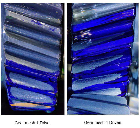

Figure 3—Baseline design physical gear contact pattern.

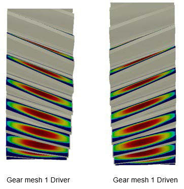

Figure 4—Baseline design simulated gear contact pattern.
To calibrate the simulation model, a gear contact pattern test was conducted on a test bench using masking compounds on the gear flank. The torque through the gear mesh was set to be the same as that in the actual application. Actual torque values in field applications were obtained by strain gauging the transmission shafts and running the tractor in field conditions. This physical test served two purposes: to calibrate the simulation model and to understand contact health issues in one of the two gear meshes. It highlighted the necessity for lead slope correction to achieve centered contact within the application load range. This insight informed the final microgeometry adjustments in the lead direction for the gear mesh of order 18.75 (Gear mesh 1).
The lead crown values were kept to a minimum to increase effective face contact ratios while ensuring no edge loading, as revealed in the contact pattern studies conducted in the simulation software.
It became evident that Gear mesh 1, with its offset contact pattern, required lead slope correction. During the development of these lead corrections, it was discovered, through software simulations, that the necessity for lead correction could be reduced by flipping the helix hand due to the change in system deflections. After evaluating the impact on the calculated bearing life, the team opted to modify the helix hand in conjunction with the previously mentioned gear design enhancements.

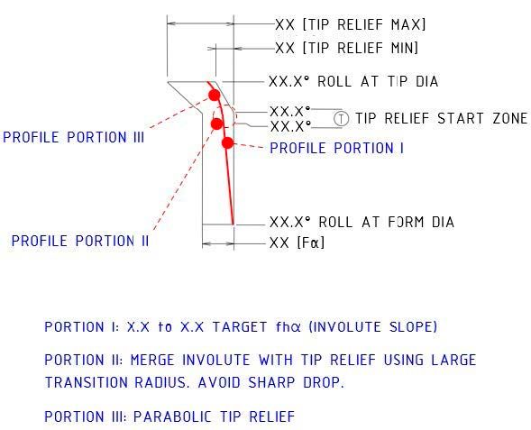

The selection of the manufacturing process can also be influenced by the simulation results and limitations of traditional gear tooth finishing methods. Software simulations revealed that the tolerance of the start of tip relief had a significant impact on the PPTE values. Previous gear projects involving gears of similar size indicated that even with controlled heat treatment and an additional stress-relieving cycle, shaving could only achieve start-of-tip-relief roll angle tolerances of ±1.5 degrees. Simulation data indicated that this would lead to a notable increase in PPTE values. Further attempts to address this issue are discussed in the article “Lessons Learned from Earlier Trials” later in the paper. It became evident that gear shaving was not a viable solution to reduce these gear excitations. Gears that were originally manufactured under DIN 9 grade (using shaving) were upgraded to DIN 7 grade (using grinding) by opting for hard grinding as the finishing process. It is important to note that all gears underwent heat treatment for case carburizing throughout the trials mentioned in this paper.
From the first attempts at grinding the gear flanks, a sharp edge was visible at the transition between the involute and tip relief zones of the profiles. This sharp edge was a result of high tip relief amounts along with linear tip relief grinding method causing a sudden transition from pure involute. This sharp edge could have potentially caused its own excitation when in contact under load, creating noise. To mitigate this issue, smoother transitions were deemed necessary, requiring the implementation of parabolic tip relief and transition fillet radii instead of linear tip relief tooth grinding. Simulations also demonstrated superior PPTE values with parabolic tip reliefs compared to linear tip reliefs for each gear mesh.

Figure 5B—Special tip relief and transition instructions.
The three profiles above (Figure 5) referred to as Nominal, Minimum, and Maximum profiles illustrate the grinding trials described earlier. Utilizing a single flank grinding machine, various possible profiles were manufactured to simulate the effects of manufacturing variations in large batch production and to identify profiles yielding improved noise results. Lead charts were prepared alongside these profiles, where “Nominal,” “Min” and “Max” denoted the target, minimum, and maximum lead modifications based on the microgeometry of the proposed design. Special instructions for providing 2nd-degree parabolic tip relief and a smoother transition included specifying the intended profiles on the K chart such as Figure 5B.
