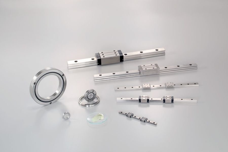

IKO’s Liquid Crystal Lubricant for Semiconductor Applications Is Available for Samples
When tested in various conditions, Liquid Crystal Lubricant exhibited:
Outgassing: Very little detection in mass spectrometry at 10-5 Pa and high temperature at 100°C and 200°C.
Evaporation: Zero net weight loss in an open atmosphere, even at 100°C over 770 hours.
Dust generation: One-tenth the amount of particles compared to lithium soap-based grease, and
also superior to cleanroom grease and vacuum grease.
Other results included dramatically better long-term durability and lower rolling resistance than conventional lubricants. Liquid Crystal Lubricant supports many IKO bearings, and samples are available in two sizes: 2.5 milliliters (MG2.5B/LCL01) and 10 milliliters (MG10B/LCL01). ikont.com
