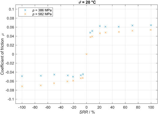

The boundary friction is calculated by using a characteristic diagram, which is determined with a two-disk test bench for every grease under various operating conditions. The overall setup of the testbench, as well as its functionality and the execution of the test, is described in Ref. 10. The varied parameters to achieve different operating conditions are shown in Table 1. The low sum velocity and the high slide-to-roll ratio SRR (up to 100 percent) can be explained by the conditions in the worm gear contact, as shown in Ref. 9, and these circumstances are modelled with the given parameters on the two-disc testbench. The two discs are analogous to the materials used in worm gears, made of bronze and steel. In a worm gearbox, the worm is usually made of steel, and the worm wheel is made from bronze.
ParameterValue
Sum velocity0.2 m/s
Slide-to-roll ratio (SRR)0 - ±100 %
Temperature20 °C, 50 °C, 80 °C
Contact pressure386 MPa, 582 MPa, 802 MPa
Lubricant quantity0.5 ml
Repetitions3
Table 1—Parameters two-disc test bench.
During the tests, different coefficients of friction were determined for positive and negative slide-to-roll ratios (SRR). The difference between positive and negative SRR results from the different speed distribution of the two discs. Investigations with positive SRR were made with the steel disc rotating faster, and the values for negative SRR were determined with the bronze disc rotating faster. The primary focus during this investigation is on the values for positive SRR, which means that the steel disc is rotating faster. This condition is the main use case in real worm gear boxes because the worm is rotating faster than the wheel. The used grease is classified according to Ref. 4 into NLGI class 1, and its base oil viscosity amounts to 680 cSt.
During the tests, traction curves are determined for various temperatures and pressures, resulting in a characteristic diagram for the examined grease. As an example, Figure 1 shows the traction curves of the examined grease at 20°C with two investigated contact pressures.
Figure 1—Traction curves for p = 386 MPa and 582 MPa at 20°C.
The traction curves show a temperature and pressure-dependent behavior of the grease regarding the coefficient of friction. There is also a visible difference between the states of positive and negative SRR. The measured coefficients of friction with the bronze disc rotating faster are higher than those with a faster-rotating steel disc. A possible explanation for this effect is the rolling friction, which always works in the same direction, regardless of the sliding friction. The effect that the coefficient of friction in the area of positive SRR decreases with higher pressure can potentially be explained by a thinning effect on the grease, resulting in lower fluid friction.

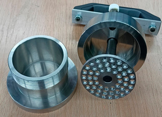

During the experiments on the two-disk test bench, the effect of preshearing on the coefficient of friction was investigated. To research this behavior, the coefficient of friction was measured using two different states of the examined grease. In the first state, the grease was not conditioned beforehand and was directly applied to the two discs. For the second state, the grease was sheared using a kneader for grease according to DIN 2137 (Ref. 11). The kneader used for this investigation is shown in Figure 2.
Figure 2—Kneader for grease according to DIN 2137 (Ref. 11).

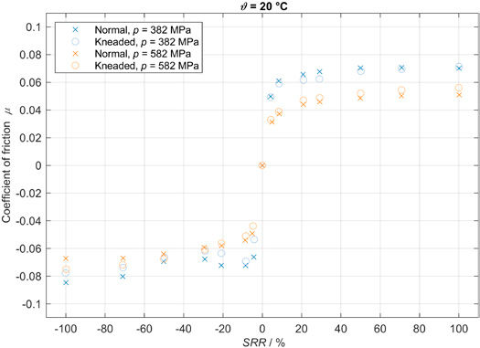

The determined traction curves for the two different states of the examined grease are shown in Figure 3, this time showing the results of an alternative grease in contrast to Figure 1. In this diagram there is again the difference between the values for positive and negative SRR. But in contrast to that the difference between the normal and the kneaded state of the grease is very small, especially in the area of positive SRR.
Figure 3—Traction curves for p = 386 MPa and 582 MPa at 20°C with different states of the alternative grease.

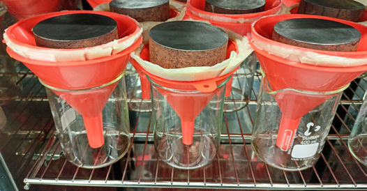

Extraction of the Bleed Oil
Bleed oil refers to the oil in a grease that is “bled” out under load. To determine the properties of this oil, it must first be extracted using a filter method based on the principle in Ref. 12. Therefore, the grease was placed in a filter and then subjected to a static load for a longer period of time. A pleated filter made of cellulose with a retention capacity of 7–9 µm was used and placed in a plastic funnel. The grease was then distributed along the walls of the funnel, and a second funnel was used to apply the load evenly. The load was applied using a disk with a weight of 1 kg, which was placed in the second funnel. The entire combination of funnels, grease, and weight was then placed on a beaker to collect the bleed oil. To speed up the extraction process, the entire assembly was then placed in an oven at a constant temperature of 70°C. In this way, approx. 15 ml of bleed oil per funnel assembly could be obtained over a period of 5 days. The structure in the oven is shown in Figure 4.
Figure 4—Structure for the extraction of the bleed oil.

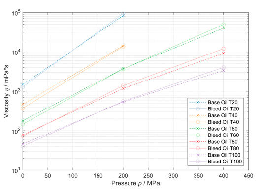

The resulting dynamic viscosities for the various operating points are shown in Figure 5. The measured viscosities show a visible difference between the bleed oil and the base oil, indicating that these two lubricants are not identical. This is an expected result and matches the observations regarding bleed oil and base oil present in Ref. 8, where differences between the oils were also found. As an example, the difference between the viscosity of both oils at 400 MPa and 80°C is 31 percent of the viscosity of the base oil. The standard deviation at this point is 0.8 percent for the base oil and 0.7 percent for the bleed oil. This shows that the measured difference results from the lubricant properties and is not an outcome of the measurement principle. Furthermore, it is noticeable that the viscosity of the bleed oil increases more with increasing pressure than that of the base oil, which indicates the pressure viscosity coefficient αp of the bleed oil is higher than that of the base oil. Currently, there is no explanation for this behavior, and the effect will be subject to further investigations in the future. It is important to check whether this effect occurs with other lubricants as well.

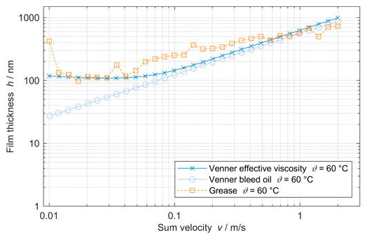

The results of the film thickness measurement at 60°C are presented in Figure 6. The results show clear differences between the film thickness of the lubricating grease and the corresponding oils. In areas of low speed, the film thickness of the grease is significantly higher than that of the oils, and it converges with increasing sum velocity. In contrast to that, the film thickness of the bleed oil and base oil is fairly similar to each other. The small excerpt shows the film thickness of the bleed oil and base oil in a more detailed view, and with the addition of error bars. These graphs show that the difference between the oils does not come from measurement accuracy and that they have different lubricant properties, like the viscosity measurements.

The comparison between the measured film thickness at 60°C and the calculated value with both methods is shown in Figure 8. Here, the values described as “Venner bleed oil” were calculated using the viscosity of the bleed oil according to Ref. 8, and the values named “Venner effective viscosity” were calculated using the correction factors introduced in Ref. 7. The calculation for this effective viscosity is shown in Equation 7.
(7)
The two correction factors A and f are determined by using nonlinear regression for the results of the film thickness measurements of the grease at two striking velocities. The first velocity is the lowest measured speed, but higher than 0.0063 m/s, and the second velocity is the speed at which the behavior of the grease matches that of its base oil. Furthermore, the pressure viscosity parameter αp needed for the film thickness calculation of the grease is obtained from the highest film thickness measurements, where its behavior is close to that of the base oil (Ref. 7).

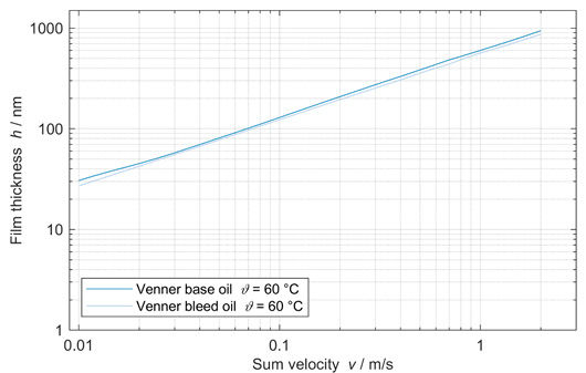

Figure 7—Calculated film thickness for base oil and bleed oil.
The comparison shows overall that the calculation method using the effective viscosity of the grease fits the measured values at this operating point with this exact grease better than the values determined with the bleed oil viscosity. The difference between the two methods is bigger at lower speeds, and the results converge with increasing velocity to each other as well as to the experimental values.

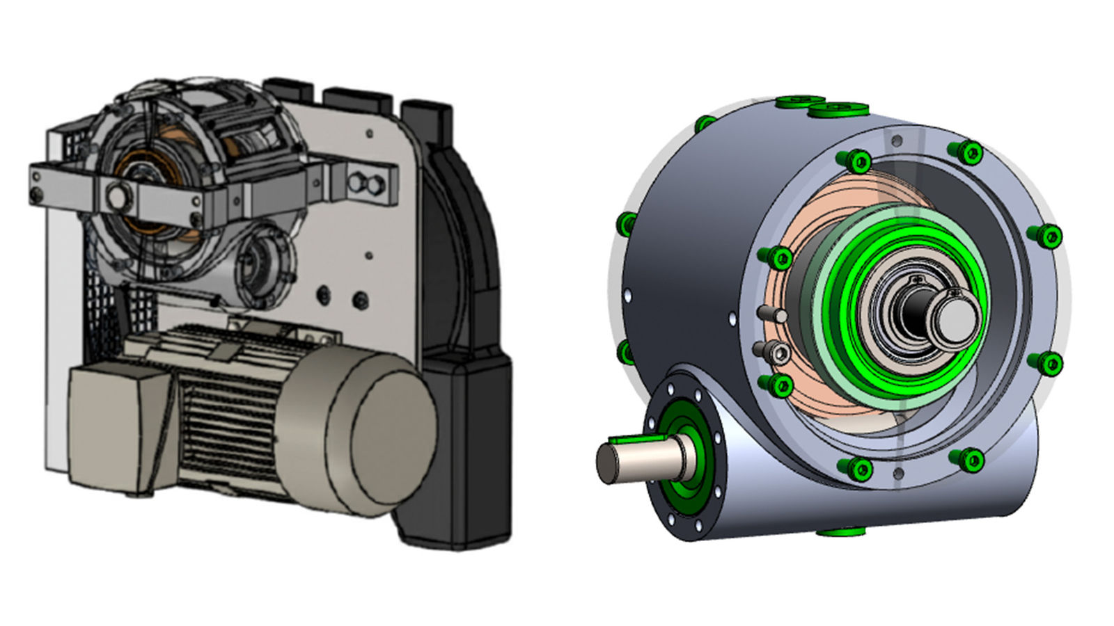

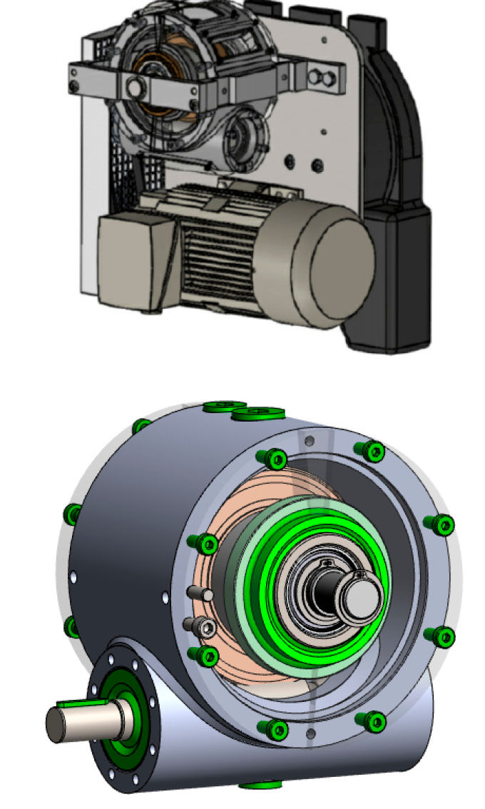

To determine the flow and the distribution of the grease, a gearbox with a transparent lid was used to get a look inside of it during operation. The test bench setup is described in Ref. 19 and shown in Figure 9. The gearbox is designed so that the worm and worm wheel are enclosed close to the contour by the tubular housing parts. The gearbox itself is mounted on a test rig and can be turned into various positions to examine different mounting positions of the worm.
Figure 9—Mounted test bench setup (top) and partly transparent worm gearbox (bottom) (Ref. 19).
During the experimental test, two greases with different consistencies were used, where one is classified as NLGI 1 and the other as NLGI 2 according to Ref. 4. To follow the movement of the grease inside the gearbox and track the intermixing, tracer particles were added to the greases, which can be stimulated to fluoresce by UV radiation. During the test, the drive speed, the location of the worm, the quantity of grease, and the location of application were varied to consider different conditions.
Results on Grease Distribution

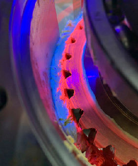

The first test regarding the grease distribution was the experimental determination of the minimal quantity of grease to cover the worm and the worm wheel evenly with lubricant. The result was that the amount is independent of the location of application and grease consistency, because in all tests the approximate amount needed was 20 g. During these tests, it was also visible that the worm wheel functioned as a grease depot, whereas the worm distributed the grease by tearing it out of the tooth gaps. With an increasing amount of grease brought into the gearbox, dead spaces emerged in the gearbox where grease got deposited and was not conducted again by the worm or the worm wheel. An amount of grease sticks to the walls of the gearbox after its contribution and distributes itself poorly. This effect was more distinct with the use of the NLGI 2 grease, the grease with the lower consistency index distributed itself better after a short period of time and did not stick as much on the walls of the gearbox. The amount of grease spun out at a given speed was comparable between the two greases.
Monz already stated in Ref. 2 the effect of a so-called caterpillar as a relubrication mechanism inside the gearbox. This effect occurs when excess lubricant is carried on by the worm wheel and then drifts off at a narrow point. The developing depot grows when a critical amount of grease is exceeded, and a balance is formed between stripping at the beginning of the caterpillar and removal towards the end. The development of this effect is provoked by adding additional grease after the stationary state of lubrication, and in addition to that, the added grease is marked with tracer particles to inspect the intermixing inside the grease caterpillar. Figure 10 shows the emerged grease caterpillar after the test. The investigation on intermixing for the caterpillar is shown in Figure 11. The left picture in Figure 11 shows the behavior of the grease with a lower consistency class, and a good blend between the existing and added grease inside the gearbox is visible. In contrast to that, the grease classified as NLGI 2 in the right picture shows a worse blend of the different markers, resulting in two separate phases of grease. This means that used and fresh grease parts do not intermix as well, and the same grease is carried around in the gearbox all the time. In conclusion, the tested grease classified with the lower consistency had better characteristics regarding the intermixing and overall grease distribution inside the worm gearbox.
Figure 10—Grease caterpillar after the test.
Figure 11—Intermixing of grease for NLGI 1 (left) and NLGI 2 (right).

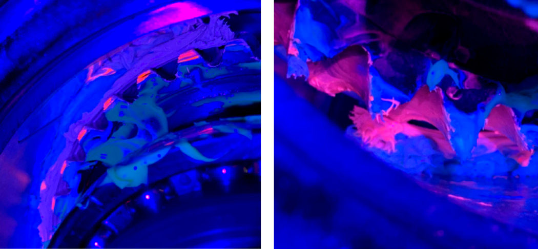

The investigations on the intermixing of the grease showed that a significant amount of grease is not transported further into the contact and instead is deposited on the walls of the gearbox and the front side of the worm wheel. To reduce the amount of grease that deposits on the front side of the wheel and the walls of the gearbox, magnetic guide plates were added to the gearbox, which is shown in Figure 12.
Figure 12—Guide plate to influence the grease transport.
The circulating grease is wiped off at these plates and conveyed back towards the tooth contact to ensure sufficient lubrication. The addition of these guide plates led to a ring-shaped grease flow around the toothing of the worm gear, and a larger proportion of the quantity of introduced grease is mixed and thus actively used for lubrication. This works against the effect of bad intermixing, which was shown before.
