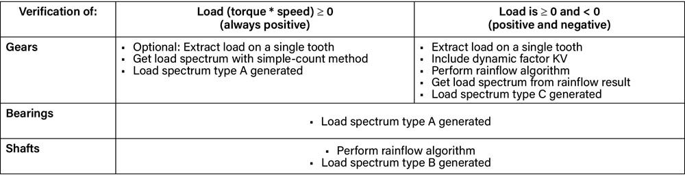

Table 1—Treatment of time-torque-speed data to get a load spectrum.
Depending on the machine element type and the load data (if always positive or positive and negative) different load spectrum types must be generated. See Table 2 for the definition of these types.
Table 2—Generated load spectrum types.

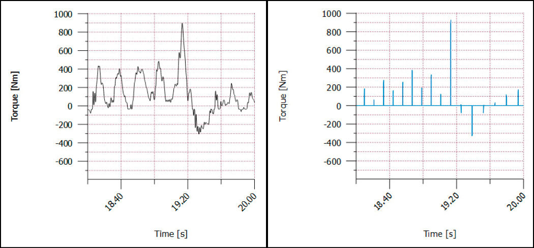

The tooth of a rotating gear is loaded only when the tooth contact occurs. As a result, a tooth is loaded by a sequence of pulsating loads and is stressed just by a portion of the complete load data (Figure 1).
Figure 1—Torque over time in the time series (left). Torque on a specific tooth of the pinion (right).
