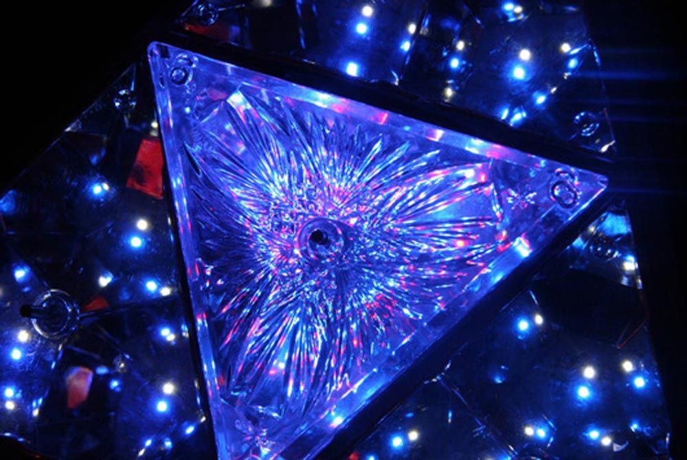

Constructed in 2008, this Ball is twice the size and three times as bright as the preceding Centennial Ball. A geodesic sphere with a 12-foot diameter, the Big Ball features 2,688 Waterford Crystal triangles that are bolted to 672 light emitting diode (LED) modules. Each module, which is attached to the Ball’s aluminum frame, contains 48 red, blue, green and white LEDs, totaling 32,256 lights that can create millions of color combinations and kaleidoscope patterns.

The Big Ball features 2,688 Waterford Crystal triangles.

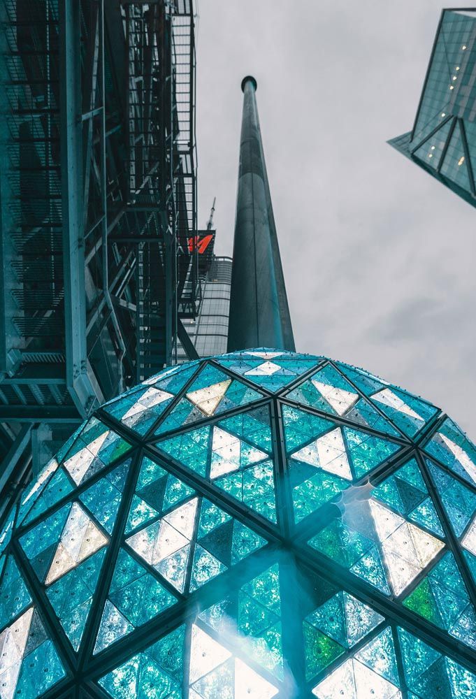

On December 31st at 6:00 p.m. EST, this Big Ball—as it has done for over a decade—rose to the top of its 130-foot mast in One Times Square, where the Ball resides year-round. Then, at 11:59 p.m., it began its 75-foot descent, the timing of which was tied to a global positioning system (GPS).

For 87 years following the first Ball Drop in 1907, the Ball was raised and lowered by six men with ropes and a stopwatch—a solution that is far from practical, if even possible, for the current six-ton Ball. “Although it operates on a limited basis, the Ball must always remain functional,” said Brant Underwood, senior project manager at Hudson Scenic Studios.
Whether the Ball is descending on New Year’s Eve or serving as a backdrop for tourist photos the rest of the year, its full weight—including the LED modules, aluminum frame and electrical system at its center—is supported by a powerful winch system. Designed for inverted mounting below the mast platform, this winch includes a two-line system and 42-inch drum with helical grooving. Two 3/4-inch wire ropes, which connect to the Ball, wrap around the drum in opposing directions, maximizing handling control and keeping the winch system as compact as possible.
