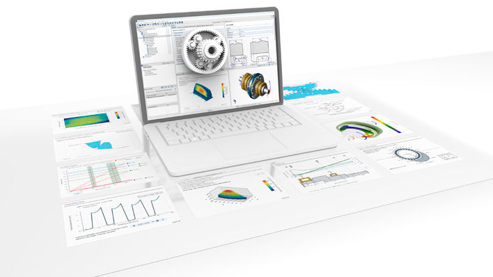

An Overview of New Features in FVA–Workbench 10
The FVA-Workbench is a manufacturer-neutral solution for modeling, parameterization, and simulation of transmission systems. Version 10 was released on February 17, 2025, to make gearbox design even more efficient.
2D Modeler: Faster and easier design changes
The new 2D Modeler makes it possible to quickly and easily modify geometries, shafts, and positions in a single plane. This is especially useful for shaft modeling: the shaft contours can be intuitively edited and modified, which greatly simplifies design and troubleshooting. Another highlight is snap and grid functionality for efficiently adjusting component positions. For example, a rolling bearing can be moved specifically to the shaft edge – the 2D Modeler automatically “snaps” the edge of the rolling bearing to the edge of the shaft, which saves time and enables precise placement of gear elements. This makes subsequent adjustments easier than ever.
