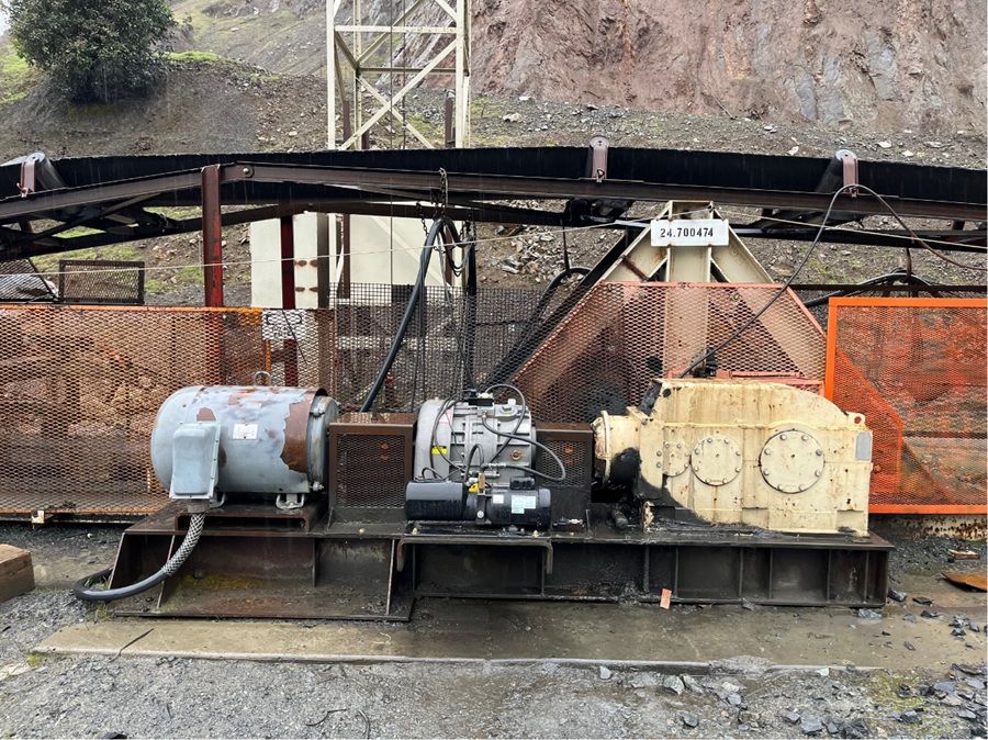

Conveyors are critical equipment at aggregate plants. Downhill conveyors, loaded with tons of material, don’t leave much room for error. When brakes fail and a belt gets away, the result is immediate and dangerous. Material moves where it shouldn’t, and equipment takes the hit. Unfortunately, that’s exactly what happened recently at an Oregon aggregate plant. A brake failure caused a loaded belt to let loose, damaging both the belt and sections of the conveyor framework. Operators responded with front loaders and dump trucks, making repeated trips up and down the incline to clear material. The plant was down. With replacement parts carrying lead times of up to 20 weeks, there was real concern about how long it might stay that way.
At aggregate operations, downhill conveyors are often responsible for moving large volumes of material continuously through the plant, so any loss of control can quickly affect multiple parts of the process and bring production to a halt. The conveyors in trouble were handling stone on an approximate 30-degree incline, each about 36 inches wide. In this type of application, consistent braking performance is critical to maintaining control of the loaded belt.
The system was originally equipped with Force Control Posistop brakes. By all accounts, they had run reliably for about fourteen years. The oil-shear design delivered reliable results with no adjustment and almost no maintenance, while the enclosed design kept dirt and debris away. But a few years back, the maintenance team changed, and fluid levels and system pressure were not consistently maintained. At the same time, issues with the hydraulic power units (HPUs) and valves led to inadequate pressure to fully release the spring-set brakes. In this condition, the system was effectively “driven through” the brake stacks, generating excessive internal heat and accelerating wear. Ultimately, the brakes failed, and on downhill conveyors, it doesn’t take much. Once a loaded belt starts moving uncontrolled, the impact adds up quickly.

The team pulled two Posistop FA-20 brakes, including power units and valves, and sent them out to the Fairfield, Ohio factory. Teardown revealed significant internal heat damage consistent with the brakes being driven through under load, along with worn friction surfaces and compromised internal components. In both units, shafts required rebuilding, including machining undersized bearing journals and rebuilding shaft surfaces through a weld-and-grind process before returning components to final size.
Initial inspection also raised concerns about the condition of the valves and HPUs, which are critical to releasing the spring-set brakes. If these components fail to deliver sufficient pressure, the brakes will not fully release, leading to rapid heat buildup and potential repeat failure. Low or high fluid levels, faulty valves, or insufficient pressure (below 20 psi) can prevent proper release, leading to continued drag and heat buildup inside the brake stack.
The work included evaluation, repairs, cleaning, and testing. Force Control maintains inventory of internal wear components, so the team was able to begin repairs at once rather than waiting on long-lead replacement parts. Both units were turned around in about four weeks, well ahead of the replacement timeline.
When the brakes were reinstalled, the system was brought back online within the scheduled outage window, bringing downhill conveyors back under control and stabilizing material flow through the plant. However, during initial startup, the system experienced added issues when the HPUs did not fully release the brakes, leaving them partially engaged and causing elevated operating temperatures above 220°F. Force Control personnel traveled to the site to troubleshoot, adjust brake stack clearances, and replace the HPUs. After these corrections, the conveyors were back up and running. While pressure spikes were observed, the system was evaluated and confirmed to operate safely without damaging the brakes.
