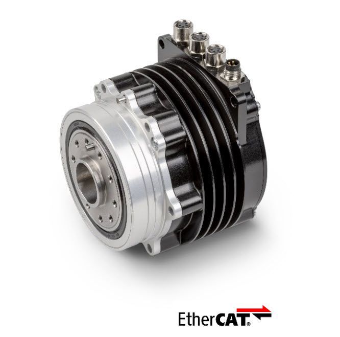

Electromate Inc., Canada’s exclusive distributor of Maxon precision mechatronic components, announces the release of the HEJ 70 High-Efficiency Joint actuator. This compact, fully integrated robotic joint actuator is engineered to meet the demanding performance needs of mobile and manipulation robots. The HEJ 70‑48‑50 actuator combines a torque-dense motor, planetary gearbox, 14-bit absolute encoder, and EtherCAT control electronics into a sealed, IP67-rated package. It delivers a peak torque of ±50 Nm and a maximum joint speed of 28 rad/s, with efficiencies up to 74% at 12 Nm and 26 rad/s. The actuator's compact design (1.05 kg) and high performance make it suitable for lightweight robotic applications.

Key Specifications
  • Peak Torque: ±50 Nm (future variants may exceed 60 Nm)
  • Max Joint Speed: 28 rad/s @ 60 V; 22 rad/s @ 48 V
  • Efficiency: Up to 74% at 12 Nm and 26 rad/s
  • Ingress Protection: IP67 (sealed against dust and water)
  • Voltage Range: 30–60 V DC
  • Control Interface: EtherCAT (daisy-chain), PWM fan control, 1 kHz cycle rate, PDO-mapped gains
  • Position Sensor: 14-bit absolute encoder, < 0.6° error
  • Torque Sensing: Current-based, ± 0.8 Nm accuracy
  • Backdrive Torque: ~0.5 Nm
  • Output Bearing: Cross-roller bearing
Performance & Reliability
  • Continuous Torque: ±19 Nm at 2 rad/s without extra cooling
  • Efficiency Peak: ~74% at 12 Nm & 26 rad/s; generator efficiency reaches ~72%
  • Designed for High Cycle Fatigue: 12 million impacts at 38 Nm, 100k at 50 Nm
  • Operating Life Examples: Over 56,000 hours at 10 Nm, 22 rad/s
Use Cases
The HEJ 70 actuator is ideal for:
  • Autonomous mobile manipulators and cobots
  • Lightweight robotic arms and grippers
  • Quadruped and biped robots
  • End-effector joints, compact SCARA joints, and wearable robotics
Integration Highlights
  • Ready-to-use with onboard control electronics, torque & position sensing, and active cooling system
  • Simplified system architecture using EtherCAT daisy-chain; reduces external cabling
  • Includes simulation models for design verification and sizing
