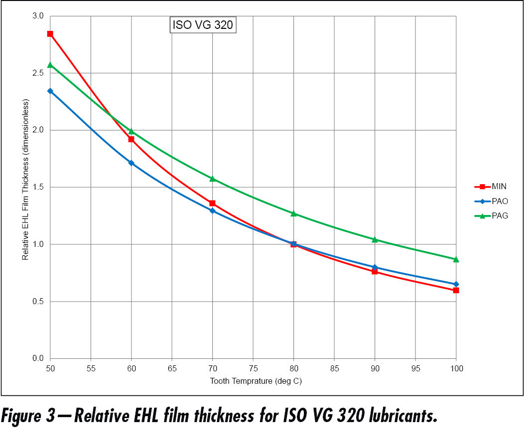

  7. Figure 3 compares performance of the three ISO VG 320 lubricants:
    1. MIN outperforms PAO at temperatures ≤ 80°C.
    2. MIN outperforms PAG at temperatures ≤ 58°C.
    3. PAG outperforms MIN at temperatures ≥ 58°C.
    4. PAG outperforms PAO at all temperatures.
    5. MIN and PA0 perform similarly at temperatures ≥ 80°C.
  8. Figure 4 compares performance of the three ISO VG 150 lubricants:
    2. MIN outperforms PAG at temperatures ≤ 65°C.
    3. PAG outperforms MIN at temperatures ≥ 65°C.
  9. Figure 5 compares performance of the three ISO VG 32 lubricants:
    1. MIN outperforms PAO at temperatures ≤ 90°C.
    2. MIN outperforms PAG at all temperatures.
    3. PAO outperforms PAG at all temperatures.
    4. MIN and PAO outperform PAG at all temperatures.
    5. MIN and PA0 perform similarly at temperatures ≥ 90°C.
