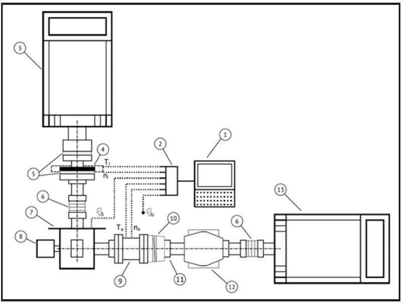

The test bench for examining the worm gearboxes with a center distance of a = 125 mm is designed as shown in Figure 2. Here, the component’s drive motor (Eq. 3), output motor (Eq. 13) and test gearbox (Eq. 7) can be seen. In addition to the torques and rotational speeds at the input and output shaft (Eqs. 4, 9), the temperatures are recorded on several non-moving components. Additionally, the temperature of the rotating worm wheel is transmitted by telemetry via a Bluetooth transmitter (Eq. 8) and receiver. In order to reduce the torque at the output motor (Eq. 13), a planetary gearbox (Eq. 12) is built in the power flow between the latter and the test gearbox (Eq. 7). The test bench for testing the transmissions with a center distance of a = 40 mm corresponds largely to the structure described above. Figure 3 shows an example of the validation results for the gearbox with center distance a = 125 mm and gear ratio i = 10 for lubrication with polyglycol-based oil (PG) of viscosity class ISO VG 460. The comparison between the tribological simulation and the experiments shows very good agreement for both of the examined sizes. The German standard DIN3996 overestimates the efficiency by up to 4%, at an input shaft speed of 1,400 min–1.
Sketch of the test rig setup for the worm gear drive with a = 125 mm.
Figure 2 — Sketch of the test rig setup for the worm gear drive with a = 125 mm.

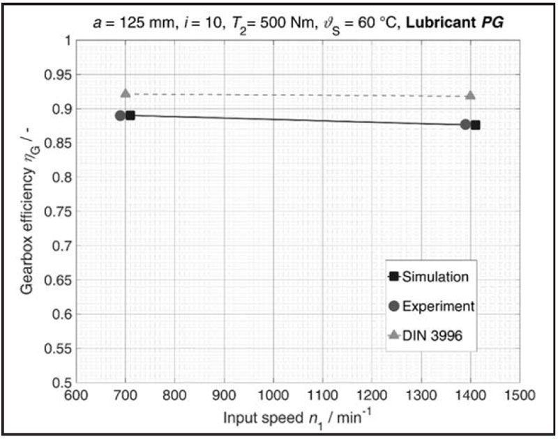

Comparison of gearbox efficiency for a worm gearbox with a = 125 mm, i = 10,
lubrication with polyglycol ISO VG 460 at ?S = 60°C — as determined by tribosimulation,
experimentation, and DIN 3996 (Ref. 1).
Figure 3 — Comparison of gearbox efficiency for a worm gearbox with a = 125 mm, i = 10, lubrication with polyglycol ISO VG 460 at ?S = 60°C — as determined by tribosimulation, experimentation, and DIN 3996 (Ref. 1).

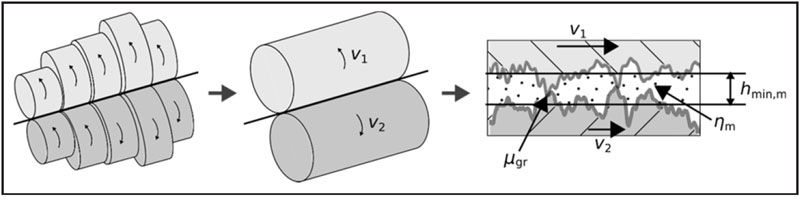

To apply the results of the described work in practice, approximation equations for the determination of the gearing efficiency by simple means are derived. In order to be able to find a suitable calculation rule, a detailed parametric study with the validated simulation program is carried out, thus creating a meaningful data basis. Based on this, the interactions between the different input variables and the efficiency of gearing are examined in order to be able to quantitatively describe them. The approximation equations for the determination of the efficiency of worm gear drives are devised under the guideline of finding a standardized — but at the same time physically justified — approach that can be adopted in (Ref. 1). For this reason many calculation bases and characteristic values (mean pressure between the tooth flanks σHm, mean sliding speed vgm, mean film thickness hmin.m, and average sliding distance sgm) are taken from the existing standard (Ref. 1). Since in practice worm gears operate in the mixed friction area, an approach is used for the approximation equations described below, which considers both boundary and fluid friction in order to reproduce the physical circumstances in the mixed friction area.
The average friction coefficient in the worm gear unit μZ is thus composed of a proportion determined by boundary friction (boundary friction coefficient μGr) and a proportion determined by the fluid friction (fluid friction coefficient μFl). The division factor between the friction mechanisms is the load-carrying contact ratio ψ. While local tribological quantities are calculated with the tribological simulation from (Refs. 2, 7) in order to be able to determine the coefficient of friction in the mixed friction area, a global approach with average characteristics is selected for the approximation equations. The transfer from local to global values is outlined in Figure 4. Influence variables such as the coefficient of boundary friction μGr, the velocities of the tooth flanks v1 and v2, the lubricating gap height hmin,m and the viscosity of the lubricant ηm are now no longer calculated for single discretization points, but are incorporated as global variables into the tribological consideration of the tooth contact.
Schematic representation of the procedure for the transfer from local (left) to global tribological parameters (right) through
simplification by reduction to a global replacement roller pair (middle) (Ref. 7).
Figure 4 — Schematic representation of the procedure for the transfer from local (left) to global tribological parameters (right) through simplification by reduction to a global replacement roller pair (middle) (Ref. 7).

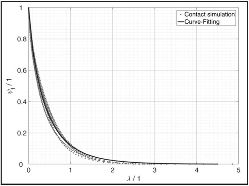

The load-carrying contact ratio ψ is calculated using the dimensionless film thickness λ. In order to calculate the dimensionless lubricating gap height λ, the average gap height hmin,m is divided by the combined root-mean-squared roughness Sq of both friction partners (worm Sq,1 and worm gear Sq,2).
In addition to the dimensionless film thickness λ, the deformation behavior of the two friction partners is decisive for the proportion of boundary friction. With a detailed contact simulation of real-measured surfaces, a relationship between the approximation of the solids and the proportion of the surfaces that are in contact with each other can be calculated. It is found that, in the case of contact calculation with different worn tooth flank surfaces that have been processed by the same manufacturing method, a similar profile exists of the curve describing the load-carrying contact ratio results independently of the root-mean-squared roughness Sq (Fig. 5). This relation can be described according to (Ref. 2) with an equation of the following form:
The coefficients a and b are determined by means of a curve-fitting method from division curves generated with different surfaces. Figure 5 shows the results of the contact calculation in the form of the division curves for the load-carrying contact ratio and a compensation curve.
Multiple dimensionless division curves for the load-carrying contact ratio from contact simulations of different measured tooth flank surfaces and compensation curve through all calculated values.
Figure 5 — Multiple dimensionless division curves for the load-carrying contact ratio from contact simulations of different measured tooth flank surfaces and compensation curve through all calculated values.

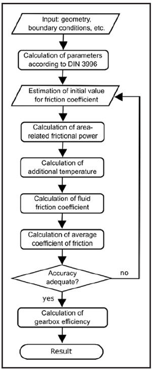

The thermal constant Cth was obtained using regression methods from the data base generated by the parameter study and is mainly dependent on the materials of the gears and the type of lubricant. The method for determining the lubricant temperature in the lubricating gap requires an average coefficient of friction, which is simultaneously the target value of the calculations, as an input variable. For this reason an iterative approach is required. This means that a starting value for the average coefficient of friction must be estimated and afterwards iterated until the deviation between the result and the incoming coefficient of friction comes down to a limit value. This approach is outlined in Figure 6 and explained in more detail in (Ref. 7). The presented method for the approximate determination of the average coefficient of friction shows very good overall agreement with the detailed tribological simulation method (Fig. 7).
Flow chart of the iterative procedure.
Figure 6 — Flow chart of the iterative procedure.

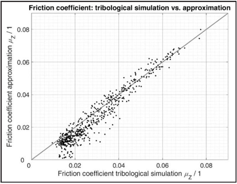

Comparison of the friction coefficient calculated with the tribological
simulation and the values determined by approximation equations.
Figure 7 — Comparison of the friction coefficient calculated with the tribological simulation and the values determined by approximation equations.
Here, the coefficient of friction determined by means of the described approximation equations is plotted over the coefficient of friction determined with the tribological simulation. In the range of μZ > 0.04, the deviations between the two calculation methods are, for the most part, ΔμZ < 0.005. The deviations — particularly with very small coefficients of friction (μZ < 0.03) — can be attributed, for example, to the uncertainties in the calculation of the fluid film thickness according to (Ref. 1).
