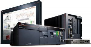

Mitsubishi Electric Examines the Evolution of Predictive Maintenance
In one of the many informative Hannover Messe Digital Days presentations held during Hannover Messe’s Digital Days event in October, Mitsubishi Electric took a deep dive into predictive maintenance (PM).
“PM is not only a technique that uses condition-based monitoring practices and advanced analytic models to monitor the performance of equipment during normal operation to predict failures and recommend maintenance interventions when required,” said Boima Morray, senior director of marketing at Mitsubishi Electric Automation, Inc. “It’s the best way to look at maintenance.”
Early on, reactive maintenance was the norm where technicians would simply “wait” for the equipment to breakdown and take the necessary measures to get the equipment up and running again. Preventive maintenance then became popular as maintenance professionals began scheduling regular equipment checks on the shop floor, performing health assessments and determining when the equipment might breakdown.
There were some key disadvantages to this approach, according to Morray. “Performing maintenance checks on equipment that showed no signs of failure meant increased time periods where the plant would have to shut down. While equipment failures will happen, there needs to be a system in place where you can address the issue immediately and make sure your operation is up and running.”
Predictive maintenance uses analytics to predict and address equipment failures before they occur. A huge change from reactive maintenance philosophies. Data collection, data storage, data analytics, corrective measures, and resolution are all PM tools used today.

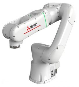

The caveat—of course—is the costs associated with this amount of analytics. Morray said that PM requires massive amounts of data that need to be sorted. Maintenance professionals need to able to monitor equipment in real-time, collect and analyze the data and recommend a corrective measure to schedule a maintenance before the failure occurs.
One example was examining the gears and motors in a robotic arm. While reactive and preventative maintenance will work on this application only predictive maintenance will address environmental concerns, gear strength, motor temperatures, humidity, etc. using real-time analytics—putting the “smart” in smart manufacturing.

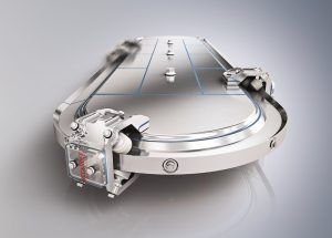

His presentation included information on the company’s eXtended Transport System (XTS). These dynamic mechatronic systems offer the flexibility and scalability that systems in many industries require, such as for complex assembly lines, material handling and distribution, packaging machines, high-throughput filling lines and more. Although linear transport systems are becoming far more integrated with machines, other emerging technologies can boost performance, increase uptime and speed up changeovers. These include new servomotor and drive systems, high-powered Industrial PCs, gigabit communication via EtherCAT G and one-cable automation via EtherCAT P. Johnson discussed how these technologies can reduce maintenance and increase overall efficiency in motion control applications.
The linear transport system XTS unites the benefits of rotary and linear systems. XTS is a mechatronic system containing all functions necessary for operation: a modular, fully integrated linear motor with power electronics and position measurement in a single device, a mover as a moved part and a mechanical guide rail. The most diverse applications can be realized with these few coordinated components. The desired geometries, lengths and radii are formed by the number and choice of the components. XTS enables individual product transport with a continuous flow of material. Due to the low construction volume, the energy efficiency can be improved and the size of a machine can be significantly reduced.
The motor modules of the new XTS Black Line supplement the existing product range by variants without holes in the upper profiles of the motor module. The motor modules in the XTS Black Line are intended for use with guide rails that are not screwed onto the modules.
Straight and curved motor modules can be combined with each other and also with standard modules as desired. The Black Line motor modules are easier to clean because there are no holes in the upper profile. The XTS Black Line motor modules from Beckhoff are ideal for combination with the GFX Guidance System from Hepco. The smooth upper profiles of the motor modules without mounting holes enhance cleanability.
Additionally, the fully encapsulated mechatronic transport system, XTS Hygienic combines the advantages of rotary and linear drive systems for demanding environmental conditions. The stainless-steel version of the XTS linear transport system (with IP 69K protection rating) provides all functions required for system operation:
