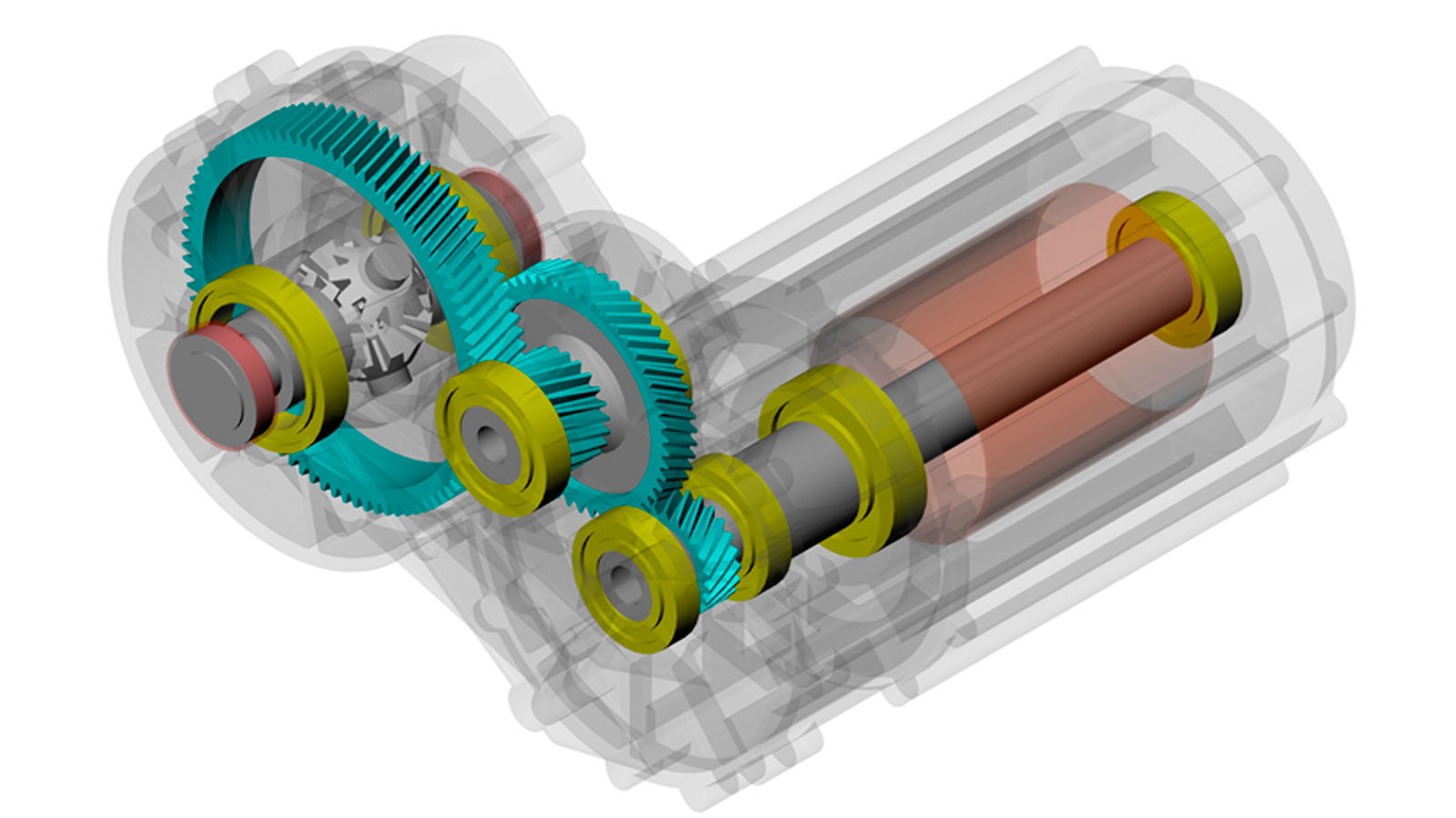

Model Setup

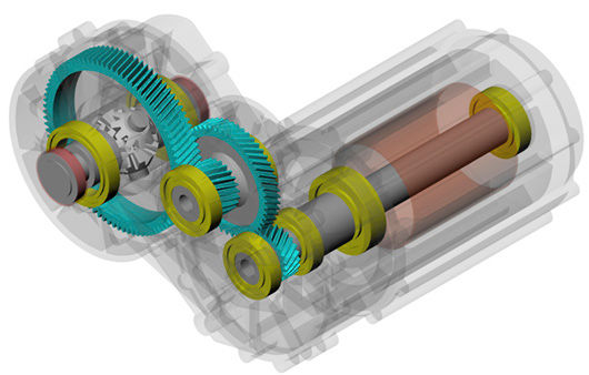

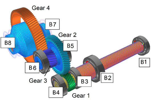

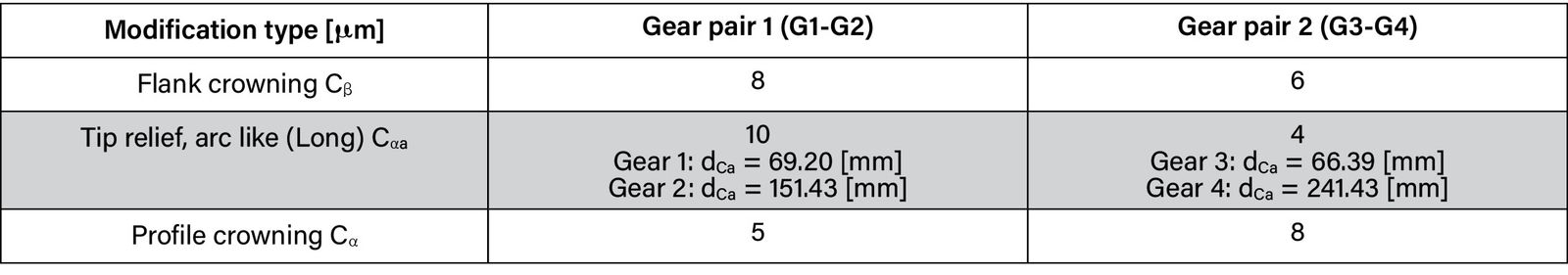

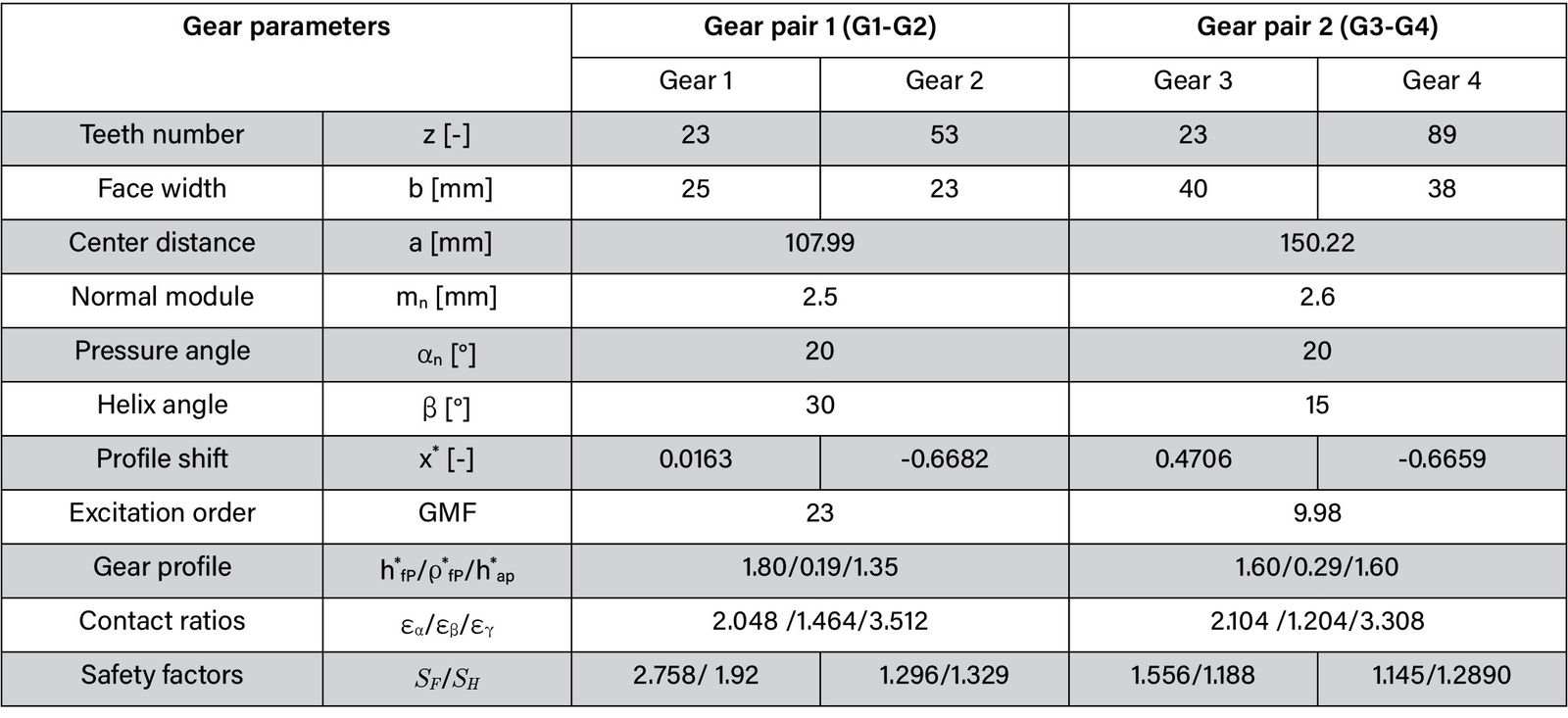

The electric axle analyzed in the following is a single-speed, two-stage gearbox powering the front wheels of an electric vehicle, as shown in Figure 1. The analysis is carried out for the nominal input torque of 320 Nm applied to the input shaft, which is considered here as the reference boundary with a nominal speed of 2,742 rpm. Table 1 specifies the gear mesh data of the gearbox. The microgeometry modifications (Table 2) are designed to optimize the tooth profile for reducing the excitations: helix angle modification and crowning are adopted to reduce the face load factor KHb under various load conditions, while tip relief and profile crowning are adopted to eliminate contact shock and reduce the peak-to-peak transmission error. For brevity, the depicted numbering shown in this figure for the bearings and gears is used from now on within the manuscript.
Figure 1—A two-stage gearbox model layout.
Table 1—Gear mesh data of the gearbox model.
Table 2—Microgeometry modifications.

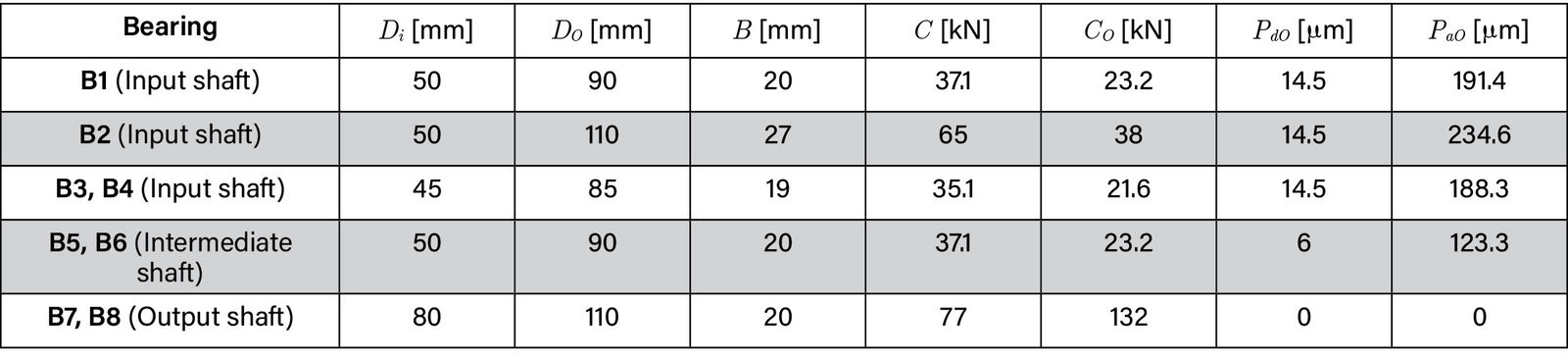

Table 3—Bearings dimensions of the gearbox model.
Furthermore, Table 3 shows the bearings specifications for the electric axle. In this Table, following parameters are specified: Di: inner diameter, DO: outer diameter, B: width, C: dynamic load rating, CO: static load rating, PdO: nominal diametral clearance, an PaO: nominal axial clearance.

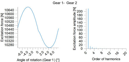

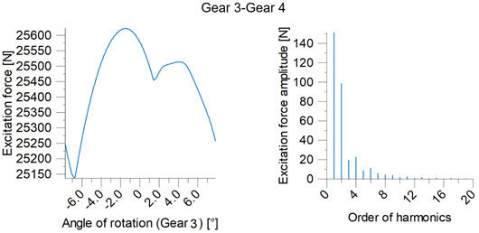

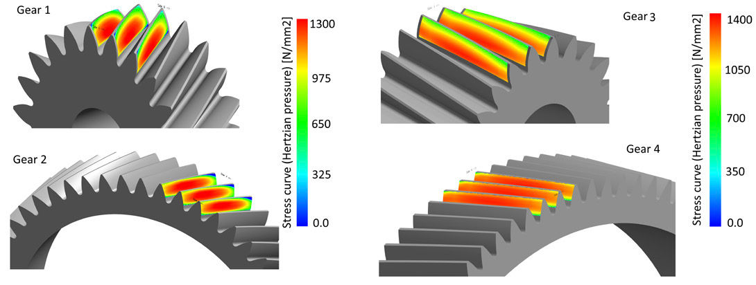

In this study, the gear meshing is considered as the only excitation source. In KISSsoft, the contact analysis is based on the Weber/Banaschek approach, which uses analytical formulations for quasistatic analysis by neglecting dynamic effects (Ref. 21). Shaft misalignment is taken into account to adopt more realistic conditions in calculating the excitation forces. As a result of the contact analysis, Figure 2 shows the stress distribution on the tooth flanks for the nominal input torque T=320 Nm. Depicted in Figure 3 illustrates the excitation force and its amplitude spectrum of both pairs. It can clearly be seen that for both pairs, the first two orders of the excitation force are dominant. Therefore, without significant loss of accuracy, only these harmonics are considered in calculating the excitation forces in the forced response analysis.
Figure 2—Stress distribution on the tooth flanks.
Figure 3—Excitation force.

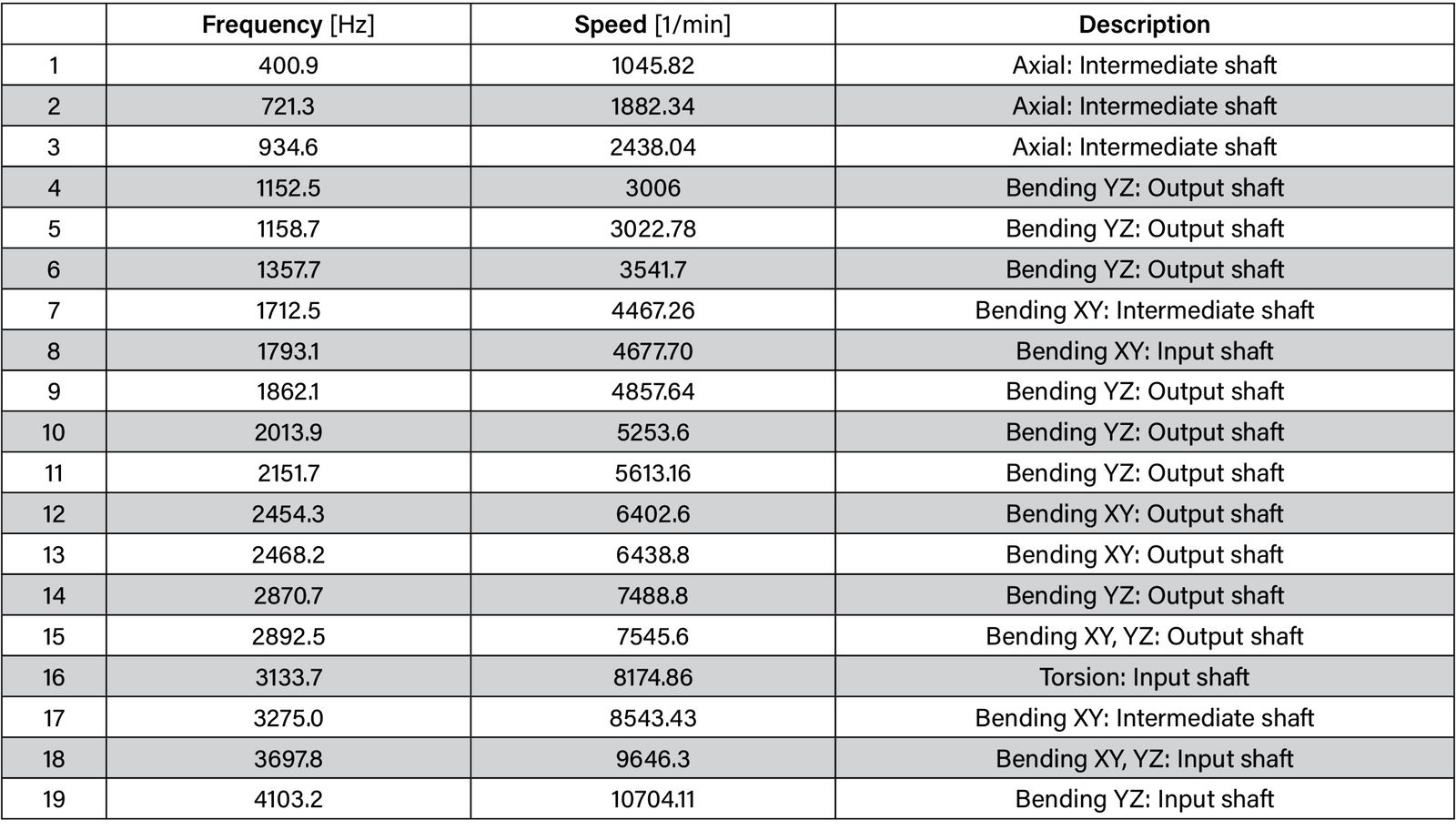

It is well-established in vibration theory that damping mechanisms in mechanical systems are particularly effective at mitigating resonant vibrations when the operating frequency aligns with the system’s natural frequency. It is therefore imperative to identify the operating speeds that correspond to the system’s natural frequencies, particularly those at which gear mesh excitations impose significant dynamic loads, potentially leading to resonance phenomena. As a result of this fact, it is required to perform a modal analysis to find the system’s eigenfrequencies and their corresponding input-shaft speeds, which excite the system at those frequencies. Table 4 shows the results of this analysis in KISSsoft. The values of the input shaft speed resulting in the gear mesh frequency of the first gear pair equal to the eigenfrequencies are calculated.
Table 4—Eigenfrequencies of the model.

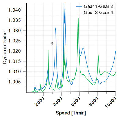

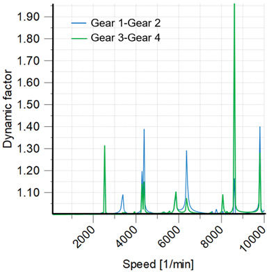

In the first step of the forced response analysis, the undamped response of the gearbox model to the first harmonics of the gear meshes’ excitations under nominal input torque equal to 320 Nm is studied. The goal of this investigation is to check how the eigenmodes of the system contribute to the dynamic gear mesh forces. For this purpose, the speed range of the input shaft is considered from 100 to 10,000 rpm at 200 evenly spaced speeds. After running the forced response, the variation of the dynamic factor as a result of this analysis is shown in Figure 4.
Figure 4—Dynamic factor of the gear pairs in the undamped case.
At several speeds, the peak values of the dynamic factor are obvious. These points are associated with the excitation frequencies which are close to one of the eigenfrequencies governed by the gear pairs, see Table 4. For instance, this can be seen especially at S = 8,543.43 rpm, which is in fact the eigenmode No. 17. It is important to notice that two gear pairs have different gear mesh excitation frequencies. Furthermore, the influence level of the eigenfrequencies and their corresponding eigenmodes on the relative movement of the meshing contact points of two gear pairs can be significantly different. Therefore, special attention needs to be paid to finding the relation between the eigenfrequencies and the input-shaft speeds at which a peak value of the dynamic factor is observed. It is important to note that Figure 4 illustrates a qualitative variation of the dynamic factor rather than providing a quantitative representation. This implies that selecting different input parameter settings can lead to varying peak values of the dynamic factor. However, this is entirely reasonable, as the speeds at which these peak values occur remain consistent. This consistency arises because the system’s response and, consequently, the maximum dynamic contact force are significantly influenced by the excitation frequencies.

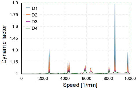

In this section, the effect of damping in shafts, gear meshes, and bearings is separately investigated to provide more insight into to their individual effect on the reduction of the meshing contact forces and the bearing reaction forces. The investigation is carried out at the input torque 320 Nm for a wide range of running speeds and damping values. The analysis is followed by considering the case when the effect of damping in all elements is combined.
Damping in Shafts

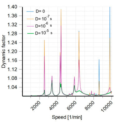

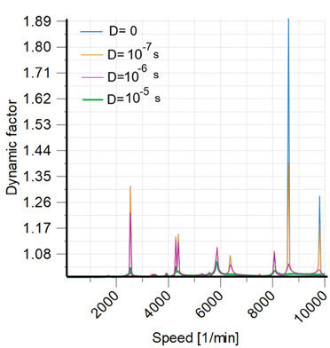

In the first step, the dynamic factor of the gear pairs for different values of the shaft damping is checked. Figure 5 depicts the effect of torsion, axial, and bending damping on the reduction of the maximum dynamic contact force. The damping effect at higher excitation frequencies with D = 10-5 s is more obvious.
Figure 5—Dynamic factor of G1-G2 (top) and G3-G4 (bottom) for different shaft damping values.

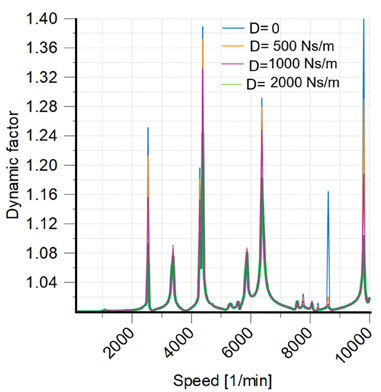

Damping in Gear Meshes
In the next step, the dynamic factor of the gear pairs for different values of the gear mesh damping is examined. According to Figure 6, the influence of the gear mesh damping becomes particularly evident when the excitation frequency coincides with one of the system’s eigenfrequencies related to the gear mesh compliance, rather than the shaft deformations. This can be seen here again at S = 8,543.43 rpm, which is in fact the eigenmode No. 17, see Table 4.
Figure 6—Dynamic factor of G1-G2 (top) and G3-G4 (bottom) for different gear mesh damping values.

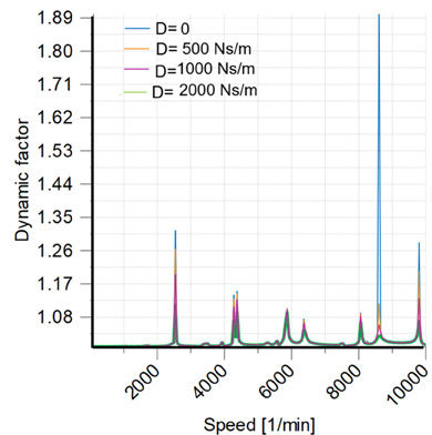

Damping in Bearings

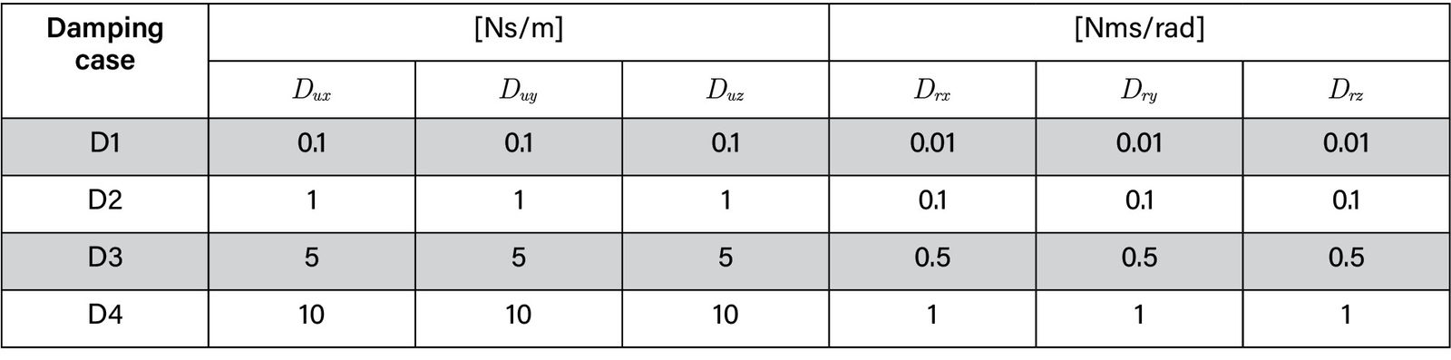

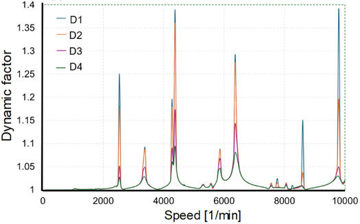

In this section, the effect of damping in bearings is investigated. For this purpose, four different cases, D1 to D4, with their six components of the damping values are considered as given in Table 5. As the result of this comparison, Fig. 7 shows the results. In contrast to the case of gear mesh damping, here the damping effect on the reduction of dynamic factor peaks is evident.
Table 5—Bearings damping specifications.
Figure 7—Dynamic factor of G1-G2 (top) and G3-G4 (bottom) for different bearing damping values.

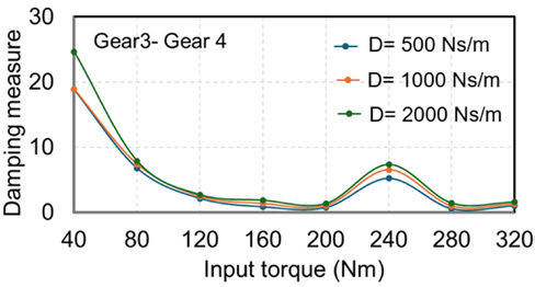

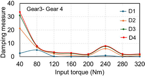

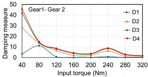

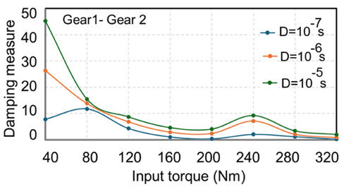

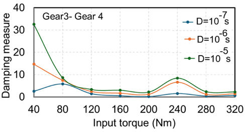

Damping in Different Input Torque Levels
The torque-induced variations in bearing stiffness and gear meshing stiffness significantly influence the system’s modal frequencies and vibration modes. For instance, as torque increases, bearing reaction forces intensify, leading to greater bearing deformation. This results in a relative reduction in bearing misalignment, which can affect the dynamic response of the gearbox. Additionally, gear meshing stiffness plays a pivotal role in determining the system’s natural frequencies and mode shapes. Studies have shown that variations in meshing stiffness can lead to abrupt changes in coupling frequencies and mode shapes, thereby influencing the dynamic behavior of the system.
Section 7 investigates the impact of damping in shafts, bearings, and gear meshes on the reduction of maximum dynamic gear mesh forces, initially assessed at a nominal input torque of 320 Nm. This section extends the analysis by varying the input torque from 40–320 Nm in 40 Nm increments. This incremental approach provides deeper insights into how torque levels influence the damping of undesired vibrations. A critical observation is that the eigenfrequencies of the gearbox model are torque-dependent, influenced by the torque ratio of the gear pairs. Changes in the input torque alter bearing stiffness values, which in turn affect the modal characteristics of the gearbox. Consequently, the peaks of the dynamic factor occur at different excitation frequencies compared to those observed in Figure 4. Therefore, in this section, the same increments in the damping values of the shafts, gear meshes, and bearings, as described in “Effect of Damping,” are considered. The speed range of the input shaft is considered from 100–10,000 rpm at 200 evenly spaced speeds. To assess the effect of input torque variation, a damping measure is introduced here. To calculate this measure, the dynamic factor after applying damping is calculated and subtracted from the associated dynamic factor for the case of undamped case. Therefore, this damping measure is merely the difference between the dynamic factors of the undamped and damped systems. The results are shown in Figures 8–10.
Figure 8—Damping measure for different values of the shaft damping versus input torque.
Figure 9—Damping measure for different values of gear mesh damping versus input torque.

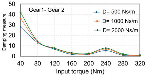

Figure 10—Damping measure for different values of the bearing damping versus input torque.
According to Figure 8, at a low input torque of 40 Nm, all three damping levels show a high damping measure, with the highest value observed at D = 10−5 s, indicating a significant reduction in dynamic forces. As the input torque increases, the damping measure rapidly decreases, stabilizing at lower values beyond approximately 120 Nm. This suggests that at higher torques, changes in the dynamic behavior of the gearbox, likely due to increased bearing stiffness and altered modal properties, reduce the overall effectiveness of damping. A slight resurgence in damping effectiveness is observed between 200 Nm and 280 Nm, where the damping measure temporarily increases before declining again at 320 Nm. This reflects the torque-dependent shift in eigenfrequencies, which causes the system to re-enter resonance-prone regions at specific operating conditions. Figure 9 illustrates the damping measure for both gear pairs under varying input torques, considering three levels of gear mesh damping: 500, 1,000, and 2,000 Ns/m. As with previous results, the damping measure quantifies the reduction in dynamic response due to energy loss. At low input torque, 40 Nm, higher mesh damping leads to significantly greater reductions in the dynamic factor, with diminishing returns as torque increases. Beyond 120 Nm, the damping effectiveness plateaus, with all three damping levels converging to similarly low values. A moderate increase in the damping measure occurs between 200–280 Nm, again highlighting the resonance sensitivity due to torque-dependent modal shifts. Finally, Figure 10 shows how varying bearing damping levels (D1–D4) affect the damping measure across increasing input torque. Higher damping values (D2–D4) yield significantly greater dynamic force reduction at low torque (40–80 Nm), while their influence diminishes and converges at higher torque levels. The lowest damping case (D1) remains consistently less effective across all torques.

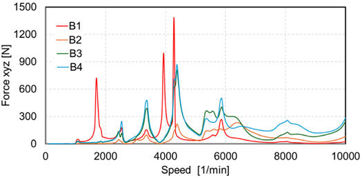

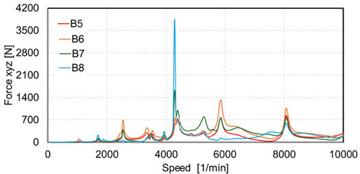

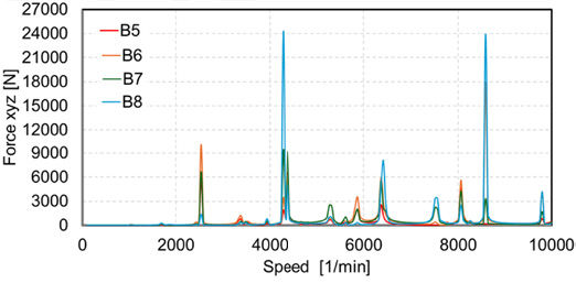

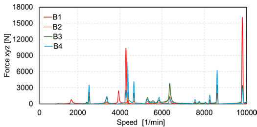

The peak-to-peak amplitudes of the bearing reaction forces are illustrated in Figures 12 and 13, respectively. Comparative analysis reveals that incorporating damping significantly attenuates the peak-to-peak amplitudes, indicating a substantial reduction in dynamic loading. However, in the damped configuration, a pronounced peak in bearing reaction forces is observed at approximately 4,280 rpm, identifying this speed as a critical resonance point. To further assess the impact of this critical speed on the NVH characteristics, the corresponding bearing reaction force data at 4,280 rpm are exported to RecurDyn. This data serves as input for subsequent NVH simulations aimed at evaluating and mitigating potential noise emissions from the gearbox housing.
Figure 12—Peak-to-peak bearing reaction force of the undamped system.
Figure 13—Peak-to-peak bearing reaction force of the damped system.

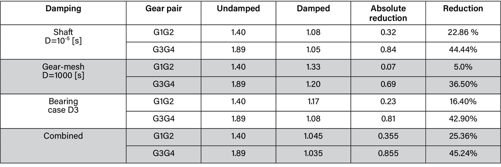

To quantitatively assess the influence of different damping sources on gearbox vibration, the maximum values of the dynamic factor were extracted from the simulation results for the undamped case and for each damping configuration (shaft, gear mesh, bearings, and combined damping). Table 6 provides a compact summary of these peak values for both gear pairs, together with the corresponding absolute and percentage reductions relative to the undamped baseline. This comparison highlights the relative effectiveness of each damping mechanism in reducing dynamic loads.
It can be further concluded from Table 6 that:
Gear3–Gear4 benefits most from damping: all three single-source damping strategies give large reductions (~36–44 percent), and combined damping gives the largest (~45 percent). This indicates the problematic peaks for G3–G4 are strongly dampable (likely mesh-related resonances and bearing-transmitted energy).
  • Gear1–Gear2 shows moderate reductions:
    • Shaft damping (22.9 percent) and bearing damping (16.4 percent) perform similarly and significantly.
    • Gear-mesh damping has less effect on G1–G2 (5.0 percent), implying those peaks are driven less by mesh-compliance resonances and more by shaft/bearing dynamics.
    • Combined damping produces the best overall result for G1–G2 (25.4 percent), but the extra gain above the best single-source (shaft: 22.9 percent) is modest (~2.5 percent).
  • These numbers imply that the bearing damping provides a broad and consistent reduction across the entire speed range, making it the most effective single-location damping strategy.
  • Combined damping yields the largest reductions overall, but the interaction is not strongly synergistic, meaning that the combination gives modest extra reduction beyond the best single damping source (especially for G1–G2).
Table 6—Quantitative evaluation of damping effect on dynamic factor from different sources.

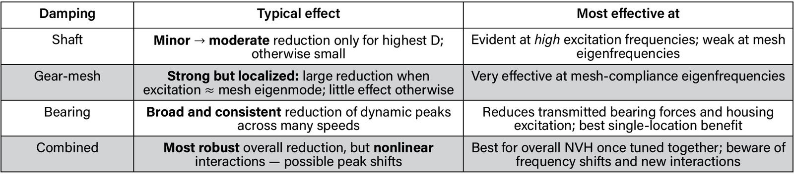

Beyond the quantitative comparison of peak dynamic factors, it is also important to highlight the qualitative differences in how each damping source influences system dynamics. While all mechanisms contribute to vibration mitigation, their effects differ in magnitude, frequency dependence, and consistency. Table 7 summarizes the typical characteristics of shaft, gear mesh, and bearing damping, as well as their combined action, indicating where each mechanism is most effective and how they interact within the drivetrain system.
Table 7—Typical effect of damping on the dynamic factor from different sources.
Overall, the results confirm that shaft and bearing damping are the most effective individual mechanisms for mitigating dynamic loads, while the combined damping configuration provides the most significant overall reduction in dynamic factor, ensuring smoother operation across the entire speed range.

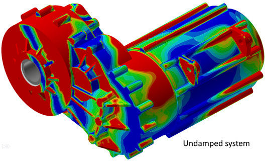

In the previous section, the forced response analysis of the gearbox model in the undamped and damped conditions was conducted. The analysis yielded the bearing reaction forces data. Subsequently, these bearing forces for both undamped and damped cases (corresponding to the input speed 4,280 rpm) are imported into RecurDyn and applied directly to the powertrain housing at the bearing locations, including the bearings, shafts, and gears from the model. The process commences with configuring the housing parameters and performing a modal analysis to extract a reduced-order flexible model, focusing on the first 200 eigenfrequencies. Time-dependent spline functions representing the bearing forces are then applied at the corresponding housing positions. Before executing the NVH analysis, a dynamic simulation is conducted to determine the housing’s response. A critical kinematic parameter for the NVH assessment (the surface velocities at the nodes of the meshed geometry) is calculated. Finally, the equivalent radiated power (ERP), which quantifies the noise emitted from the housing surface to the environment, is computed as follows:
(3)
Where fRLF is the radiation loss factor, C is sound velocity, ρ is the density of a target material which transfers the noise, e.g., air, Ai is the area on the ith flexible panel of the meshed surface, and vi is its face normal velocity. Further details can be found in Ref. 22. To clearly demonstrate which parts of the housing’s surface emit higher noise, the contour plot of the ERP is very helpful. It can subsequently be used to address the design modifications demanded, such as local stiffening of the housing by means of the ribs, to reduce the noise.

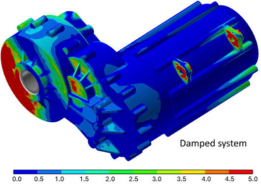

Figure 14 shows ERP contours of both cases. Tmax denotes the time at which the ERP reaches its maximum value. The maximum values of the color legends are adjusted to clearly show the noise distribution through the housing`s surface. It is noticeable to mention that the variation of the ERP depends on the simulation time and on the locally evaluated position on the housing. It is clearly seen that in the undamped model, the region of the housing close to the bearings of the output shaft has higher ERP values and consequently emits noise to the environment. In contrast, the housing of the damped model has a superior performance with respect to the noise emission. The difference between the ERP values of both models reveals this superiority.
Figure 14—ERP contours at the time with maximum values.

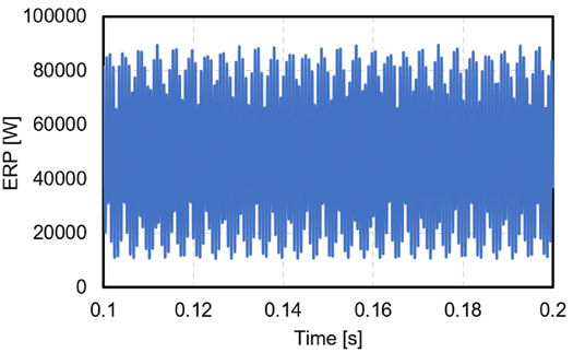

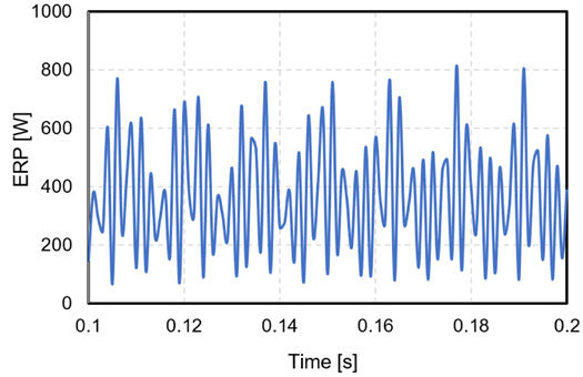

To further clarify the performance of both models, the ERP in time domain is calculated for the surface next to the output shaft by considering the first 20 eigenfrequencies of the housing. The results are plotted in Fig. 15. These results characterize the improvement level of the noise emission from the housing surface based on the damping values selected for this purpose. This in fact implies that proper selection of damping properties leads to a lower level of noise emission by reducing the double amplitudes of the excitation forces and subsequently lower excitations to the powertrain system at critical speeds.
Figure 15—Magnitude of the ERP versus time: undamped case (top), damped case (bottom).
