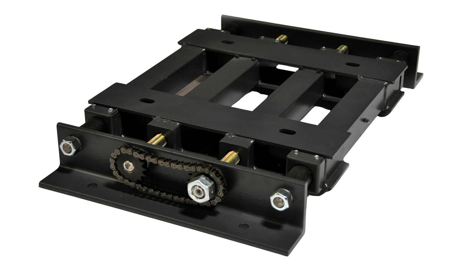

An example of Overly Hautz’s Automatic motor base from their DD-1100 Series.

The Overly Hautz Automatic Motor Base replaces the fixed mounting with a spring-loaded carriage. The motor sits on cross members attached to tubes that ride on base rails. A spring, sized for the specific motor horsepower, speed, and mounting orientation, pushes the motor away from the driven pulley. The belt’s tight side pulls the motor toward the driven pulley. The carriage rests wherever those two forces are in balance.
This balance is continuous. When load increases, higher belt tension pulls the motor inward, compressing the spring. When load decreases, the spring pushes the motor outward, preventing excess tension. The carriage position adjusts mechanically in response to changes in load, without electronics, controls, or manual intervention.
The same mechanism handles belt stretch over time. As belts elongate during their service life, the spring expands, and the carriage moves outward to compensate. Tension is maintained without a re-tensioning visit. Because the carriage moves along fixed rails, pulley alignment set during installation is preserved.
During setup, the automatic base offers a practical advantage: it can be tensioned while the motor is running. The installer adjusts the single drive screw until belt slippage is eliminated under actual operating conditions, rather than relying solely on static gauge readings with the motor stopped.

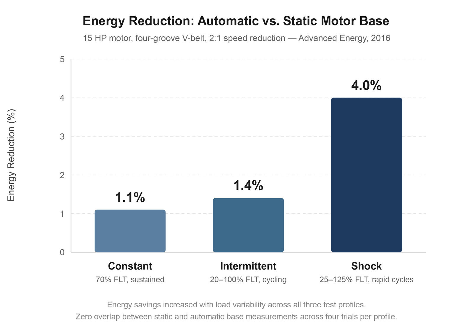

In 2016, Advanced Energy, an independent testing laboratory, conducted comparative energy measurements between the Overly Hautz automatic base and a standard static base. The test used a 15 hp, 4-pole Leeson motor (NEMA 254T frame, 92.4 percent nameplate efficiency) coupled to an eddy current dynamometer through a four-groove V-belt system with a 2:1 speed reduction. Energy input was measured at the motor terminals using a Yokogawa WT-3000 precision power analyzer.
Figure 1—Energy savings increased with load variability in controlled testing using the same motor, belts, and pulleys on both base types.

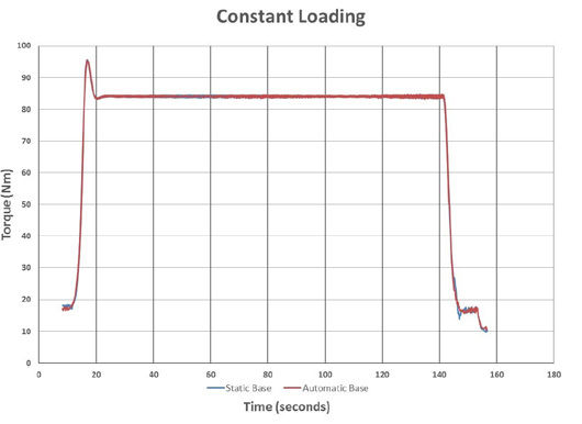

The same motor, belts, and pulleys were used on both bases. Before each test series, belt tension was set to approximately 13 lbs. at a half inch of deflection at center span, the belts were warmed under full load, and tension was reset to a consistent baseline. Each of three load profiles was run four times on each base.

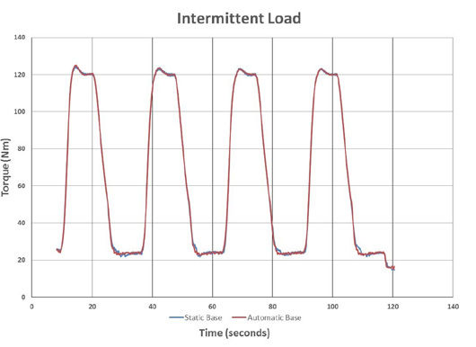

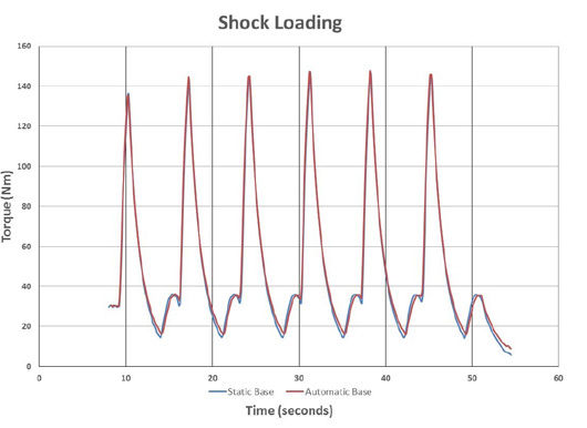

Figure 2—Constant loading (ramped to 70 percent of full load torque, held steady): the automatic base averaged 337.7 Wh versus 341.5 Wh for the static base, a 1.1 percent reduction.Figure 3—Intermittent loading (controlled transitions cycling between 20 percent and 100 percent of full load torque): the automatic base averaged 225.5 Wh versus 228.6 Wh, a 1.4 percent reduction.Figure 4—Shock loading (rapid cycles to approximately 125 percent of full load torque from a 25 percent baseline): the automatic base averaged 69.4 Wh versus 72.3 Wh, a 4.0 percent reduction.
Across all three profiles and all four trials per profile, there was zero overlap between the two data sets; every automatic base measurement was lower than every corresponding static base measurement. The WT-3000’s basic power accuracy of approximately ±0.02 percent of reading places the instrument uncertainty far below the observed differences.
The individual percentages are modest. The pattern across the three profiles is the more significant finding: energy savings increased as load variability increased. Under constant load, where the gap between fixed tension and optimal tension is smallest, the improvement was nominal. Under shock loading, where rapid and severe load swings create the widest mismatch between a single fixed tension setting and actual demand, the improvement was roughly four times larger.
This is consistent with the mechanical principle. On the static base, every load excursion above the fixed tension threshold produces slippage, and every excursion below it produces unnecessary tension. The more frequent and severe those excursions, the more energy is consumed unproductively. The automatic base tracks those changes through the spring mechanism, reducing both conditions.
This test was conducted on one motor size with one belt configuration. The spring-tension mechanism operates on the same physics regardless of scale, but broader testing across additional horsepower ratings and belt types would strengthen the evidence base.
