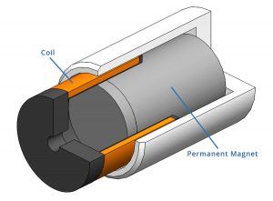

Moving Coil
Voice coil actuators come in a variety of packages. The standard type, which most people are familiar with are moving coil type actuators. These typically involve a coil wound around a bobbin, which can be made from many non-magnetic materials, which moves in and out of a permanent magnetic field assembly consisting of a steel housing with a concentric permanent magnet assembly in the middle. A typical example can be found below:
