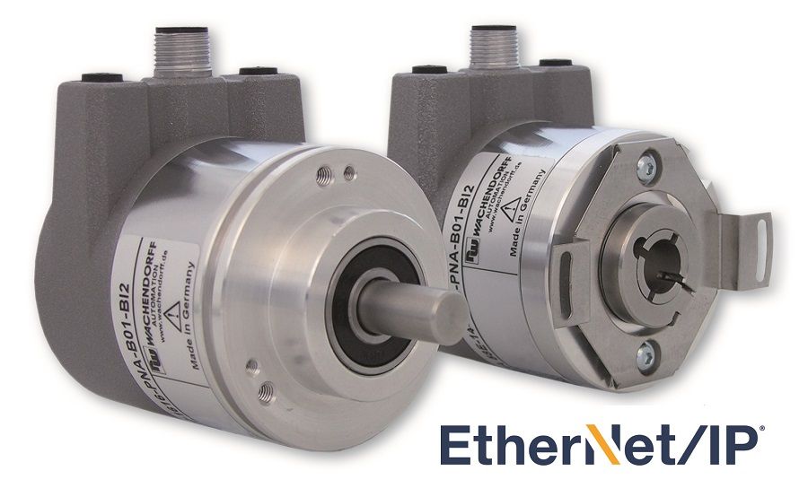

The encoders are certified by the ODVA. The resolution in single and multi-turn can be individually configured via an integrated web server (single-turn 16-bit, multi-turn 43-bit).
The very high environmental data, e.g., temperature range from -40°C up to +85°C, shock 1,000 m/s² or vibration 50 m/s² at 10-2,000 Hz, allow the use in harsh industrial environments as well as in mobile working machines.
The devices with hollow end shafts eliminate the need for additional couplings and the devices with shafts guarantee a long-lasting and stable connection with their very high bearing loads of up to 400 N.
