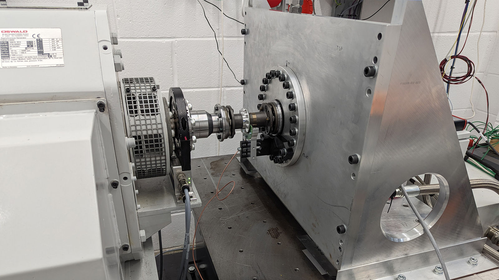

The Improved DTC approach was verified using a DSD dynamometer and test motor featuring a SAW sensor integrated into the mechanical coupling between the two motors. According to Hind, significant challenges around torque ripple feedback required additional measures to avoid this ripple being injected into the control via the closed loop.
DSD’s Open Platform Inverter is utilized to interface to the SAW sensor and demonstrate the newly developed Improved DTC algorithm. Hind shared these developments in his presentation along with results from the verification testing as well as the challenges affecting the practical implementation of this new motor control approach. The presentation provided real insight into the development testing that has taken place by including the challenges faced in achieving a fully functional solution.
“One of the trends we see in motor and drive units today is increasing speeds with increasing pole counts and that allows the motors to be physically smaller. But of course, this can introduce problems for other parts of the system—one of those being the motor controls. When you push those motor speeds faster you are squashing the time you have to do the calculations to control the motor. The algorithm we produced with Transense can be executed really fast, so you can keep pushing the speed up without hitting the ceiling of the calculation time,” Hind said.
They were also able to demonstrate this on a rig using DSD’s in-house facilities. “We're really spoiled here. We have several test rigs where we can evaluate this equipment in real-time,” Hind added.
