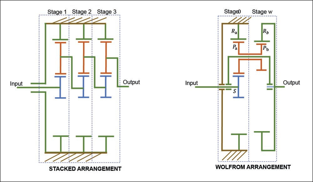

On the other hand, an extremely compact arrangement of planetary gear trains known as the Wolfrom configuration (also called bi-coupled-PGT, differential-PGT or 3K-PGT) is an extremely power-dense transmission system that however comes at the cost of very low efficiency, refer to Figure 1 (right), (Refs. 4, 5, 8, 19, 20). This type of gearbox has the potential to bring a massive transformation in several applications due to its high-torque-density nature. Yet at this juncture, they are restricted to extremely poor efficiency at high reduction ratios due to latent power inherent to this configuration (Refs. 21, 22).
Figure 1—Planetary gear train configurations: (Left) stacked arrangement, (Right) Wolfrom-PGT.
Wolfrom gearbox efficiency is characterized by the gear ratio and the meshing efficiency of involved gear pairs. From (Ref. 4), the Wolfrom gearbox efficiency is given as:
