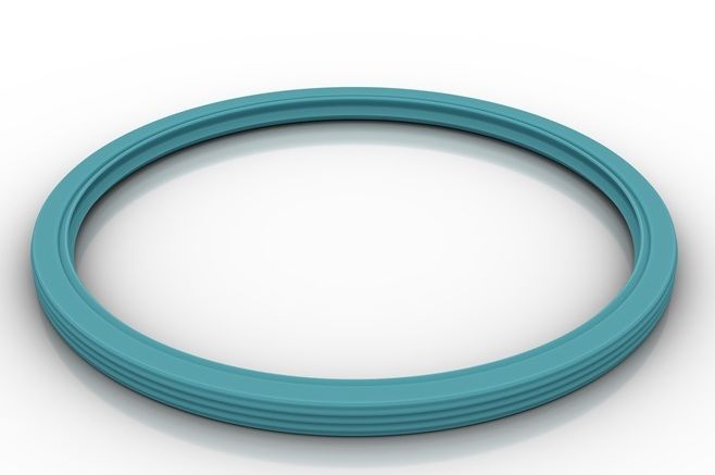

Sealing needs for robots
Robots in industrial applications need to operate with precision to accurately perform within their work envelopes at specific speeds and accelerations. This type of precise movement requires the help of several seals. Mini and nano radial oil seals are found in each of the robots’ joints keeping lubrication in and contaminants out. They also help prevent energy loss caused by friction, breakout force and drag torque. Breakout force is the amount of force required to initiate the movement of a robot’s end-effector or a specific joint from a stationary position. Drag torque refers to the resistive torque that opposes the motion of a robotic joint or actuator.
The extremely small profiles of mini and nano radial oil seals also help manufacturers on the quest for weight reduction. These radial oil seals reduce the amount of metal and therefore weight of the robot. Lighter robots require less energy to operate and contribute to greater energy efficiency.
The operating demands of a robot often exceed the ability of a standard radial shaft seal and radial oil seal and require the use of more advanced solutions. Trelleborg’s PDR class seals use polytetrafluoroethylene for the seal lips which can reduce friction while maintaining similar sealing characteristics to radial shaft seals and radial oil seals.
Since robots typically have very high operating speeds, it is common to move beyond the PDR seal to the Roto Variseal style of product. The Roto Variseal has a single-acting sealing element comprised of a U-shaped ring and metallic energizing finger spring. It offers low friction with no stick-slip—a sudden jerking motion that happens when a robot transitions from static friction (stick) to dynamic friction (slip)—minimized breakout force and high wear resistance. The constrained flange eliminates potential seal rotation and is resistant to most liquids and chemicals.
