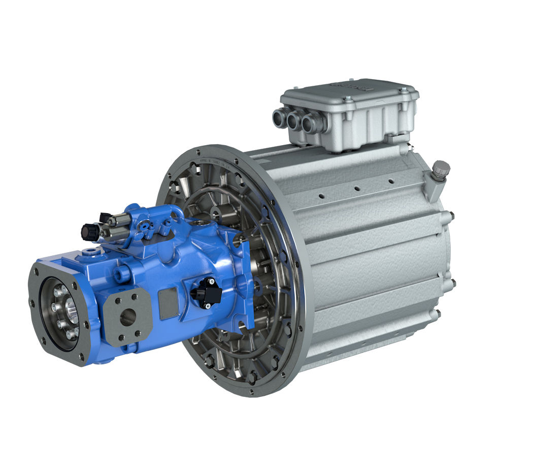

Bosch Rexroth’s eLION platform includes the electric 700 V eLION motor-generators covering a nominal power range from 20 to 200 kW (peak power up to 400 kW) and nominal torques of up to 1050 Nm and maximum torque of up to 2,400 Nm. Additionally, eLION offers inverters in various power classes with up to 300 A continuous current and high overload capacity.

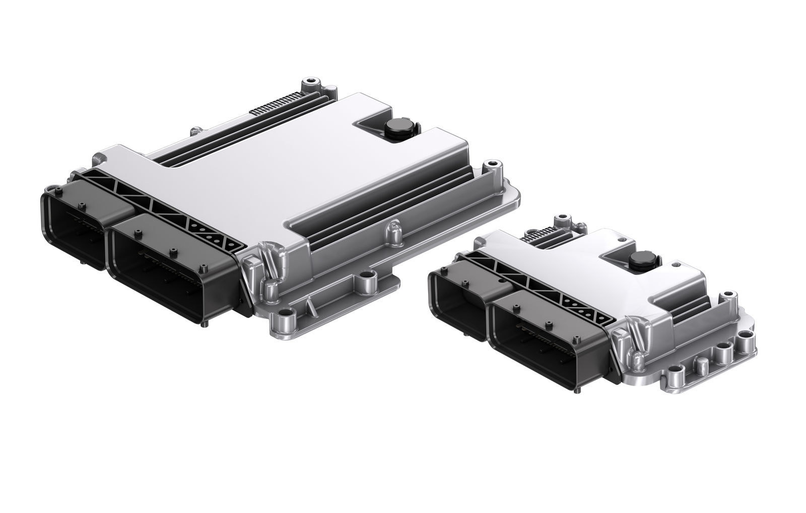

eLION-platform-inverter-copy.jpgBosch Rexroth eLION platform inverters are available in various power classes.

With regards to electronics and IoT, the know-how on the application level and expertise on architecture design and functional safety has been central to software development. BODAS (Bosch Rexroth Digital Application Solutions) software, for example, can examine drive control for wheeled vehicles, travel control for track drives, valve control, control solutions for hydraulic systems and more. This package stands for the company’s entire portfolio of IoT solutions, software and electronic hardware for the off-highway market.

The eLION motor-generators and inverters are highly robust: both comply with the IP6K9K ingress protection requirements and can be used at a temperature range between -40 °C and 85 °C. The maximum temperature for the motor-generators is as high as 100 °C. The shock and vibration resistance of the eLION components is up to 50 g for shock and 10 g for vibration. A particular focus during product development was on functional and electrical safety. Manufacturers and users benefit from inverter safety functions in accordance with industry standards.
eLION-motor-generator_A10.jpgThe eLION motor-generator focuses on functional and electrical safety.
