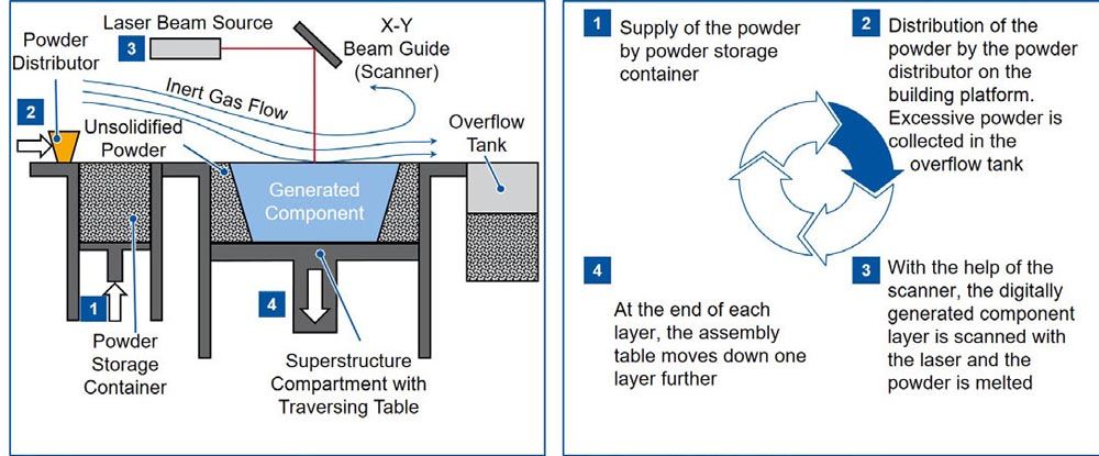

Figure 2—Schematic representation of the LPBF process according to Gebhardt (Ref. 12).
Laser Powder Bed Fusion
LPBF of gears is a single-stage additive manufacturing process (Ref. 7). Both the basic geometric shape and the material properties of the final component are produced in a single operation without the use of shaping tools (Refs. 7, 22). The component is generated layer by layer. The process cycle of the LPBF process is shown schematically in Figure 2.
The construction space of the machine consists of the material powder storage container, the inertized construction chamber with lowerable construction platform and protective gas flow as well as a powder distribution unit. Both the storage chamber and the construction chamber have a movable floor. A scanner is installed above the construction space, which guides the laser beam according to the specified component geometry in x and y direction and at a defined speed on the powder bed. The heat application—the selective fusion (diffusion) of the powder particles to form a compact component—is performed by means of the laser beam source immediately after the layer-by-layer powder application in the construction space. The solidification of the molten bath leads to the creation of a further layer of the component (Ref. 11). Support structures must be built in the same process step in order to fix the component in the construction space and to dissipate the temperature peaks from the component (Ref. 12). The removal of the support structures is not to be considered as a separate process step (Ref. 7). After generating a layer of the component, the construction platform is lowered by one layer and the storage container is raised (Ref. 18). Subsequently, a new powder layer (layer thicknesses typically Ds = 30-50 µm) is applied evenly in the construction space by means of a leveling system and the generation of the next layer takes place again (Ref. 5). The generation cycle is repeated until the physical metallic component is manufactured. The bulk metal powder unused for the construction process is drained after the process, sieved to remove weld spatter and can be reused for the following component generations (Ref. 22). The high process temperatures can cause the formation of cracks and component distortions as well as the unintentional introduction of stresses into the component. Therefore, when generating each layer, the smallest possible areas should be produced in order to prevent thermal stress and the associated local distortion of the component, the curl effect (Ref. 11). Thus, an adapted process design and control is indispensable. During illumination in the construction space, a distinction is made between the areas of the component's outer contour (contour illumination) and the internal volume area (hatch illumination), see Figure 2 3. As an illustration, two photos were taken during the production of gears with the SLM Solutions SLM 280 HL machine, which show the construction of the internal volume area (hatch illumination) and the sharpening of the component contour (contour illumination), Figure 3 right.
