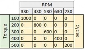

For our first example, we will use a technique which I coin the Torque Ratio method. Just a point for clarity, in my applications, torque is always directly related to the load on the bearing, so any changes I make with the torque will be applied proportionately to the bearing. We start by breaking the duty cycle into bins. We are going to take these bins and assign one torque to represent the entire bin. For instance, the Sample Duty Cycle shown in Figure 2 would represent the 100-500 torque range and 330 – 730 speed range. There could be numerous other bins with the same torque range at higher speeds, and we could have the same speed range with higher torques. This is just one bin which will be represented by one torque, one speed and a calculated number of cycles to represent the same amount of damage.
Figure2
(Figure 2: Sample Duty Cycle)

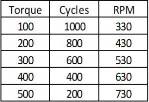

For the first method, let’s say we want to take all 5 steps and combine them into a single-step duty cycle that would have the same amount of calculated damage on the components. (I like to say this out loud to myself to get started.) What (x) do I need to do to my cycles (L10) if I change my load (P2)?

Figure3
(Figure 3: Duty Cycle - Spectra Format)
In plain English, this means that you can set your second torque to whatever you want if you multiply your cycles by:
Equation3

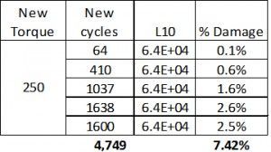

Our original duty cycle with added L10  and % damage is shown in Figure 4. Now we will say we want to evaluate this entire duty cycle at 250 (units are irrelevant if you stay consistent).
Now look at Figure 5 where we took the same duty cycle and replaced the torque with 250. In the New Cycles column, we simply set up the formula to grab the old cycles (1000, 800...200), multiply by:
Equation3
Figure5
(Figure 5: Duty cycle with new torque/cycles)
Or in our specific case:
Equation4
which yields our new cycle count. Finally, the most important step is to check yourself. In this case, % Damage makes for an easy count and we see both duty cycles line up to 2 decimal points of damage.
