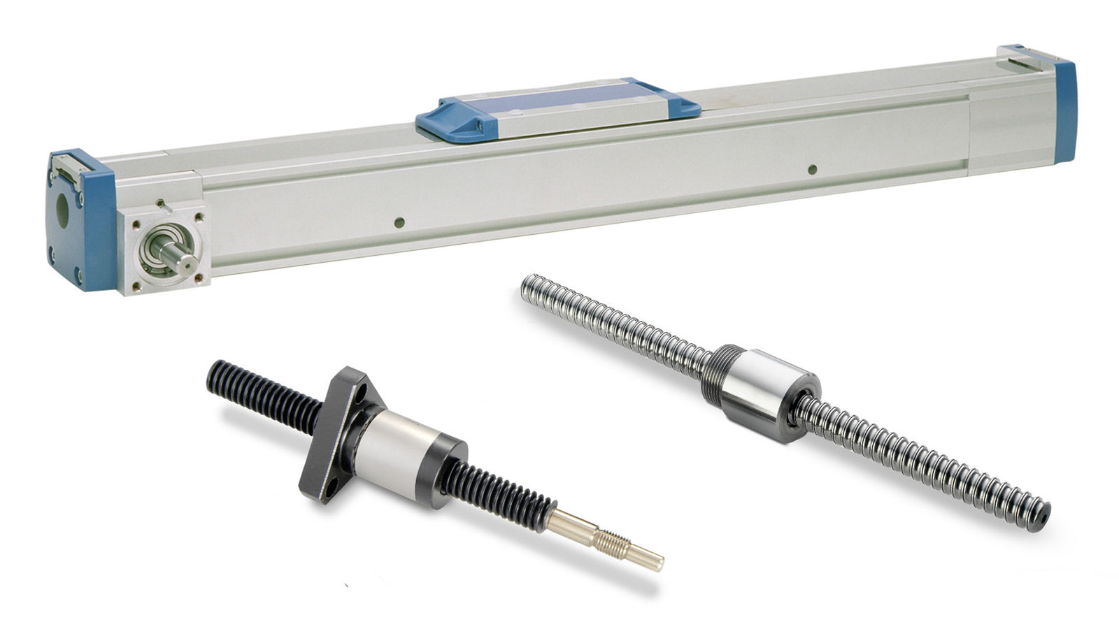

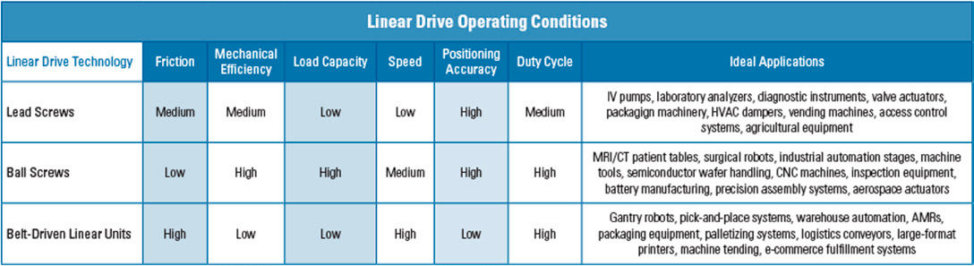

Matching the Drive Technology to the Application
Once the operating requirements are understood, the range of suitable drive technologies has usually narrowed considerably. Rather than comparing every available option, determine which solution offers the best balance of performance, service life and cost for the operating requirements that have been established. Although there is often some overlap between technologies, each has characteristics that naturally suit particular types of applications.
Long-stroke, high-speed applications are a good example. Engineers from a motion control solutions manufacturer recently worked with a customer developing a camera system that needed to travel more than 20 feet at several meters per second. Those requirements immediately changed the drive technology selection process. A screw-driven system of that length would be constrained by critical speed limitations as rotational speed increased, making it more difficult to achieve the required performance. A belt-driven actuator, however, could accommodate both the travel distance and operating speed while maintaining the motion profile the application demanded. Similar considerations apply to gantries, transfer systems and other applications where long travel and high velocity are more important than achieving the highest possible positioning accuracy.
Lead screws suit a different range of operating conditions. Because the nut slides along the screw rather than rolling on recirculating ball bearings, lead screws operate with greater friction and lower mechanical efficiency than a ball screw. This characteristic limits their suitability for higher loads and continuous, high-speed operation, but it can also offer advantages where those demands do not exist. Compact medical equipment, laboratory instruments and desktop automation systems often place greater value on quiet operation, simple construction and reduced maintenance than maximum speed or load capacity. Polymer lead screw nuts can also operate with minimal lubrication, while certain screw and lead combinations can provide self-locking characteristics that help resist backdriving in vertical applications.
Where higher loads, greater positioning accuracy and demanding duty cycles are combined, ball screws frequently become the preferred solution. Their rolling contact delivers high mechanical efficiency, reducing friction and the torque required from the motor while supporting heavier loads and repeatable positioning performance over long operating lives. A vertical manufacturing axis, for example, may require the combination of high load capacity, speed and precision that naturally favors a ball screw. That high efficiency also makes ball screws susceptible to backdriving, however, so vertical applications will typically require an appropriate braking solution to hold the load if power is removed. The final specification is therefore driven by the complete operating requirement rather than the characteristics of the screw alone.
Figure 2—When the operating requirements of an application are considered up front, the linear drive selection process can be greatly simplified. This table details the operating conditions of three popular linear drive technologies: lead screws, ball screws and belt-driven linear units.

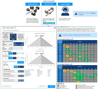

Figure 3—Sizing and selection software such as Thomson Industries’ Linear Motioneering online tool helps engineers determine the optimal drive system using key application parameters.

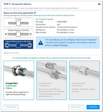

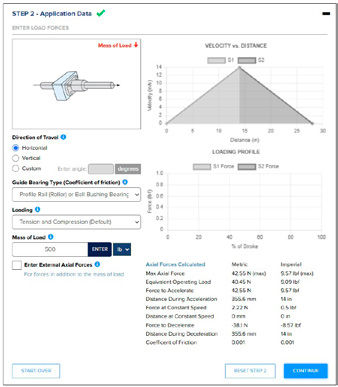

Using Software to Support Selection
Modern sizing software has become an important part of the selection process because it allows engineers to evaluate application data against a wide range of products quickly and consistently. Entering parameters such as load, stroke, travel speed, force direction and applied moments enables the software to eliminate unsuitable options, compare expected service life and identify technically viable solutions far more efficiently than manual calculations alone (Figure 3).
The software, however, is only as effective as the information entered, and it cannot make the engineering decisions on the designer's behalf. Experienced application engineers are still needed to interpret the results, understand the trade-offs between performance, service life, package size and cost, and recognize when a technically acceptable solution may not be the most appropriate one for the machine. The software accelerates and simplifies the selection process; engineering judgment ensures the right decision is made.
