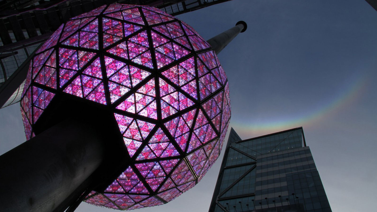

The 2026 Ball featured a refreshed exterior and next-generation LED technology capable of richer colors, smoother animations and more dynamic patterns. These visual upgrades increased the demands on the lifting system, which must manage the Ball’s substantial weight while delivering controlled, steady movement.
