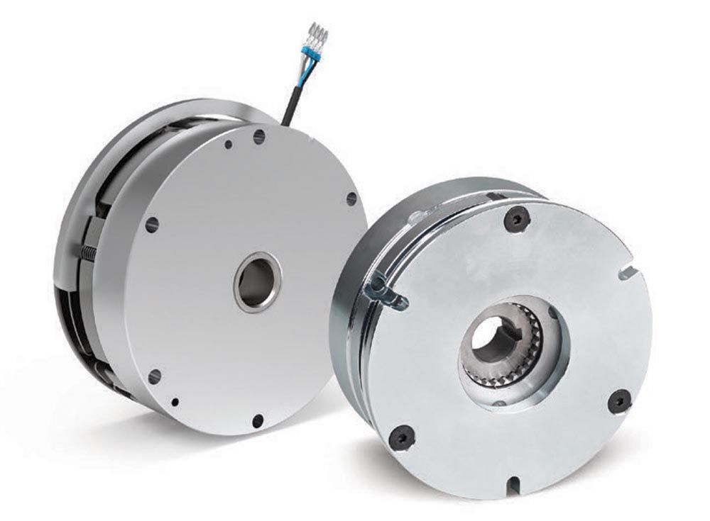

Warner Electric offers innovative braking solutions designed to reduce power consumption on a wide variety of battery-powered construction equipment, including slewing and track drives on excavators, wheel and track motors on compact track loaders, skid steers, wheeled excavators, compact dumpers and mobile elevating work platforms (MEWPs).
Customization of a Warner braking unit includes IP rating, manual release cables, connectors, sensors, and friction material.
Highly experienced Warner Electric application engineers routinely work with Tier 1 drivetrain OEMs as well as major construction equipment manufacturer engineering teams to develop compact, energy efficient braking solutions to meet the needs of each vehicle requirement, whether it’s for a completely new design or the electric conversion of existing equipment.
"A lot of users are struggling with sticking friction material, and we’ve been able to resolve this longstanding problem and combine it with a high coefficient of friction. Many feedback devices in the field to measure wear or to detect the status of the brake are unreliable," said Mourade Vaneeckhoutte, global sales director, Altra Industrial Motion.
The design process typically starts with one of Warner’s existing braking solutions, including the PK and CBTB ranges. Once selected, customization of the unit begins, including IP rating, manual release cables, connectors, sensors, and friction material. The result is a “plug and play” product that the OEM can easily integrate into a drivetrain.
"The plug and play approach is extremely important as makes the integration of our braking solution into the OE machine or the Tier 1 drivetrain much easier, quicker and more efficient, assembly time is being reduced and consequently helps the OEM or Tier 1 to reduce cost," said Vaneeckhoutte.
Warner Electric’s PK (Very Thin) brakes are used for parking and offer emergency stop capabilities. The vehicle’s AC motor is used in combination with the PK brake for regenerative braking of the vehicle.
The benefits of this cost competitive range include one-piece design for easy assembly, lower power consumption, longer battery life, and overall lower maintenance costs. These brakes are enclosed to withstand harsh outdoor environments. IP67-Rated models are available to meet challenging washdown application requirements.
This is, in part, thanks to the high IP rating designs to deal with these conditions as well as extensive prototype testing, according to Vaneeckhoutte.
The recently launched PK–Low Noise Design brake features a unique patent-pending dampening system that significantly reduces operating (engagement) noise to below 70 db. The new brake was developed for applications where high noise levels can be annoying such as under-cab slewing drives on mini excavators.
The CBTB family of electromagnetic axle brakes are specifically for use on battery-powered, dual-drive vehicles with capacities generally up to eight tons (17,900 lbs.). These advanced high-speed, high-torque brakes provide reliable emergency and parking brake functionality and allow for increased maximum vehicle speed and improved productivity.
Proprietary W134 nonstick dry friction material, designed and manufactured in-house, is available on PK and CBTB models for increased high-capacity braking requirements at very high speeds. The linear speed of the friction material determines the speed limit, certain brakes and design sizes have been functionally tested at speeds of 12,000 rpm.
