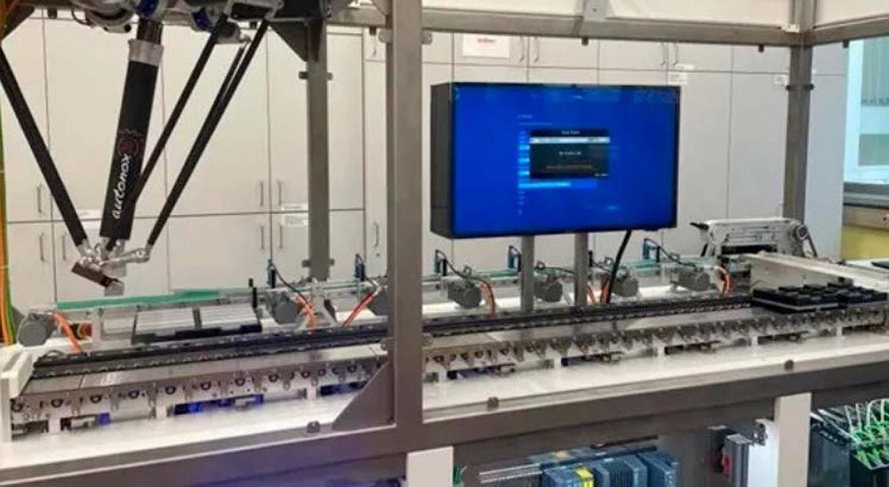

A sneak peek into the factory of the future has a sweet spot—so to speak. Several conveyor belts transport chocolate bars that are part of a demonstrator machine that shows how artificial intelligence can be used for motion control. What remains to be done in a real factory is to automatically pack the chocolate bars. In this Intelligent Infeed Demonstrator machine from Siemens Digital Industries, the chocolate bars must be placed in evenly spaced slots on the outfeed belt.
“The bars are placed on the inlet belt at random intervals,” says Martin Bischoff, expert in virtual mechatronics at technology, the research division at Siemens. “The system controller achieves this by altering the speeds of the conveyor belts. A line of three conveyor belts can be accelerated or slowed down to ensure the chocolate is positioned correctly on the outlet belt. The development of an optimized control algorithm for this application is a tricky programming task—if you don’t believe it: just try it yourself. Via Reinforcement Learning, we have trained an artificial intelligence controller to realize this task.”

Using reinforcement learning, the AI has developed a solution strategy in which all the chocolate bars on the front conveyor belts are transported as quickly as possible and the exact speed is only controlled on the last conveyor belt.
This is interestingly quite different from that of a conventional control system.
The researchers led by Bischoff were able to make their approach even more practical by compressing and compiling the trained control models in such a way that they run cycle-synchronously on the Siemens Simatic controllers in real time.
