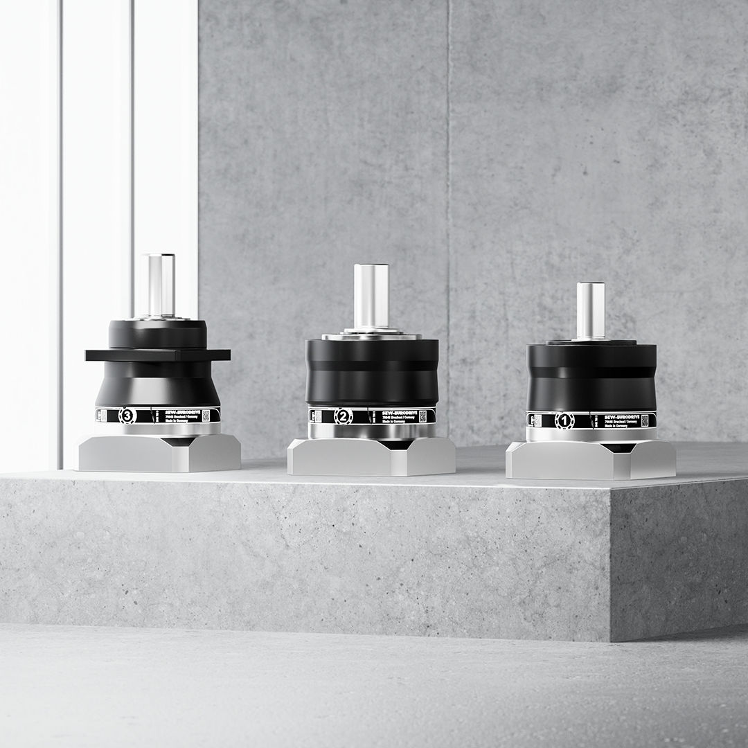

SEW-Eurodrive has expanded its PxG planetary servo gear unit portfolio with the introduction of the PxG economy series, adding three performance classes for machine builders and OEMs seeking cost-effective servo performance for standard industrial automation applications.
The new P1.G, P2.G and P3.G gear units extend the existing PxG family below the P5.G, P6.G and P7.G precision range. The expanded portfolio allows customers to match gear unit performance more closely to application requirements rather than specifying higher levels of precision, torque capacity or load capability than the machine requires.
The PxG  economy series is designed for applications with low to medium technical requirements. Typical uses include packaging equipment, assembly machinery, material handling systems, carton erectors, gantry robots, and machine tool portals.
Each performance class addresses a different level of mechanical demand. P1.G is intended for standard applications with relatively low overhung loads. P2.G provides additional load capacity for applications with increased radial forces. P3.G combines cost-optimized straight gearing with higher-capacity bearings for applications requiring greater mechanical strength while remaining within project budget constraints.
The PxG economy series is available in five sizes with peak torque ratings from 11 to 500 Nm. The gear units are offered in one- and two-stage configurations, provide rotational clearance from 6 to 12 arcminutes, and have a rated service life of more than 20,000 hours.
The modular system includes solid-shaft designs with smooth, keyed or splined output options, depending on the performance class. Food-grade lubrication options and multiple mounting interfaces support use across a range of machine designs. The series is also integrated into SEW-Eurodrive engineering tools, including SEW-Workbench, DriveCAD and DriveConfigurator, to support selection and system design.
