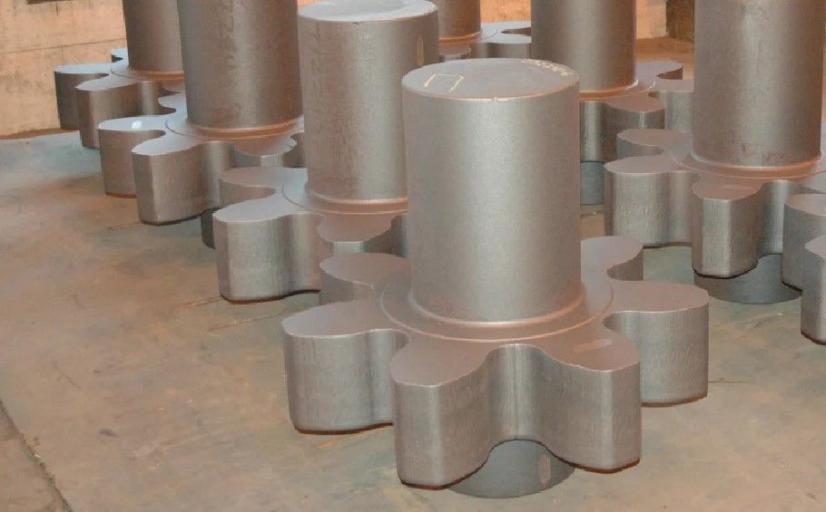

The Role of Forging in DFM and Supply Chain Resilience: Forging is a manufacturing process that involves the shaping of metal using compressive forces. It can play a crucial role in critical component DFM and contributes significantly to creating a robust supply chain. Here's how:
  1. Material Strength and Integrity: Forging enhances the strength and integrity of materials. Components produced through forging exhibit superior mechanical properties, ensuring a longer lifespan and reduced need for replacements.
  2. Reduction in Waste: Forging results in minimal material wastage compared to other manufacturing processes. This aligns with DFM principles of resource efficiency, contributing to sustainability and cost-effectiveness.
  3. Consistency in Production: The forging process produces components with consistent quality. This is essential for maintaining uniformity in the supply chain and reducing the likelihood of defects or variations in the final product.
  4. Effective Use of Resources: Forging is often more energy-efficient than other metal-forming processes. This effectiveness contributes to overall sustainability goals and positively impacts the economic viability of the supply chain.
  5. Near Net Shaping: Advancements in open die forging have led to near-net shaping capability, reducing input material and lowering the cost of machining. When considering the size of large forgings, reducing input material can have significant cost savings.
