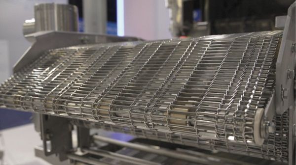

Most notably, the team developed a patented Beaver Tail End design which added the belt path to the next conveyor, replacing outdated sliding mechanisms. This feature allows for smoother product transition, enhancing operational efficiency. Additionally, the introduction of a unique sediment belt in the U.S. market plays a crucial role in maintaining oil quality by removing floating debris like chrome, which reduces oil degradation and maintenance frequency, thereby increasing uptime.

“We developed the Beaver Tail, and were looking for a vendor to help us make that concept become a reality,” Mitchell said. “We had tried many different belts, and we were looking for what lasts the longest, what is the easiest for the customer to repair, what is the fastest to repair.”
With its robust design, the Regal Rexnord PacTitanPro belt significantly extends component lifespan while reducing the frequency of replacements. Engineered to splice together easily with a pin, it minimizes the need for direct handling, enhancing worker safety.

“When we found this PacTitanPro belt, we found that it has a simple pin that slides through, you can hold it with pliers while you slide the pin through, you don’t even have to touch the belt with your hands,” Mitchell said. “So, it’s able to perform under these hot, oily conditions a lot better than any of the other belts we tried.”

MP Equipment tested the new Beaver Tail innovation at an Arkansas poultry processing facility. There, the new integrated system was subjected to rigorous conditions for six months and showed no failures, even under high tension and harsh environments. It lasted 12 times longer than the previous belt solution used at the facility, dramatically reducing maintenance time and costs associated with belt replacement.
