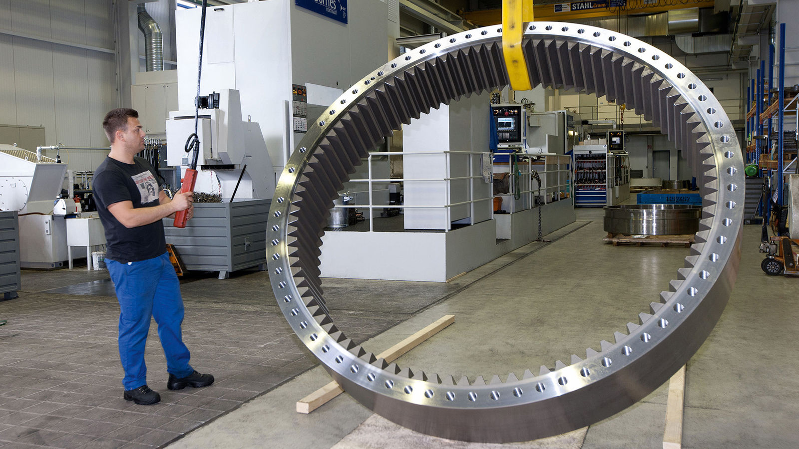

A large internal gear in production at Zahnradfertigung OTT GmbH & Co. KG.
Zahnradfertigung OTT GmbH & Co. KG was the first company to install the new fully automatic CNC-controlled P 152 precision measuring center from Klingelnberg in its ultra-modern machine park.

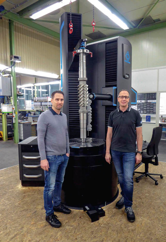

Figure 2—Jens Haag, Managing Director Zahnradfertigung OTT GmbH & Co. KG (left), and Patrick Henes, Head of Quality Assurance, in front of the loaded P 152 precision measuring center.

“Our initial experiences with our new precision measuring center have been very positive. We have been able to significantly reduce measuring times compared to our Höfler EMZ 2602 gear measuring machine, which has now been decommissioned. Various measurements can now be carried out in a single clamping operation, including of course the gear geometry, shape, and position as well as the surface roughness of the tooth flanks,” said Patrick Henes, head of quality assurance at Zahnradfertigung OTT.
Since Zahnradfertigung OTT received the first delivered P 152, there were small suggestions for improvement here and there, which were quickly implemented by Klingelnberg.
“Our wide range of parts in particular means that we have many individual requirements in terms of how gears must be tested and evaluated. Klingelnberg always provided us with reliable and highly professional support to make various adjustments to the software,” Henes said.
