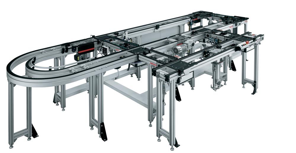

Versatile all-rounder: the modular TS 2plus transfer system performs a wide range of transport tasks with standardized modules. (Copyright: Bosch Rexroth)

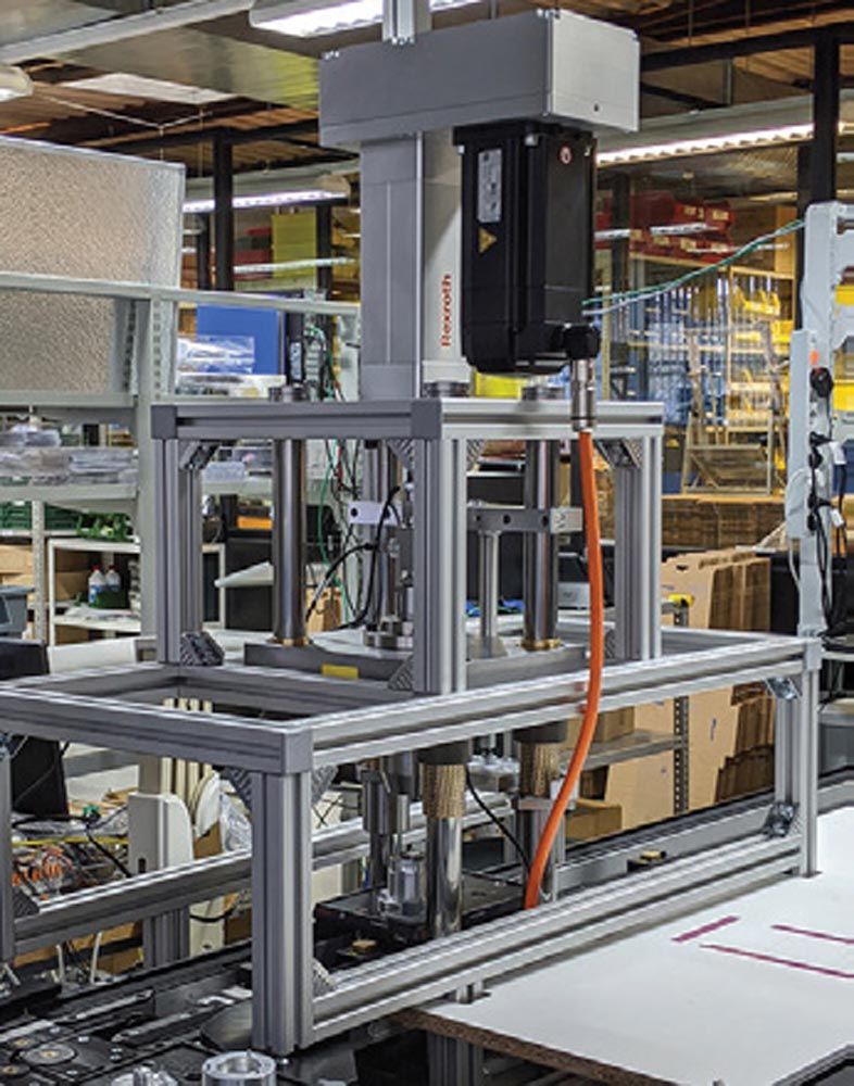

The high quality and precision of each individual hardware component were also reasons why Sensata engineers chose the Smart Function Kit. It’s current task of pressing in the housing flange with the help of three distance bolts, is carried out with a maximum force of 800 daN and +/-0.02 mm accuracy. Although the configuration of the products on the line varies considerably, the solution is 100 percent reliable. In the final stage of the production line, the Smart Function Kit obtains the individual production parameters from a chip on the workpiece pallet via an RFID solution.

To further simplify the engineering of the line, Sensata also opted for a modular transfer system from Bosch Rexroth. The Rexroth TS 2plus system likewise comprises standard components which can be combined flexibly. The line is also controlled by the XM21 embedded control system from Rexroth. Thanks to open interfaces, the Smart Function Kit can even be integrated easily into line control systems from third-party providers if necessary.

Production of different types of rotary encoders at Sensata: the Smart Function Kit for Pressing reduces engineering, commissioning and quality assurance costs. (Copyright: Sensata)
