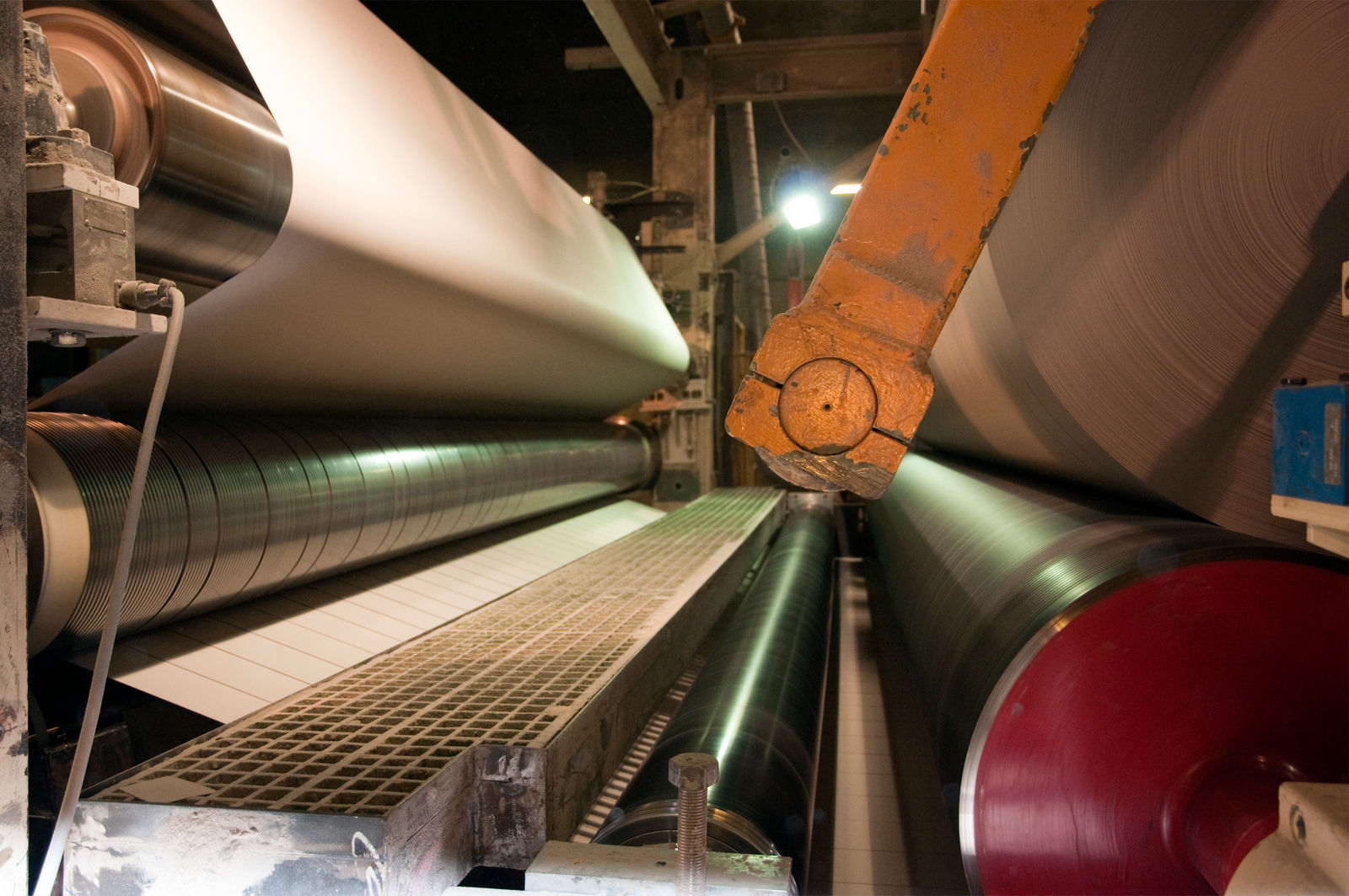

In paper mills throughout the country, gearboxes provide an integral solution for power transmission. Each is selected particularly and directly to perform a specific task in the production of paper. Due to the critical nature of the equipment, all gearboxes are heavily monitored and periodically inspected for preventive maintenance. If necessary, gearboxes can be reconditioned by replacing or repairing components with the intent to rebuild the entire gearbox to OEM specifications.
Papermill.jpgPaper and pulp mill.

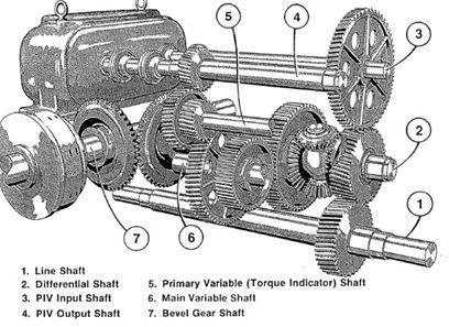

agw1.jpgDifferential Shaft Assembly Illustration. (Beloit Technical Manual)
The Beloit differential consists of seven shaft assemblies. Power is inputted into the gearbox through the line shaft assembly. The line shaft gear drives the outer gear on the differential shaft assembly at a constant speed proportional to the line shaft speed, which is generally 1,000 rpm. The first outer gear, which is a Zerol bevel gear, drives one side of the Zerol bevel spider gears on the differential shaft, as well as the PIV input shaft. The PIV, through a variable speed arrangement, changes the ratios as required and drives the PIV output shaft. The PIV output shaft gear drives the differential second outer gear through the primary and main variable shafts. The second outer gear, which is a combination spur-Zerol bevel gear, drives the outer side of the Zerol bevel spider gears on the differential shaft. The spider gears cause the differential shaft to average the input speeds of the first and second outer gears of the differential. The differential shaft drives the bevel output shaft, which transfers power to the transfer case gearbox.
