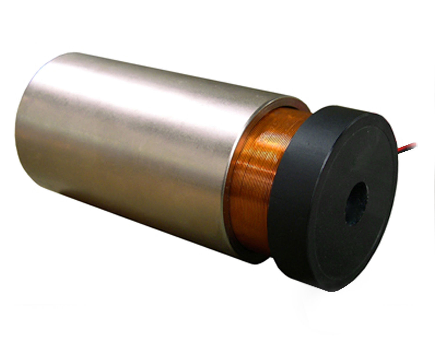

The LVCM-013-019-02 (Imperial version) and the LVCM-013-019-02M (Metric version) linear motors released by Moticont feature high acceleration/deceleration, and low inertia. Two brushless high speed linear servomotors with a 0.75 in (19.1 mm) long stroke, have a high-force-to-size ratio of 2.9 oz (0.81 N) and a peak force of 9.0 oz (2.51 N) at a 10 percent duty cycle. Operated in a closed loop as a DC servomotor, these miniature linear servomotors have high accuracy and high repeatability, and are clean, quiet, reliable, and efficient.
These linear voice coil servomotors are also known as moving coil motors or linear actuators, is 1.156 in (30.2 mm) long at mid-stroke. These high force-to-size linear servomotors are ideal for: Scanners, laser beam steering and filtering, haptic feedback, dynamic vibration absorption, dispensing, work holding and clamping, assembly, testing, and wafer handling.
The LVCM-013-019-02 has 4-40 UNC-2B threaded holes in the center of the housing and the coil end, and the LVCM-013-019-02M has M3X0.5 threaded mounting holes for easy integration of these linear servomotors into new or existing applications. Single or multi-axis Plug-and-Play servo controllers and linear encoders are available for all Moticont linear motors.
