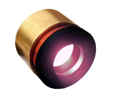

A low inertia hollow core voice coil or moving coil linear motor from Moticont, the HVCM-051-025-019-01, features high acceleration, precise positioning to less than one micron (0.00004 in.), high reliability, and low cost. This cleanroom friendly, non-commutated motor is available off-the-shelf. The HVCM-051-025-019-01 hollow core voice coil linear motor has an open aperture of 0.750 in. (19.05 mm). The hollow core allows for optics, illumination, laser beams, or cables to pass through. With a 0.50 in. (12.7 mm) stroke length, a continuous force rating of 4.8 lbs.  (21.3 N) and a peak force of 15.15 lbs. (67.4 N) at a 10% duty cycle, this compact voice coil motor measuring just 2.000 in. (50.8 mm) dia. X 1.00 in. (25.4 mm) housing length, is ideal for applications such as: Positioning, medical diagnostics and testing, laser beam steering, dynamic vibration absorption, optical focusing, laser cutting & welding, scanning, assembly, and wafer handling.
Two 10-32 UNF-2B x 0.25 in. (6.4 mm) deep threaded mounting holes on 1.000 in. (25.4 mm) centers in the housing and coil makes for flexible and easy integration into new and existing applications. Low inertia, high acceleration, high speed, and zero cogging are benefits of this moving coil or voice coil linear motor. When used in closed loop applications with an optional position sensor, resolutions of less then 1 micron are achievable for millions of cycles. If a longer stroke, higher force, a smaller foot print, or customized mounting is required consult Moticont's team of engineers. All of Moticont's voice coil motors are available as complete plug-and-play systems, including, position sensor, controller, amplifier, power supply, and if required with a linear slide.
