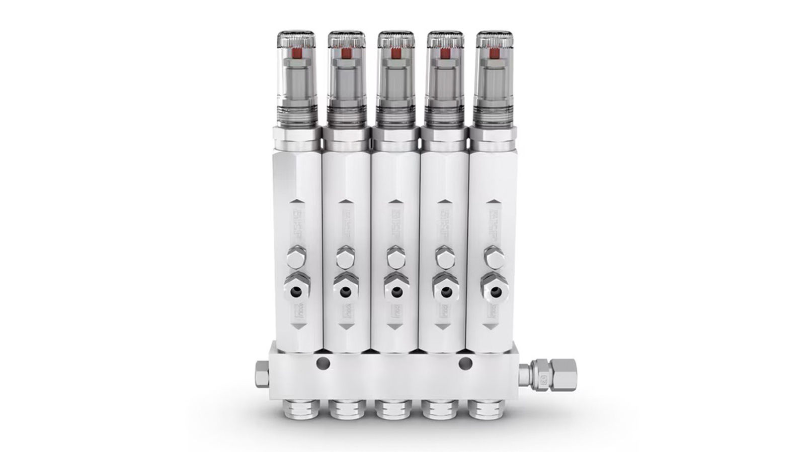

The SKF Lincoln SL-6 metering device is a single-line automatic lubrication system injector. Its proven design is thoroughly updated to meet new demands on maintainability, leakage-protection and long-lasting performance even with harsh extreme pressure greases. Today’s manufacturing environment demands less maintenance time, higher productivity demands and little to no tolerance for unplanned production stops.
The end game with an automatic lubrication system is increased productivity. These systems make sure lubricants constantly flow to bearings, pins and bushings. They lubricate machines while in motion, overcoming loads and allowing grease to protect all wear surfaces. The broad output range makes the SL-6 a suitable replacement for injectors with different outputs and the standard dimensions.
Regardless of the application, the principle of single-line lubrication remains the same: a central pump station that automatically delivers lubricants through a single supply line to the lubricant metering device. Each metering device serves only one lubrication point and may be adjusted to deliver the precise amount of grease or oil required. They can be retrofitted to existing applications.
Systems can service one machine, different zones on one machine or even several separate machines. Applications include machine tools, automation, printing machines, on/off-road vehicles, construction and forestry machines, cement industry, food and beverage, rail, steel and more.

The SL-6 provides increased performance thanks in part to a new slide valve design and heat-treated stainless-steel construction which increases life significantly with mining greases. The simpler measuring chamber design decreases size, weight and failure modes. A patented quick venting feature of the SL-6 (and SLV) ensures large systems vent even during cold weather.
“We’ve made several design improvements over Lincoln’s quick venting injector,” said Bret McCawley, district manager, SKF.
Notably, there’s a 360-degree view high visibility indicator pin that makes it easy and obvious to ensure proper function. There’s also significant weight reduction by replacing two models with the SL-6—cutting service part inventory in half.
One design change enhancing productivity is the ability to monitor the equipment from far away. “Engineers can easily and quickly see injectors functioning from a safe distance depending on the equipment,” McCawley said.
