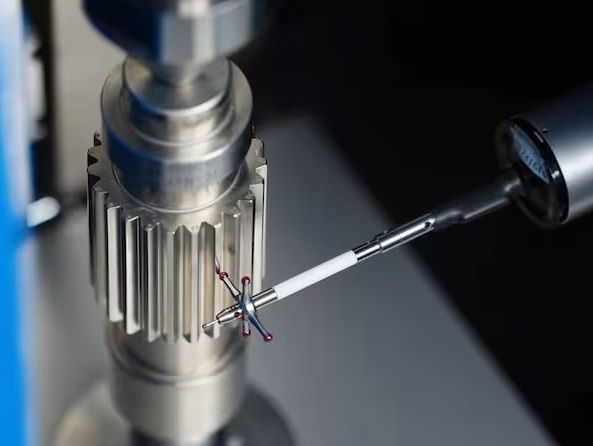

With the optional T3D tactile sensor, the Opticline systems can be expanded into a complete multi-sensor shaft measuring device. This means that all tactile and optical features can be recorded with high precision within a single measuring sequence in just seconds, and cycle times are significantly reduced. With the integrated option for gear measurement, typical gear features for spur and helical gears can now also be measured, which further increases the flexibility of the Opticline measuring system and enables fast process-oriented quality statements. Established functions such as automatic probe arm changes and system checks also increase efficiency directly in the production process.
