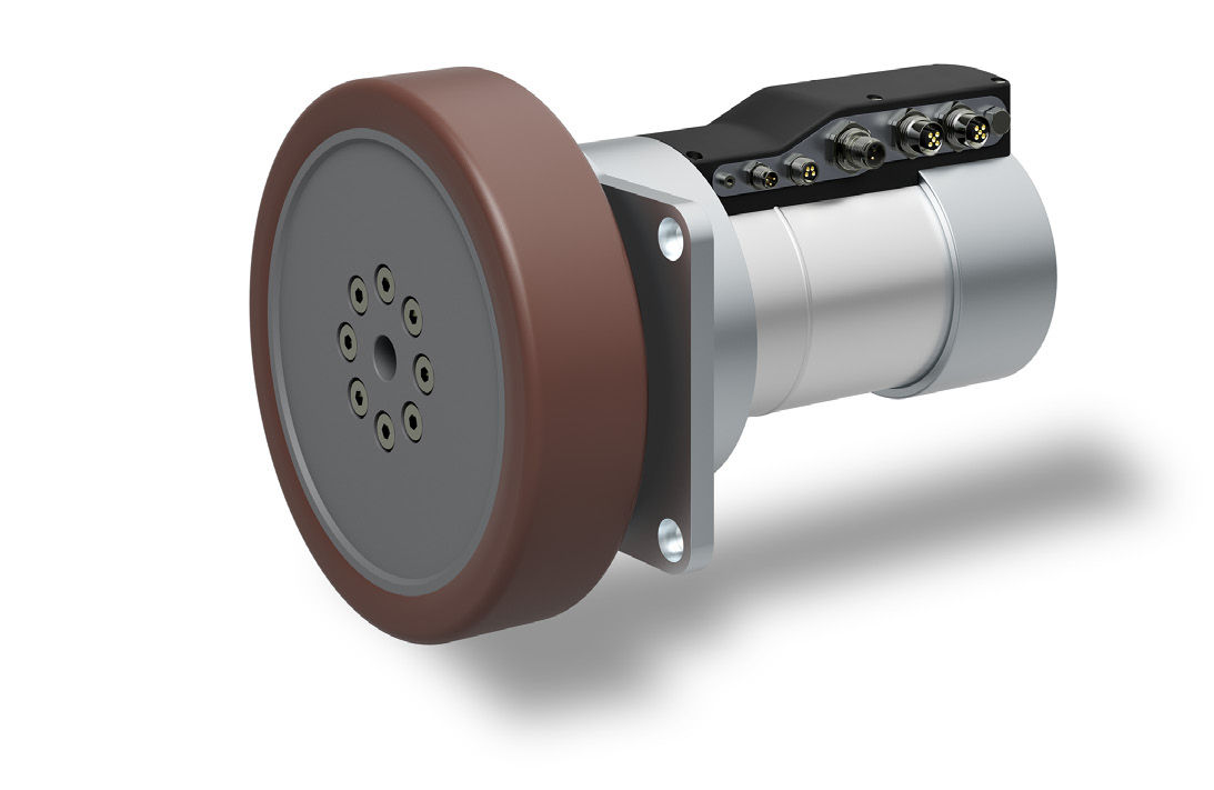

GW: One of Bosch Rexroth’s latest products recently launched that was designed for improving the mobile robotics market is the “ROKIT.” The ROKIT is an “a le carte” mobile robotic solution set allowing a company of any size to design their own mobile robot that tailor fits their business. Whether a business is looking for a simple AGV or an advanced AMR the ROKIT kit gives that flexibility. This solution set is made up of an integrated 6 in 1 motor that combines a wheel, servo drive, motor, gearbox, brake and certified functional safety in one package that is easy to install into an AMR or AGV. This solution set also consist of a navigation software & localization software that can be run on Bosch Rexroth’s ctrlX CORE or packaged in a container to be run on a 3rd party controller or IPC. This solution set also gives the user easy integration with a variety of sensors and lidars giving the user freedom of choice. The ROKIT solution is truly flexible, and a user can choose to implement just the motor and use their own software package or could keep their mobile robot design and implement the navigation and localization software on their own hardware.
