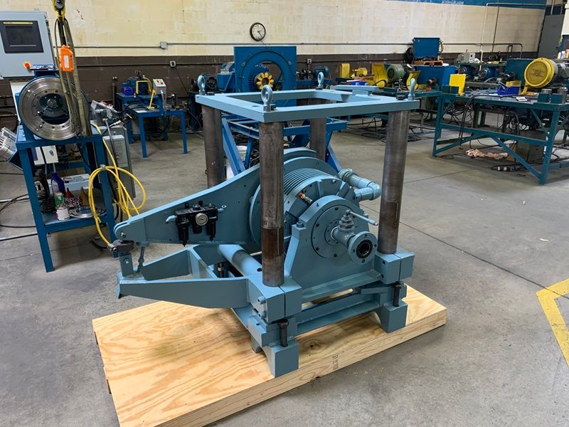

This was the scenario that a service center engineer for a gearbox manufacturer found himself in. He inherited the dynamometer when his facility was shipped equipment for the manufacture and testing of gearboxes. His crew used the dynamometer sporadically on smaller projects, but when they tried to load test a cooling tower gearbox, they halted the test due to severe vibration in the dyno. After a complete rebuild, the old dyno (with its new nickname) was better than new, with capabilities that it did not have during its first half-century of work. Upon its return to service, the dyno easily handled the cooling tower gearbox load test, absorbing the full 250 hp at the beginning and ending of the 1-hour test, and absorbing 180 hp throughout the remainder.

He sent the unit for inspection, and it didn’t take long for the Fairfield, OH team at Force Control to give the brake a new moniker - "dyno-saur." They installed new bearings, seals, drive plates, friction discs, and even added separator springs which will allow the unit to be mounted vertically rather than its normal horizontal orientation.

The rebuild project called for a complete overhaul, replacing virtually all components aside from housings, frame, torque arm, hub and shaft extension.  The brake has 2 brake stacks (tandem stack) where each friction stack has a dynamic brake torque of 3,600 lb. ft. (4,880 Nm) and can absorb up to 225 thermal hp (168 Kw). Separator springs were added to the brake stack to reduce residual drag when oriented vertically.  The dyno was received in Fairfield on March 9 and was shipped back out to the customer on March 26, a turnaround of two and a half weeks.

Those questions were not only key to understanding how the dyno was to be used, but they also led to some modifications that the equipment did not have in its first half-century of service. While the engineer described how the gearbox load testing would occur, FCII engineers realized that a vertical orientation of the dyno would be most effective. So, they modified the unit during the rebuild, adding separator springs between the friction disc and drive plates to reduce residual drag on the brake stack induced by gravity. With the load applied at a right angle, company employees can now easily position the gearboxes to be tested into position, connect the load to the dyno and commence load testing.
