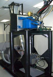

Once the RFQ was approved, PAA officials had essentially four months to design and build a dynamometer test stand, and overhaul three transmissions to get their project verification audit from the Army. Given the short timeframe, the project engineering team opted to use non-regenerative technology. Jerry Leach, director of production engineering and planning led a team of people to begin to design the system, and race against the clock.
“Designing a system to do what we wanted with regenerative technology would have been more efficient, but it would have taken four times longer and cost at least twice as much,” said Leach of his tight timeframe and fixed-cost project. “We contracted out key components of a system we could build in-house and decided to dump power into the system and then load it via braking. This is very effective, but it builds a lot of heat which must be exhausted.”

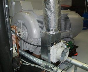

Power is supplied via a General Electric (GE) electric motor and variable frequency drive (VFD) combination with 700 horsepower and 3,600 rotations per minute. The specification calls for testing at 40-60-80-100-and 112 percent of load for various timeframes.

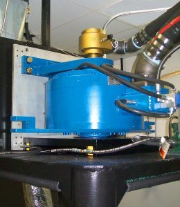

Load is supplied by a TB 83 oil shear brake from Force Control Industries which can be precisely controlled to meet the various spec points.
At 112 percent of load, Leach cited 8,200 foot pounds of torque. The test takes about an hour, Leach said, during which there is very little temperature rise.
“They definitely sized the cooling unit correctly,” he said.
To dissipate the heat generated by that amount of torque, the oil shear brake came equipped with a patented forced lubrication and cooling system. In addition, the heat exchanger circuitry also has components to safeguard against viscosity changes as the oil changes temperature. The cooler the oil, the thicker it gets. To safeguard against overloading the pump, which moves 250 gallons of oil per minute across the brake, heating elements are installed to keep the oil at a fairly consistent temperature. A programmable logic controller (PLC) monitors the temperature and controls the heating elements.
Leach and the team specified components from various sources, the GE motor and VFD, the skid mounted brake and cooling system from Fairfield, Ohio based Force Control Industries, and a 1.7:1 gearbox to reach the 6000 rpm needed. They used LabView software from National Instruments for data acquisition and testing. Once the major components were installed, though, there was still plenty of work to do.
“The plumbing required to move that much fluid, at temperatures which range from 50 to 175 degrees to accommodate the expansion and contraction was challenging,” said Leach.
Additionally, 1,200-amp electrical service had to be run into the facility before everything could be wired and tested. Getting it all in place was the first hurdle, but it wasn’t the last challenge for the project.
While the system was designed for vertical operation the brake was mounted horizontally to allow direct torque measurement. Force Control officials didn’t foresee a problem doing so, but an air pocket was created which caused the friction disc to burn up, since it was not fully wetted. A fast and effective solution was suggested and implemented, allowing PAA to produce overhauls for the initial validation audit.
After passing the validation audit, PAA was off and running. The test stand was performing well, but the brake needed to be rebuilt after every 10-15 transmissions.
Leach, whose company, Professional Aircraft Accessories, was footing the bill, thought that rebuilding the brake so frequently would be a normal course of business until Force Control engineers devised a solution.
“Apparently their engineers were seeing similar issues with another installation and determined a need for additional surface area. We were very pleased to hear that it could be accomplished by changing out internal components,” Leach said.
The alternative, changing external components, would likely change the location of virtually all of the hoses, power connections and positioning of the brake relative to the helicopter transmission. In short, it might mean relocating everything.
Leach reported that once the new components were installed, they haven’t experienced any issues with the system.
